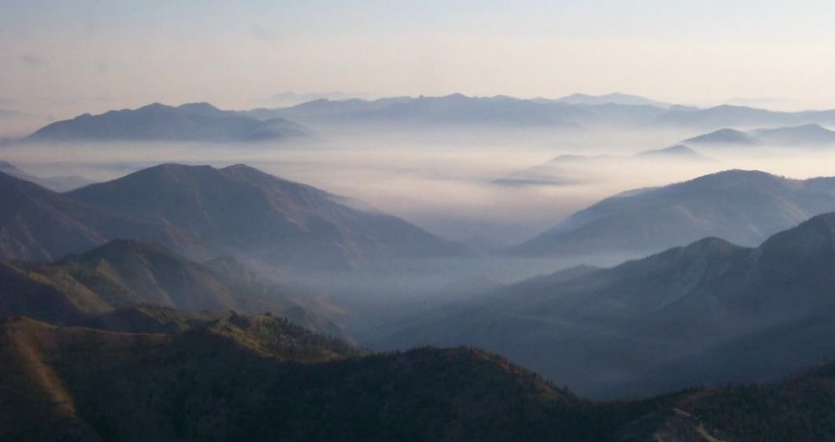

1 Don't Trust What You See from the Ground
"Flying in smoke is extremely dangerous…it may not be what it seems until it's too late…looks can be deceiving. Flying in the smoke you can sometimes see up or down pretty well, you just can't see forward. And the density of the smoke can change in an instant, and with no warning."Barnstormer — Flying in smoke/smokey haze- safe or not?
The ground view is the worst possible vantage point for evaluating smoke, because you tend to look up, and pick out reference points that you can see relatively near. But in the air, you're looking horizontally through miles of it, trying to navigate the necessary distance ahead at aircraft speeds. Before you go, check to see if PIREPs exist for your route: pilots who flew it in the last hour are your most reliable source of actual conditions. PIREPs are a more conventional thing, so they likely won't exist for backcountry destinations. You may have to monitor nearby CTAFs. When in doubt, don't go. Taking off in what is essentially IMC can be a lot easier than approach and landing.
Smoke haze over a backcountry airstrip Flight through the Frank [Church] forward visibility, from the thread: Flying in smoke/smokey haze- safe or not? Photo: whee
