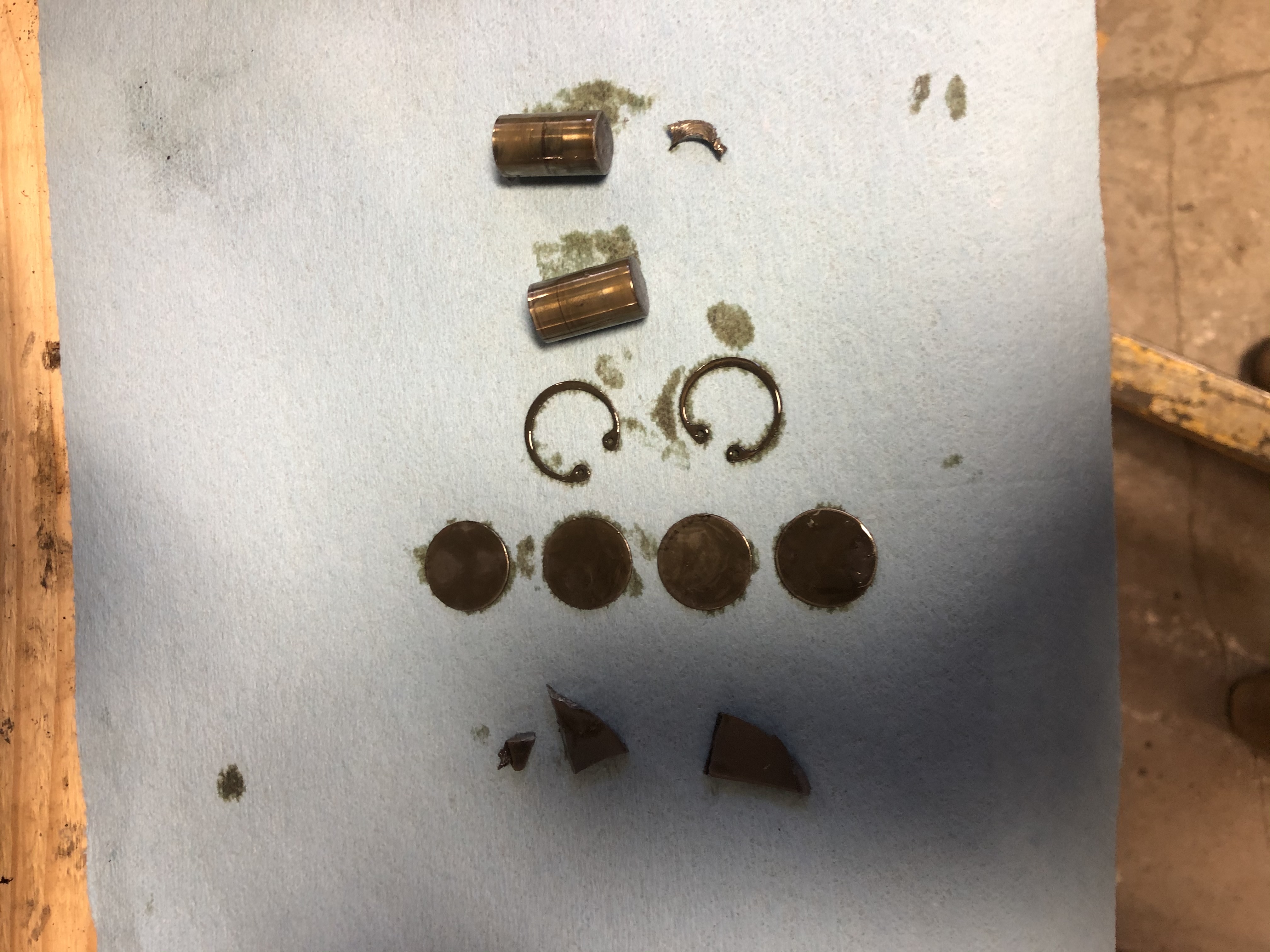

UPDATE: well took me three days to pull the old motor off, and swap a loner motor to get the bird back to down. Everything worked out great. Luckily I have some great friends in aviation that lent hands and flights to get me and the bird back safe and sound. Couldn’t be more proud of the out west aviation community. Just got the broken motor back to town and found the culprit.... drumroll.. a C-clip holding my counter weight pin and come loose and allowed the “aft” pin to come loose.. looks like there was some carnage but only to a cylinder/piston skirt. I guess if it would have been the front pin, could be a different outcome..
Appreciate all the help trying to troubleshoot this guys. And very happy this happened on the ground. Guess the ol girl is looking out for me.
