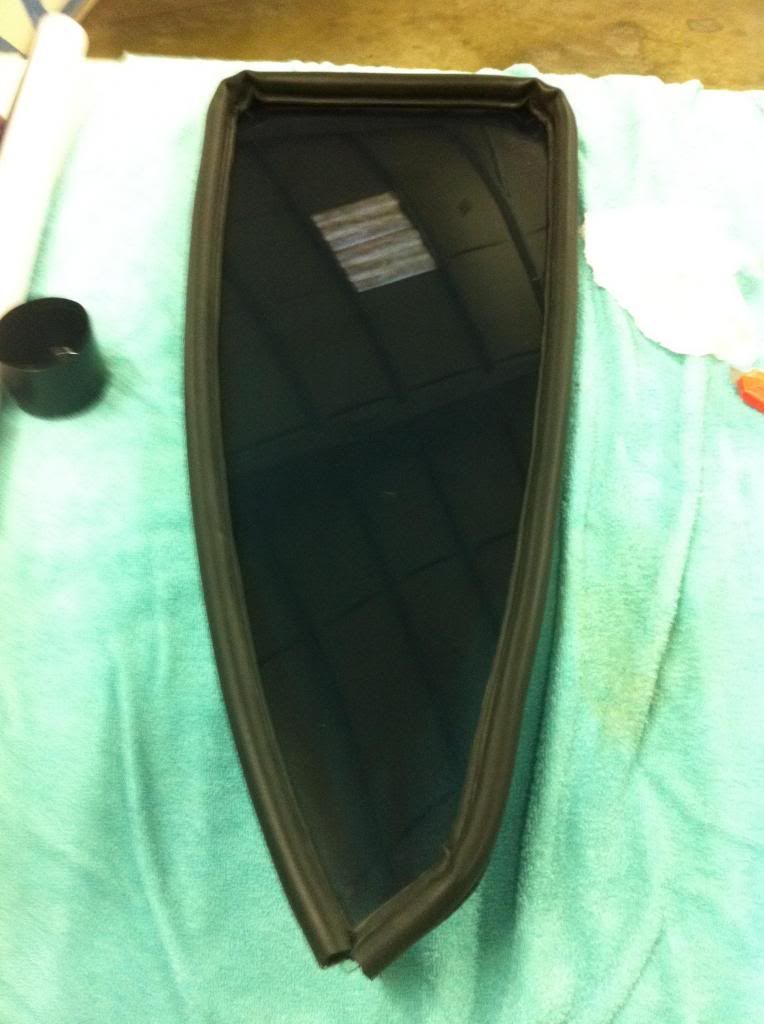

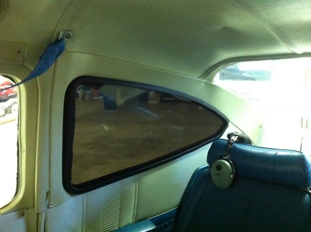

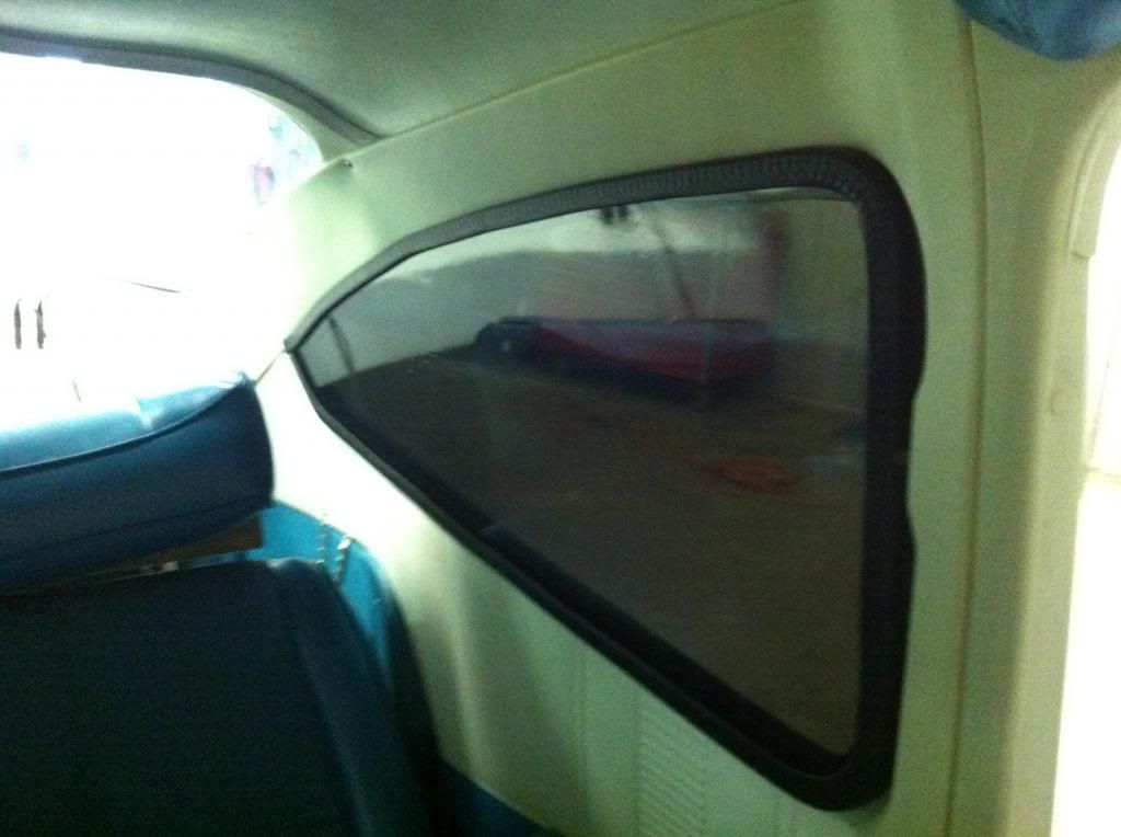

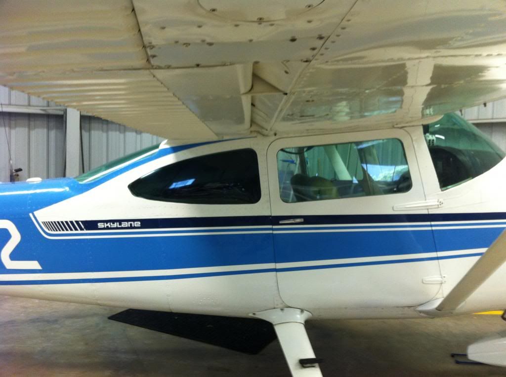

Here are some pictures of my tint project on the 182
Hope you enjoy, it has taken me 8 hours to get the 2 side windows done, i think the rear wraparound window will be a pain in my a**
Mike

The tint sucked...bigtime. It was static cling tint, looked perfect no bubbles came back today, bubbles everywhere. Went to plastic shop had them cut out 10% tinted plastic with good optic clarity and im now done. Same theory, just no window tint.
Mike
