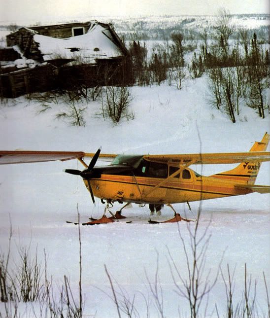

There are 206's on skis and there are 206's on skis.
The single biggest problem with a 206 on retractable skis is that the gross weight is limited significantly, thus the useful load is severely limited. To be legal that is.

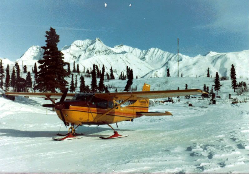

The best skis for the 206 are the Fli Lites, but they are really hard to come by these days. That's what's on Jay Hudson's 206 in the pictures.
The Fluidyne (nee: Wipline) 3600 retractable wheel skis are also approved on the 206, but they are really too small surface area for an airplane the size of a 206. They work, but don't take them into any kind of deep snow, unless you plan to spend the winter.
I've flown one 206 where the owner thought it was a good idea to put the Fluidyne retractables on the mains, and a Schneider penetration ski on the nose gear. That was a REALLY bad idea. The balance of that penetration ski on the nose is totally wrong for a steerable ski, and as soon as you put the nose down in snow, the ski would go right to the steering limit, and you were stuck. I flew it once, and opted not to do any more flights in that airplane with that setup. It was just plain dangerous, and later I rescued a couple guys who were trying it out.
The Fli Lites work pretty well, but this is a big airplane, and if you get it stuck, you are REALLY stuck. Contrary to popular belief, the 206 actually turns around fairly tight, but the key to getting it to turn around on skis is to carry a good bit of weight very far aft to allow you to pick the nose up with nose up elevator.
They work, and work fairly well, IF you can live with the reduced gross weight AND you can afford to always carry a fair amount of weight in the rear baggage.

Where is the bottom photo taken? Alaska Range?
