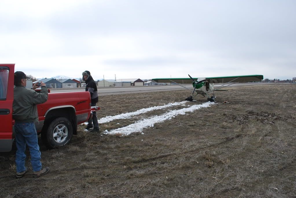

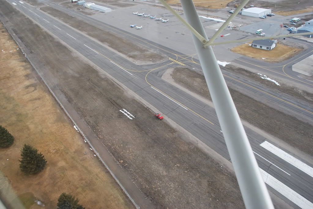

I had one ski motor give it up, at least right now that seems to be the case, it was really slow "going to skis" on the one side when I transitioned from my concrete slab to my snow covered takeoff ramp. I was heading toward Blackfoot about 28 miles away to pick up some parts from Joel Milloway for another project and return some borrowed tools. I was hoping they had enough snow left there (1,000' lower then my place)...no such luck. So it was either turn around or land on the grass. That is what I did, getting a feel for it first, it felt OK so I made a normal slow as possible landing, the 8 or 10 mph wind right down the runway helped. The landing slide can be seen in the grass, about 3 pickup lengths, no pitch down was felt, pretty routine just short!
After concluding my business, I tried a takeoff, didn't even budge, so with a borrowed pickup and a few shovels we transferred some snow from some nearby drifts, and ended up getting sick of shoveling after we had 35' of snowpack. One unforseen complication was the truck left some tracks in the soft dirt, we smoothed them out a bit and called it good. Full power (duhh) and once off the snow I had enough speed to keep accellerating, and the takeoff was uneventfull. A good experience all in all, good for future reference. I was close to home and had plenty of backup resources if needed, and I was able to save having to drive the 40 mile one way trip versus the 28 mile straight shot, plus I got to make a dozen or so landings on the way home. All it took was about 10 minutes of shoveling snow :shock: ImageImage

Hah! That's great. Good thing there was snow to shovel. I'm picturing you running into the FBO, declaring an emergency, and cleaning out their ice machine.

Now Tom, that has to be a FIRST!! Trucking in snow to take off. :shock:
Glad all went well..If I had not seen the picture I wouldn't have believed it.

By the way, I just want to make it clear, the ruts in the grass ahead of the snow patch was left by the pickup, not by me!

COOL!!! Worlds shortest runway! =D>

Good thing you weren't on floats. I wonder how long it would have taken to dig a canal and fill it with water?

That is awesome! I love the photos.

Home sweet Blackfoot! That's rad Tom. I bet you were pumped on takeoff (and landing for that matter). Nice to see Joel and Ellis-mobile doing the grunt work.

I wasn't worried, being right there at the Milloway Skunkworks, I mean where better to have problems in a S-7?! He has enough parts to take care of any problem! I think they were more concerned then I, it probably looked worse then it felt! Sort of like a dragging brake was about all, both landing and the takeoff. Now, trying it with one ski down and one up would have been really going into the unknown, this just didn't feel bad at all, remember I didn't have to land, just wanted to save the drive, and when the initial touchdown felt OK, I just continued.

Crap Tom, maybe the Valdeez officials will let you put some snow down for take off - 35' is competitive. And I am sure those skis will stop you real quick on the landing...off the snow. :shock:
