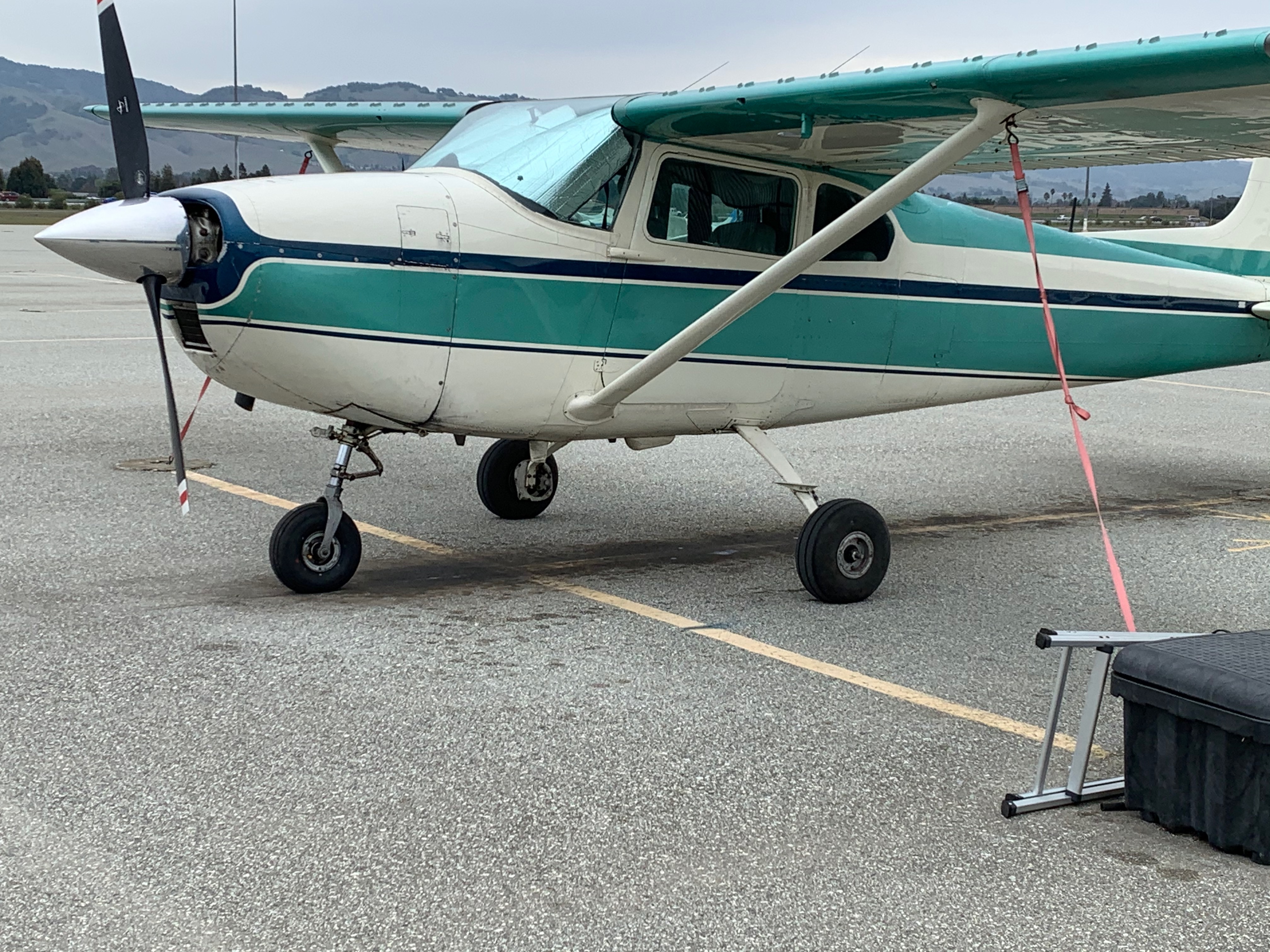

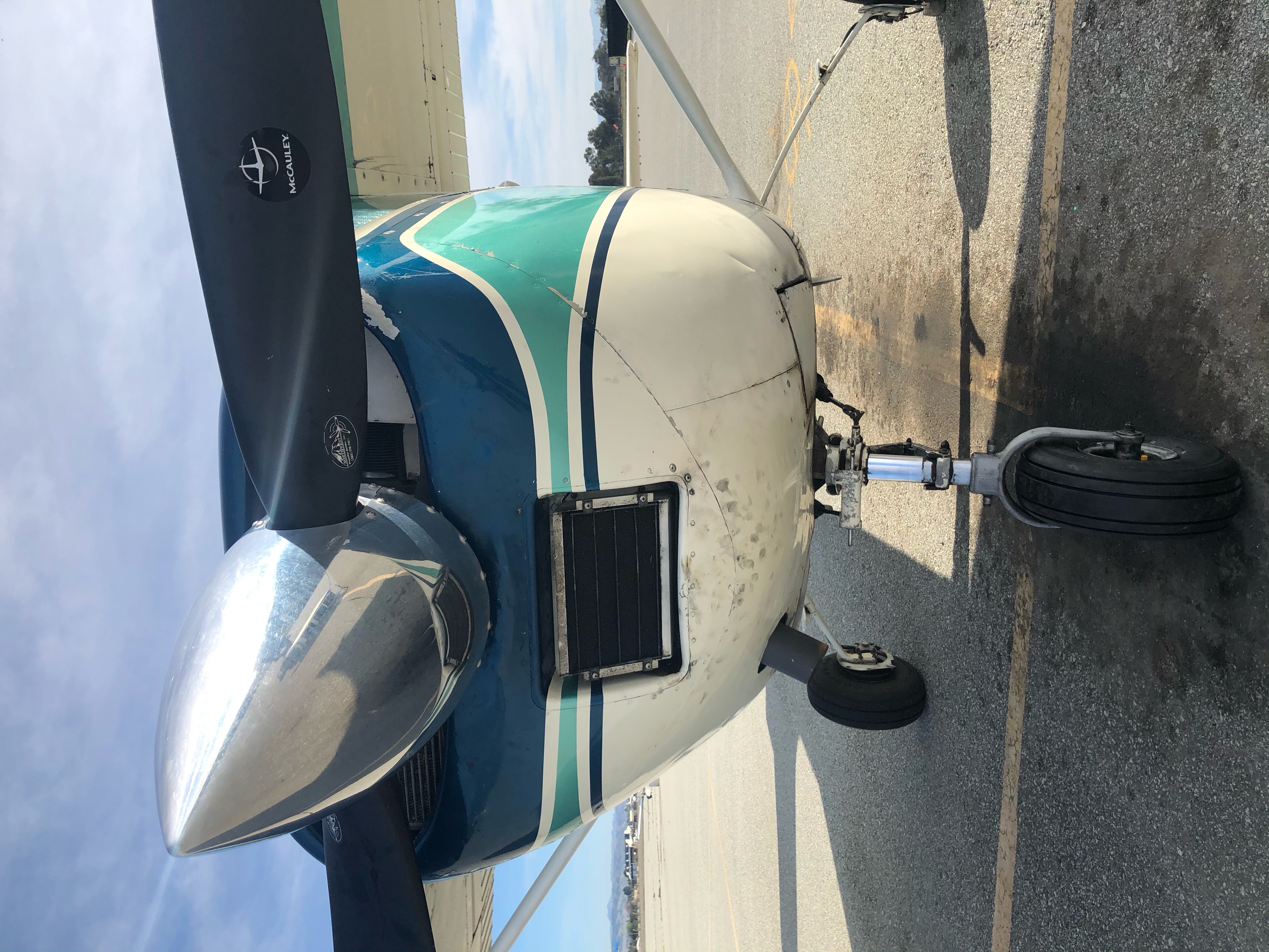

Chuluwest wrote:Alternate view. May need to increase mains size to make it gravel worthy.
How do you do that? Lol Well and make it through your next annual.. Your strut is also a little overcharged...
Seriously though, my 182B had 6x6's all the way around with a 310 fork. Someone turned a blind eye, as a HD fork is not an option on a B model due to the scissors attach above the fork on the tube. To properly put a HD fork on a B you need to cut the tube, attach scissors to fork (same process as an airglas) and get a field approval. Which is hard to get as an STC is available. (Airglas) I know this stuff works, it's cheap, but it ain't legal....Your mileage may vary.....
