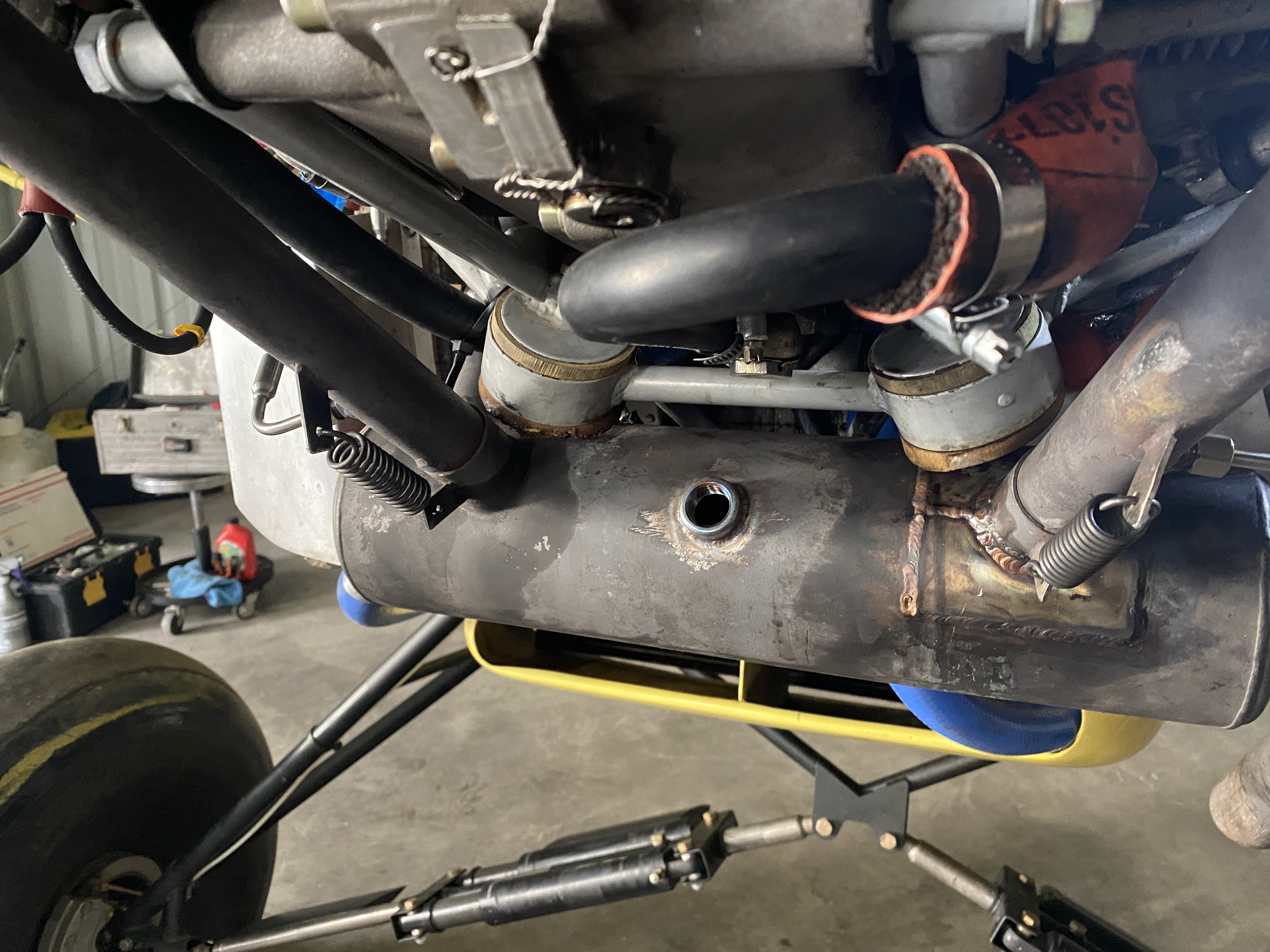

That said, yesterday was an eventful day. Pulled the exhaust and welded in an o2 sensor bung so that I could monitor air/fuel ratios as the plane idled and warmed up. After installing her second set of new needles (I’ll try to post pics of the old ones under a microscope) as well as new float needle armatures (dunno the actual name) the carbs went back together for what I hope to be the final time. Hopped in the plane, sparked her up, and low and behold were idling at 1700 rpm, no shake at all, and no more surging. The float arms are currently set at 12 mm from the base of the carb (stock setting is 10.5mm but that pours fuel like a champion). Today I’m hoping to get this starter solenoid replaced then fingers crossed she gets a final button up.

In other news, Bane (kitfox has earned that name) started up yesterday and idled with minimal fluctuation. Air/fuel readings were between 12.8 and 14.1 and I’ll be working to tune those last surges out today. But it went from +/- 400 rpm swings to about 80 rpm. The needles that were pulled from the carbs and placed under a scope showed hairline cracks in the needle tips. I’ll try to get an image through the scope lens and post it but previous attempts to this proved futile. Now the last fight is the mid range is reading at a ratio of about 22.1:1 which is NOT GOOD - this has me thinking the needle jet is likely misadjusted or dirty. Fingers crossed today is it!
