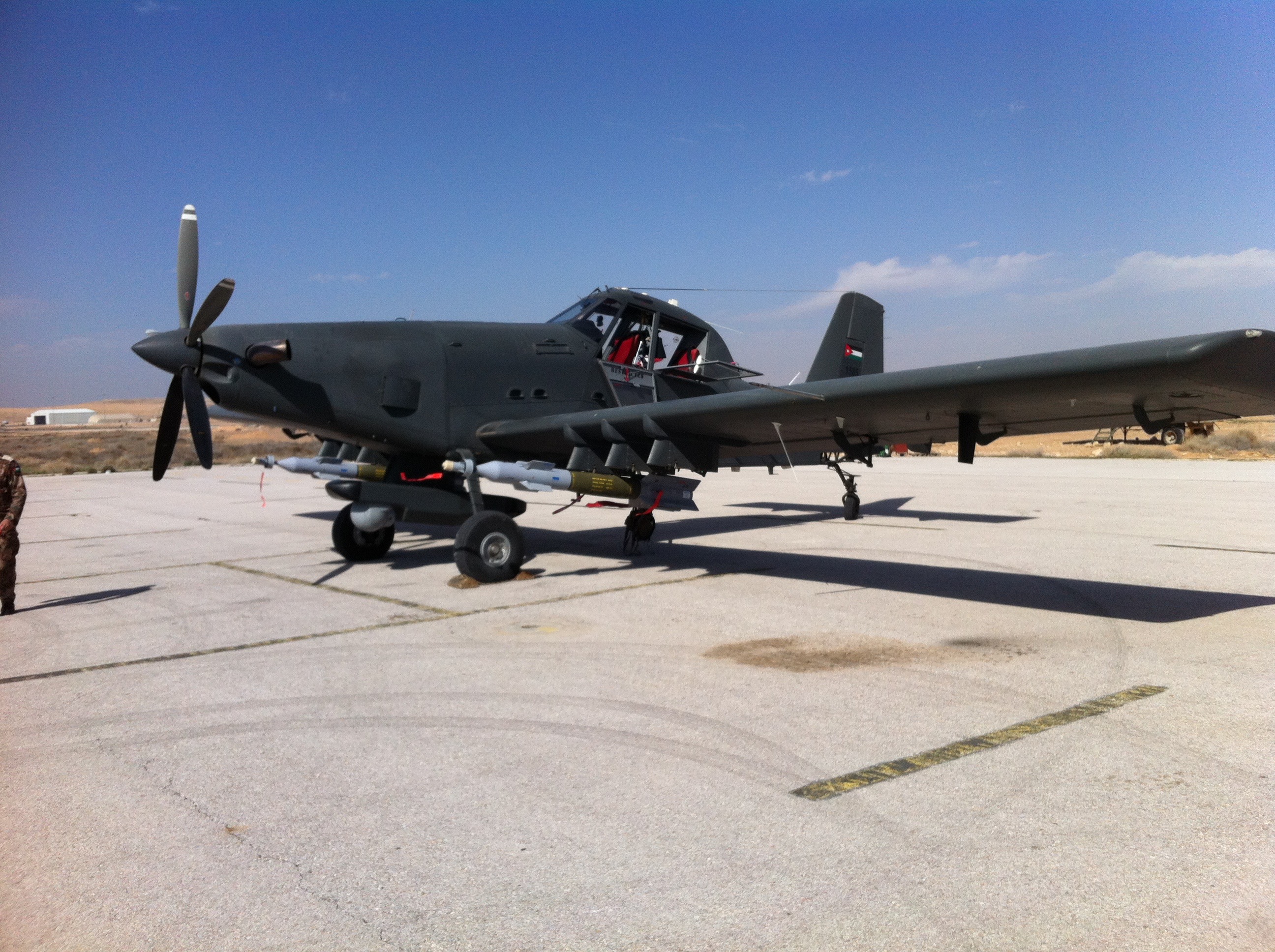

Re: AG aircraft high altitude performance
It looks like that bird is well equipped for pest control.
