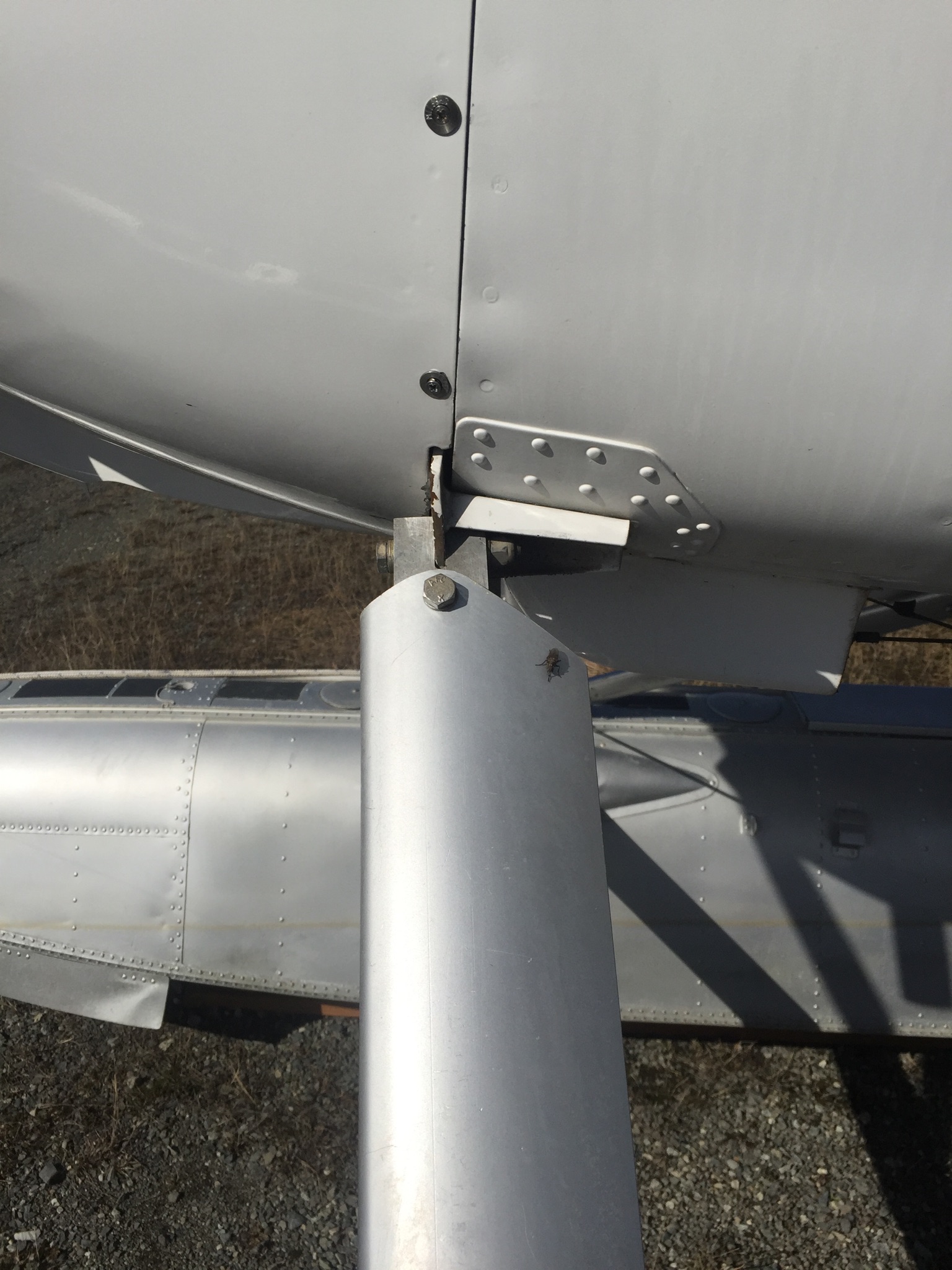

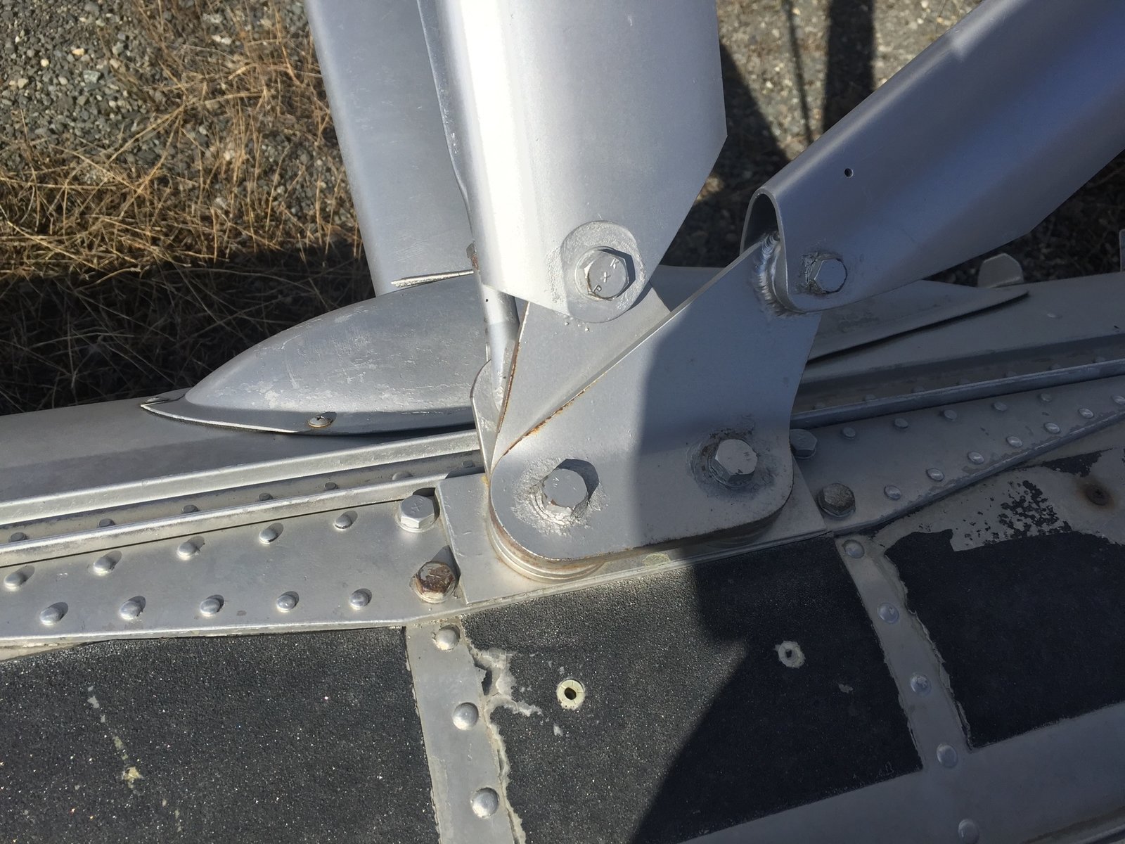

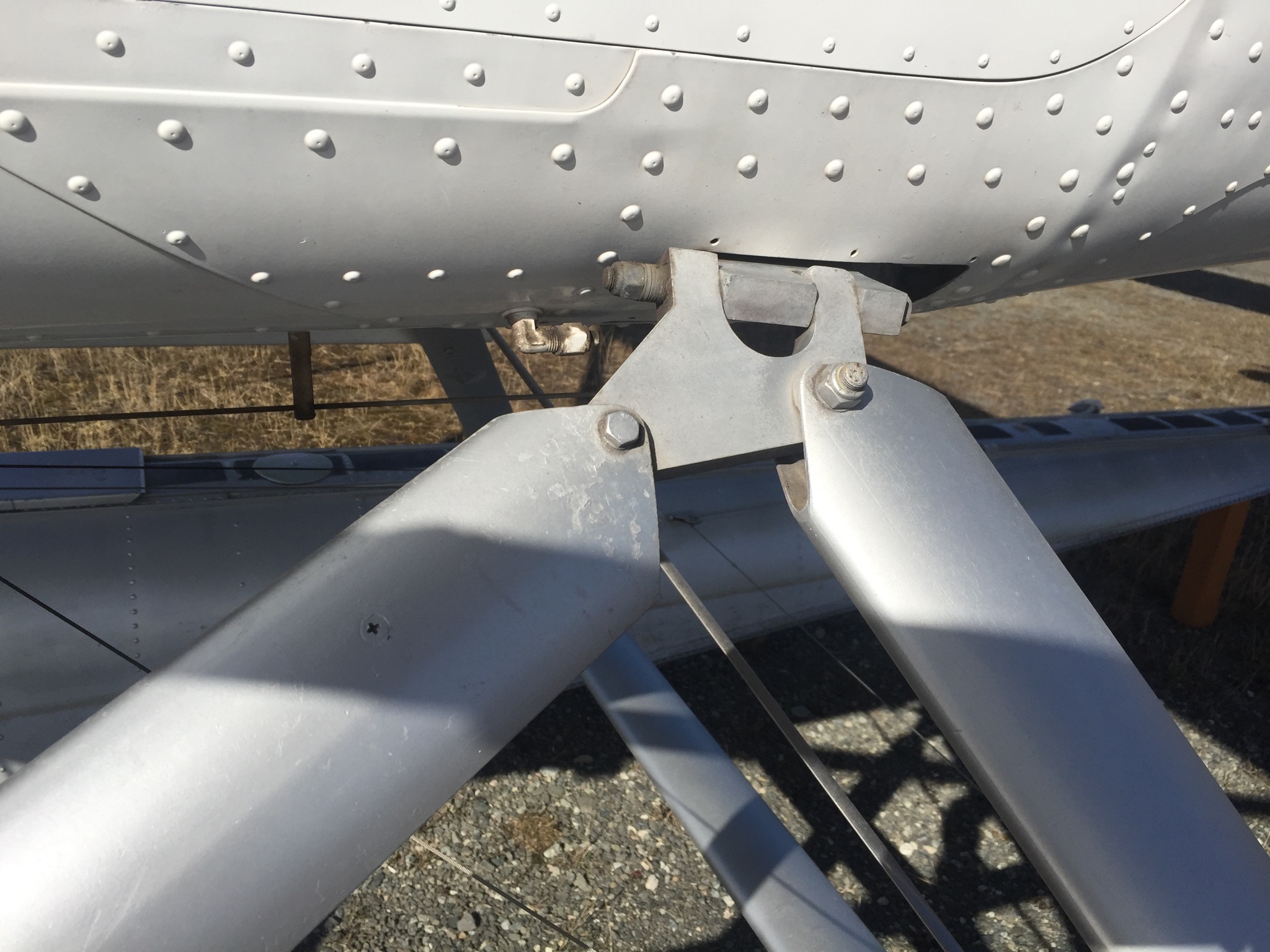

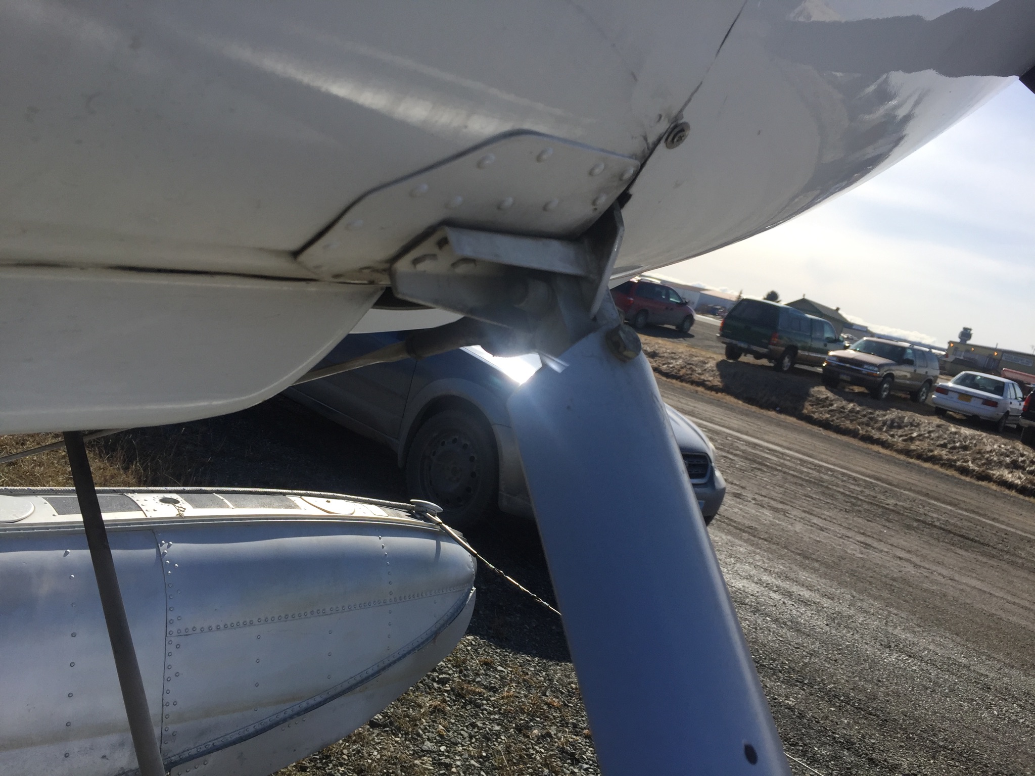

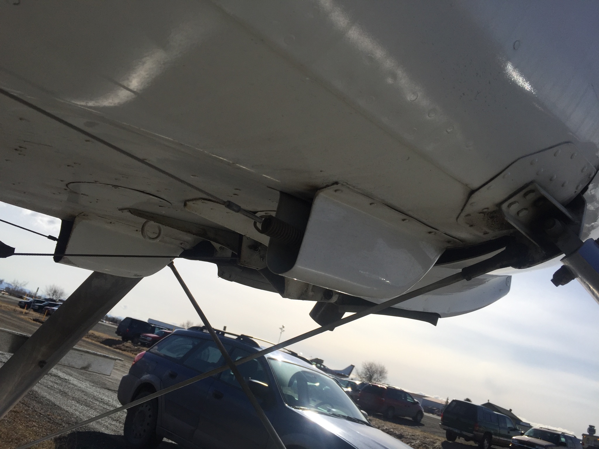

Here are some photos of an ACS kit for whatever.
