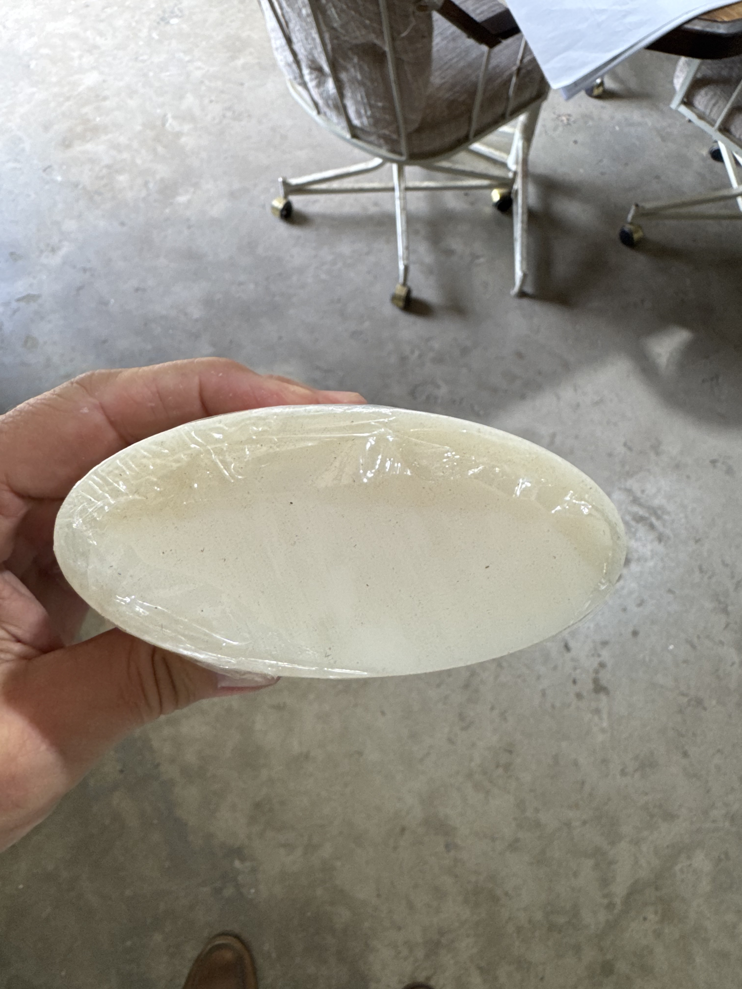

This appears to be the new solution available soon. Gotta be better than wood. Mine look a lot like yours - including the deck bolts.
