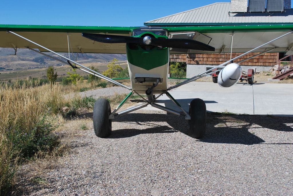

As to why I asked, I'll post in a couple days a more lengthy explanation, along with how come, why for, and what it's all about:shock: But here's a picture to give some idea of the subject matter.
Re: assymetric drag
I doubt you'll even notice that load, unless it's heavy, in which case it'll induce roll, not yaw.
I've flown a lot of stuff a lot dirtier than that out there on the cabanas without any issues.
