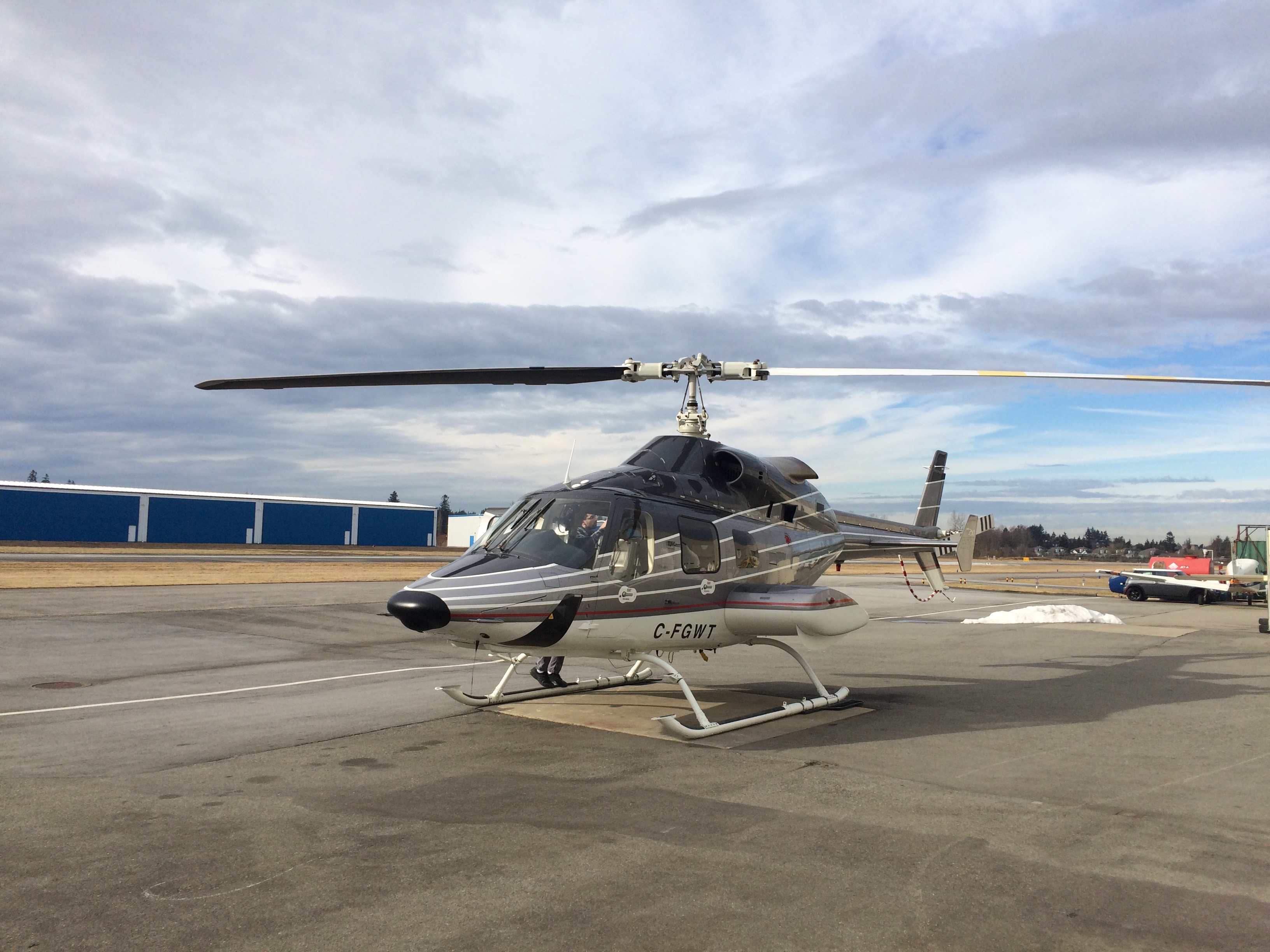

Try Dart Aerospace, though we usually go through HeliTowCart (out of stock right now). We use them quite a bit, though we take them off for training - slide on autos don't like them. Still lots to go wrong, even with bearpaws. Snow can be soft or hard or crusty. If you break through the crust you can snag a bearpaw with a little yaw. That said, I don't like landing on snow without them. Swamps can sometimes sink in slow, best not to leave it there too long.
We had an ECA do a beach landing and park near a rivulet. An hour later it had sunk up to the axles and they bent the wing struts pulling it out.
Even the Bell 230 I flew last week had them.
