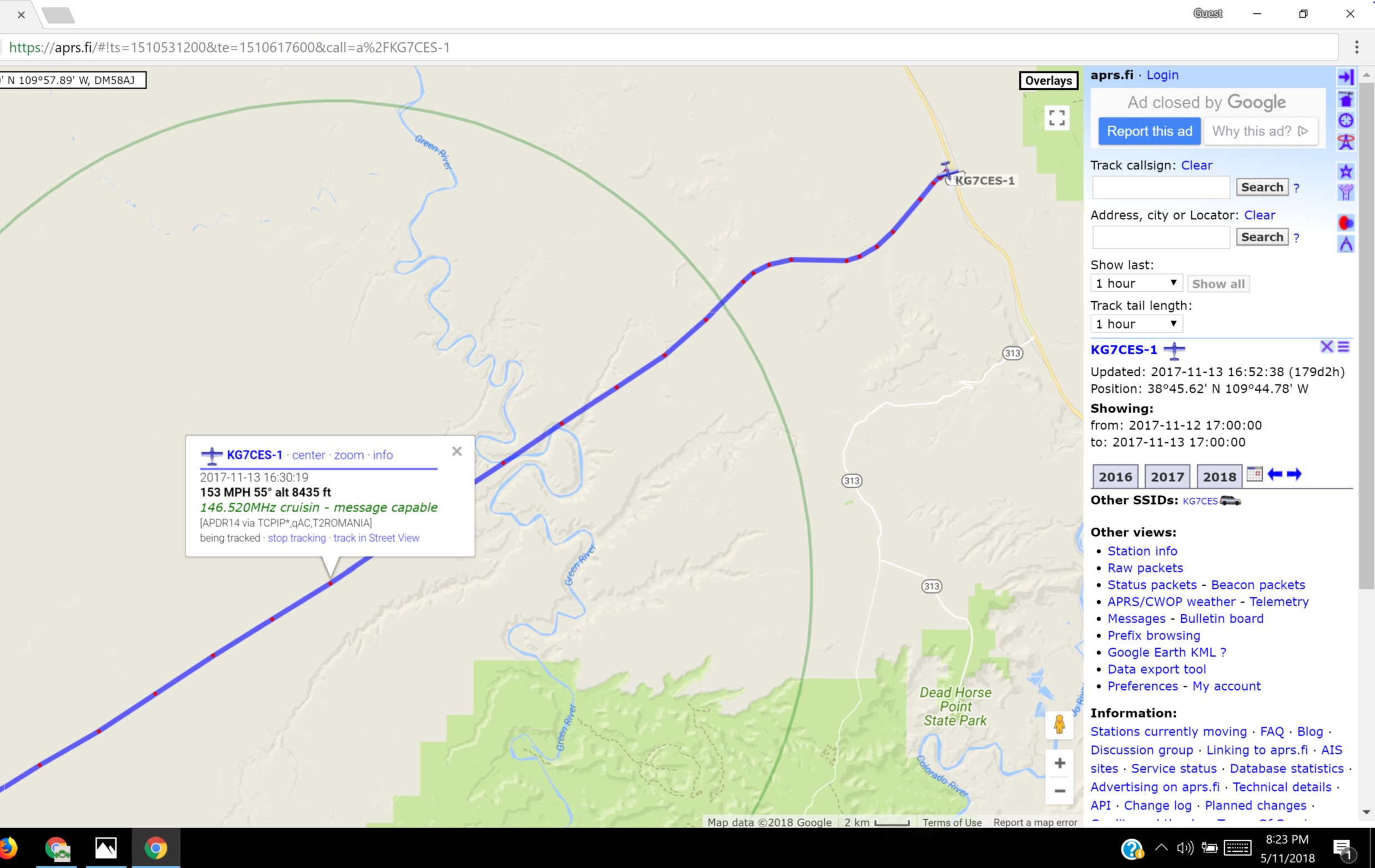

Get your HAM license. APRS works well for me I use it both flying and in my vehicles. Super easy for family to track you. Its just a link you email or text with the website and your call sign and it pops right up. Can be done either over the 2m radio waves, or by cell coverage. It would not work when you cant get either of these though.
