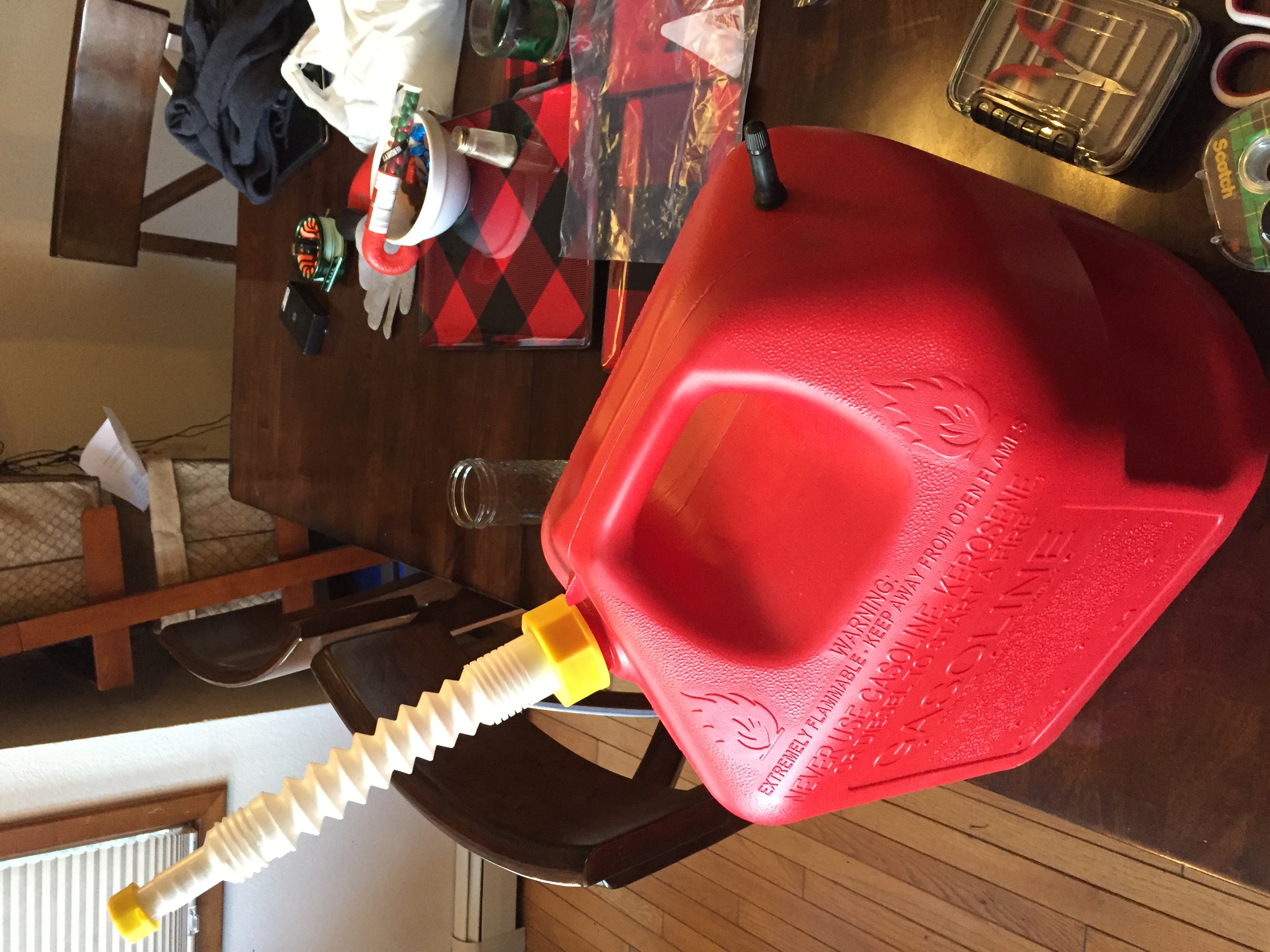

Midwest Can Co 5-gal can. Throw away the crappy spout and order an “Easy Pour” spout from Amazon. Drill a 1/2” hole and pull an automotive valve stem through for a vent. Take the Shrader out and it makes a good vent.
