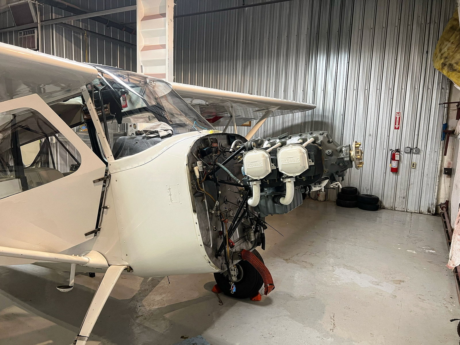

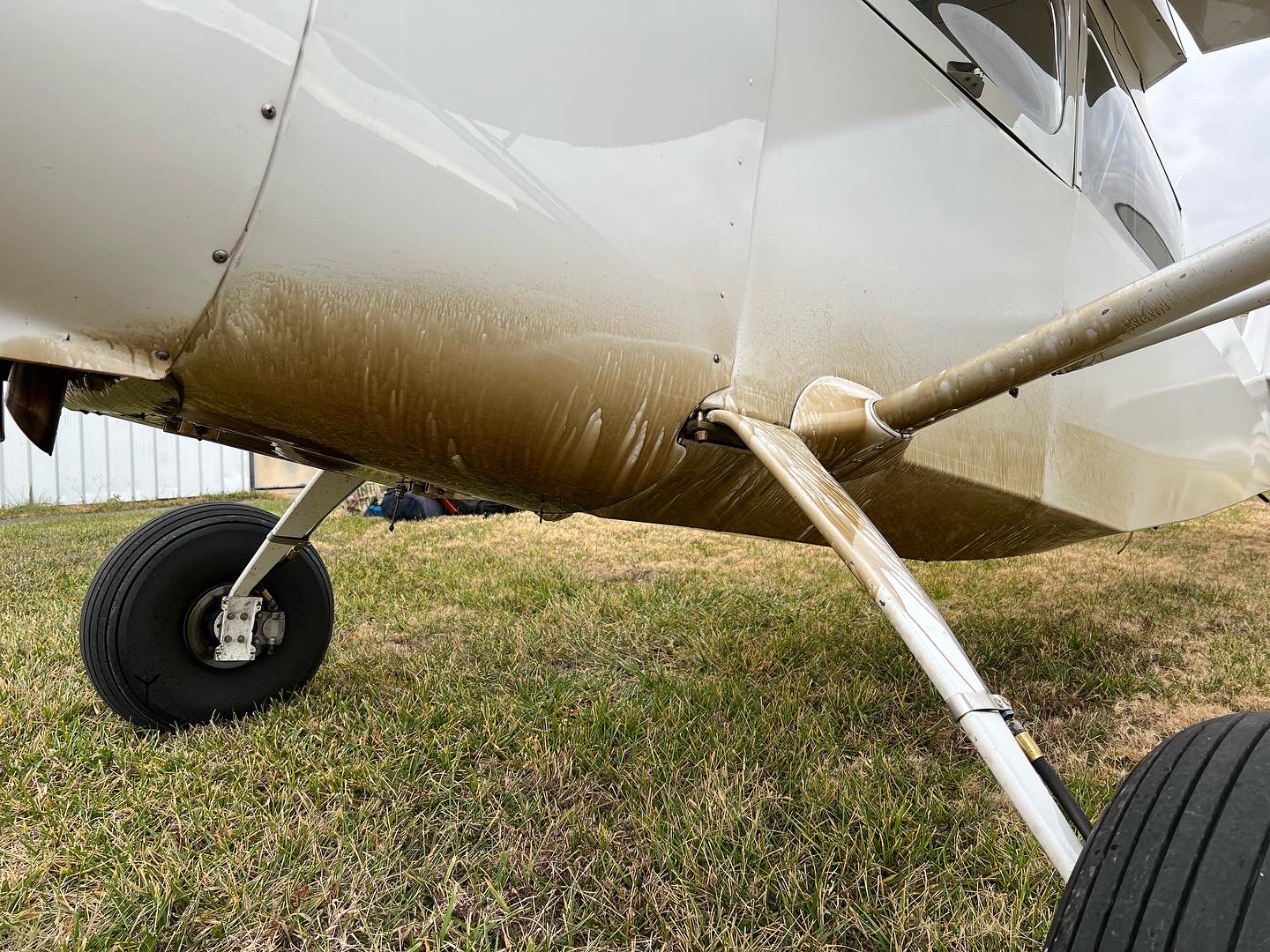

Had an interesting flight a couple of weeks ago, coming back from Arkansas - dropped into Newton City to clean a fouled plug, looked the engine over, did a good run up and took off. On departure got to about 900’ agl when I caught a faint odor of something burning… a few seconds later more smoke outside and then oil coming in through my heater vent near the rudder pedals. Bad noises commenced but the prop was still turning so eased around and slipped back to the runway. On roll out the prop stopped with a thump. No prop strike or any drama with the landing - just rolled out and pushed it off the runway. Additionally, noticed the oil filter adapter was sitting about 2” off the accessory case… wasn’t that way when we buttoned her up after swapping the plug.
Foreflight track shows 3 minutes, 28 seconds from takeoff to landing…
O320-A2B with about 500 hours smoh. Flown just over 150 hours since April.

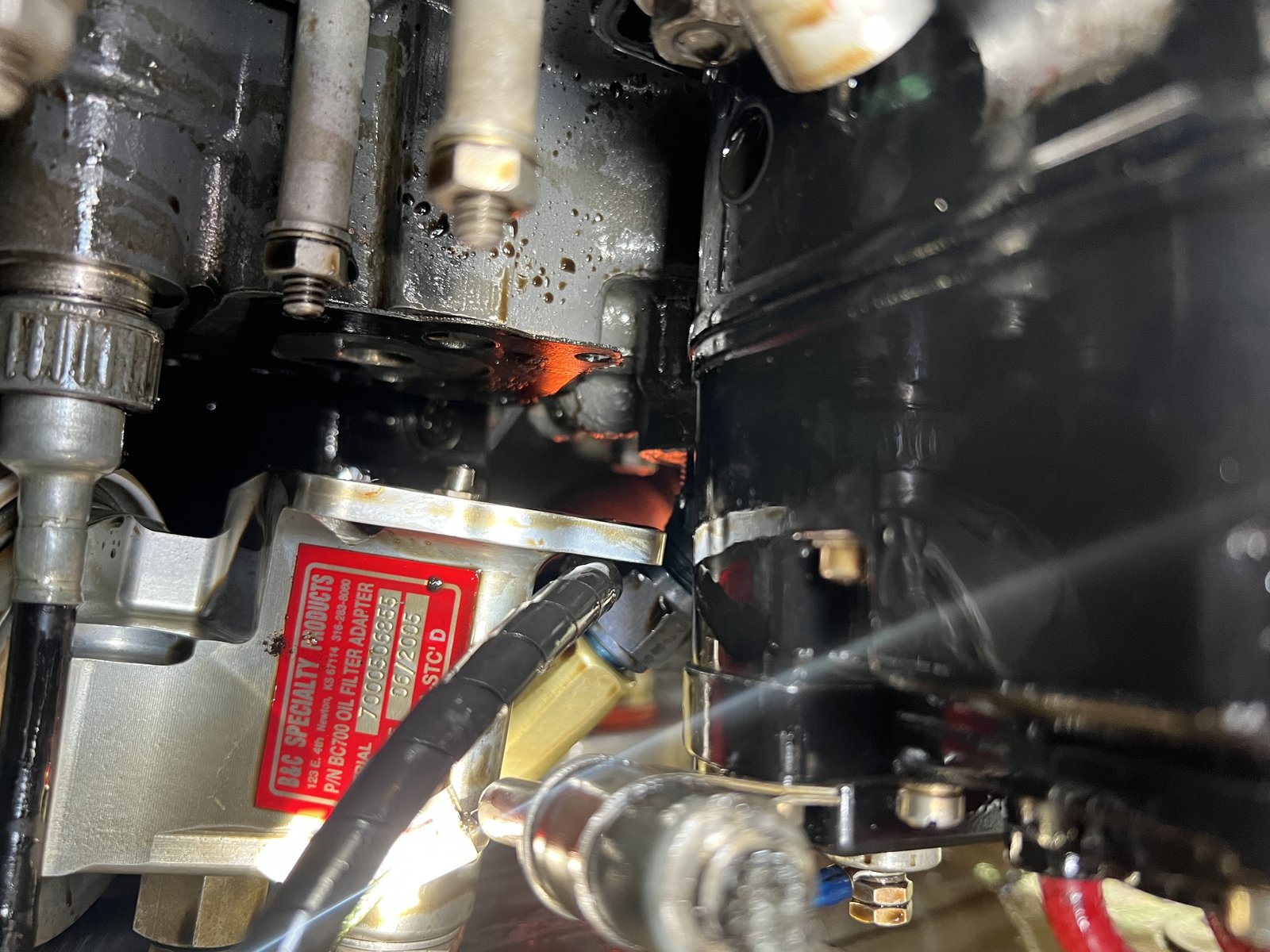

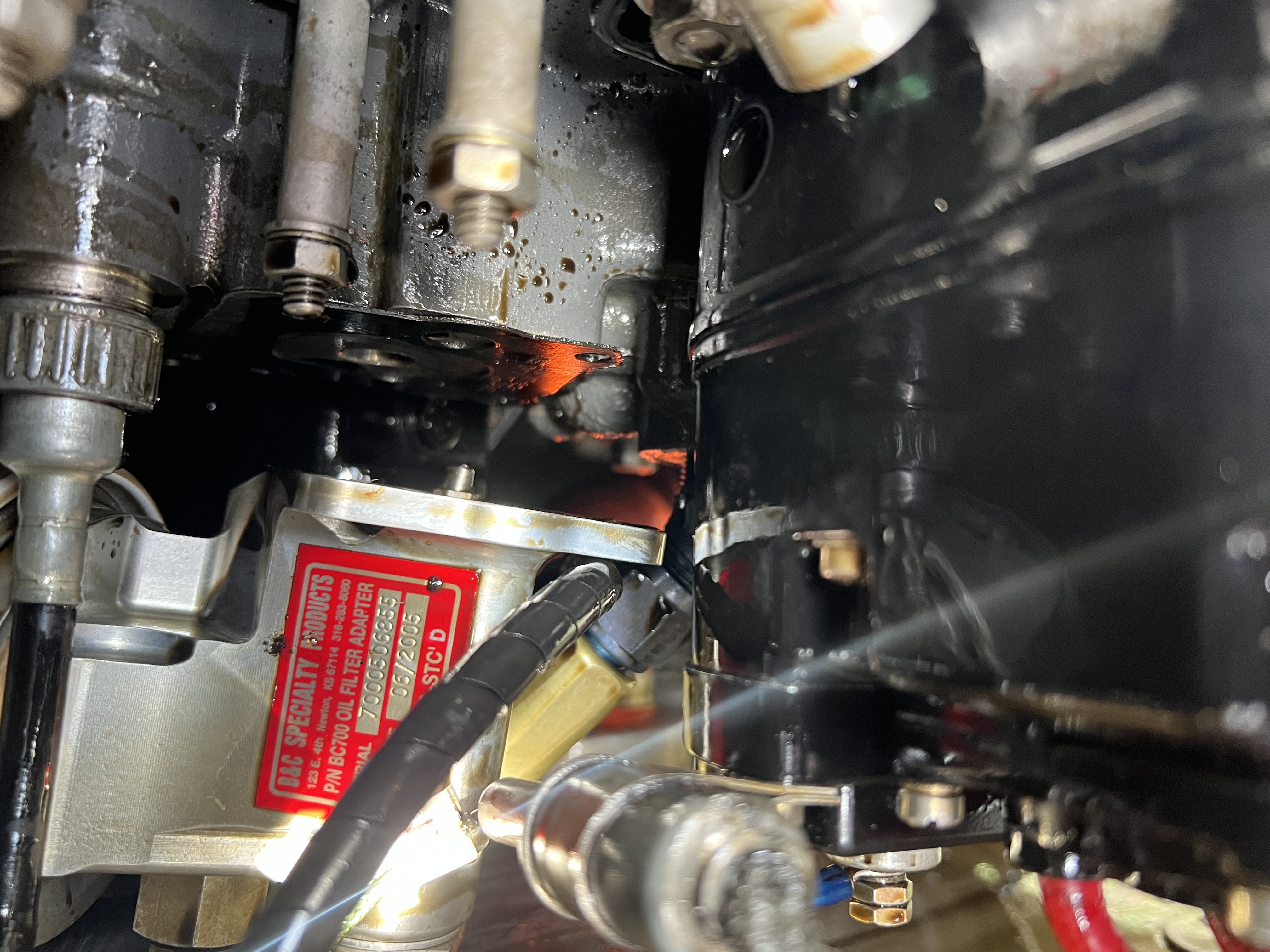

Wow, did the bolts on the adapter break or did they fall right out?

Those bolts just fell out… maybe all the vibration? But didn’t seem too bad at the time. Strange thing to me is that those were not safety wired, drilled bolts.

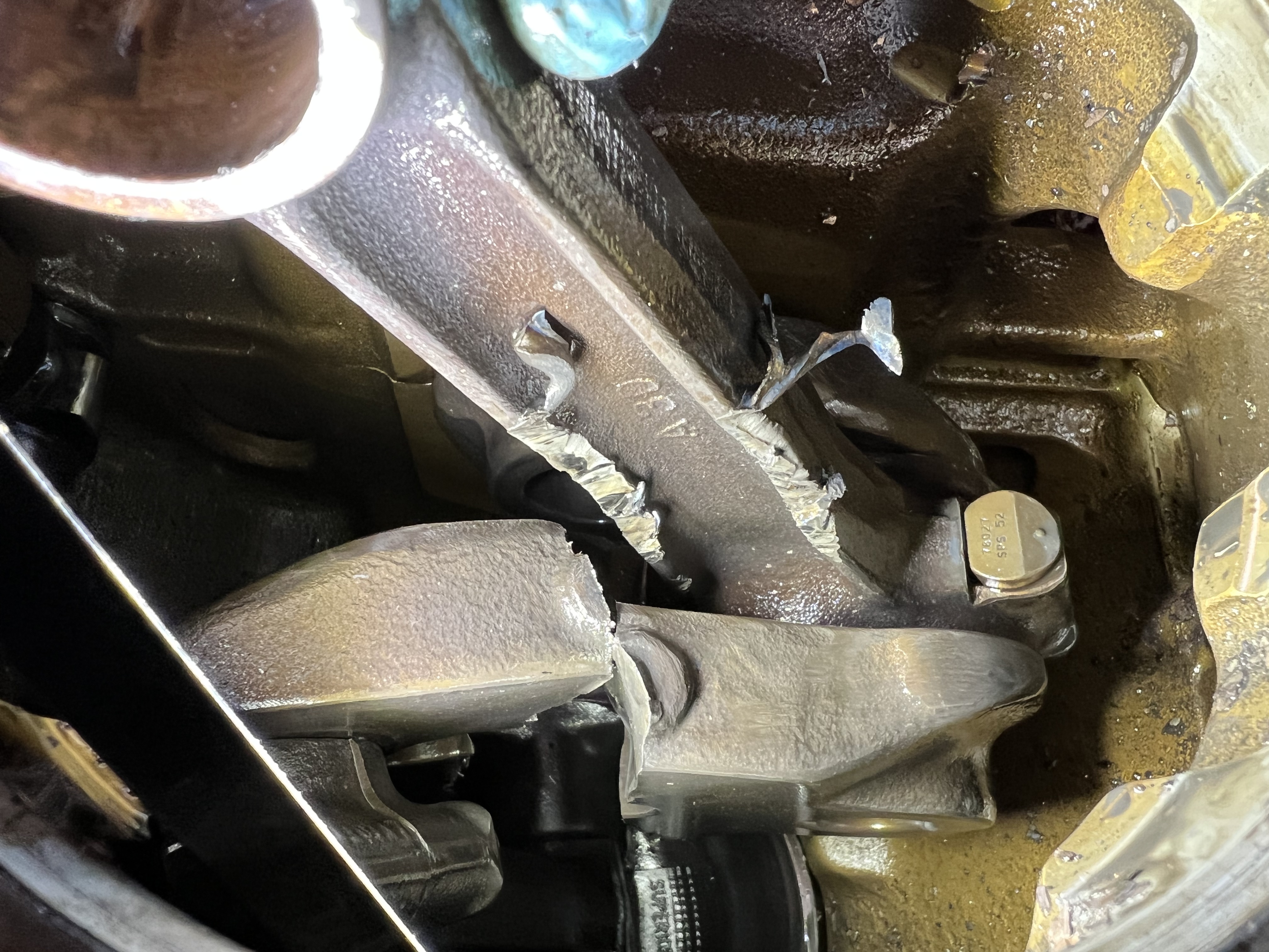

That’s classic! Yep, so far it’s a mystery… externally everything looked a-ok (except for the oil filter adapter). It was a surprise to see all that carnage when we pulled the jug.

I'd almost be willing to bet that those came out before this happened. If you were getting oil into the cabin before the loud bang when the crank broke, I'd bet the bolts were gone, then vibration caused the adapter to pop off the gasket, they usually stick on pretty hard, then the lack of oil is what caused caused rest of the carnage. Just my guess.

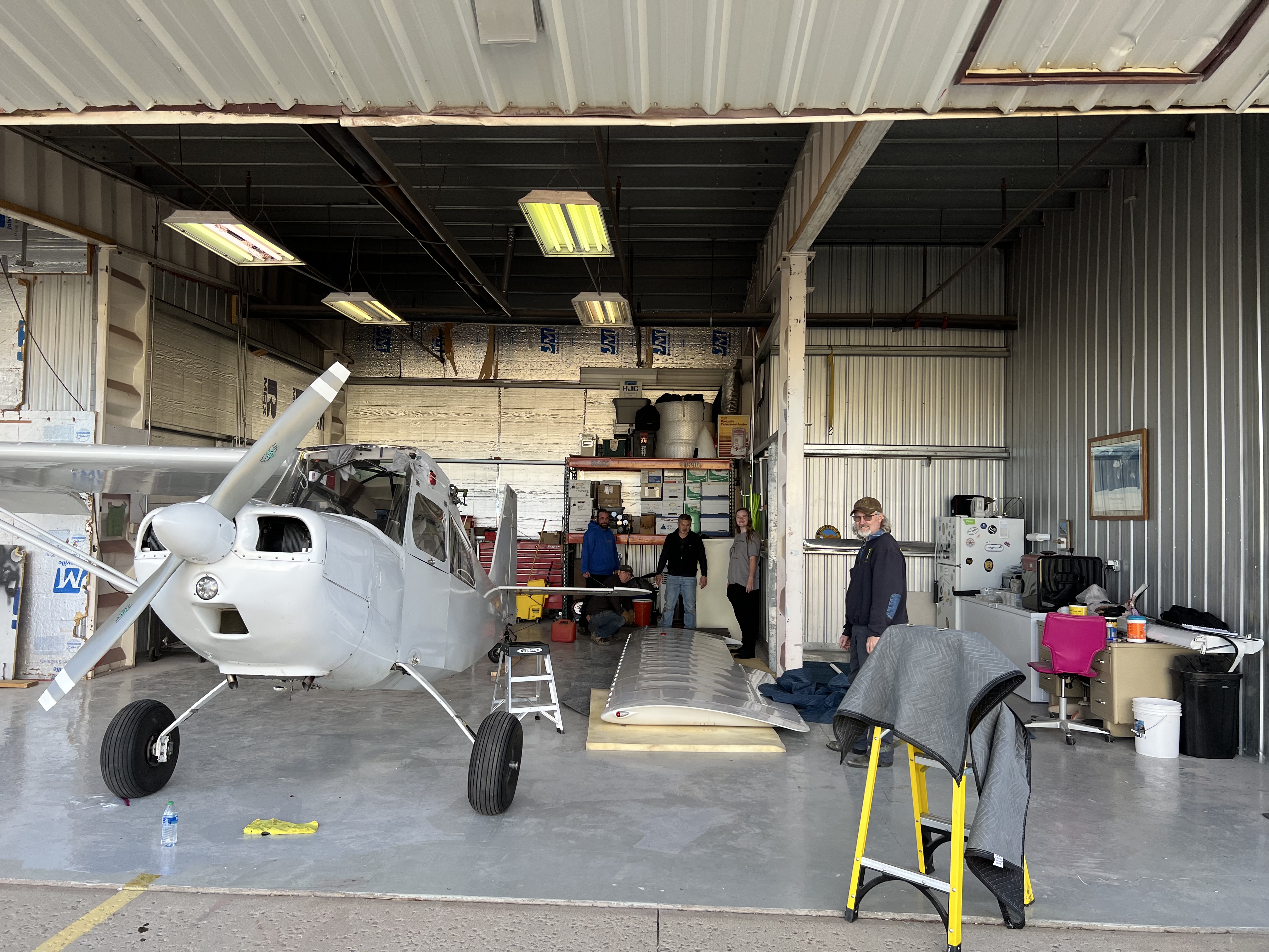

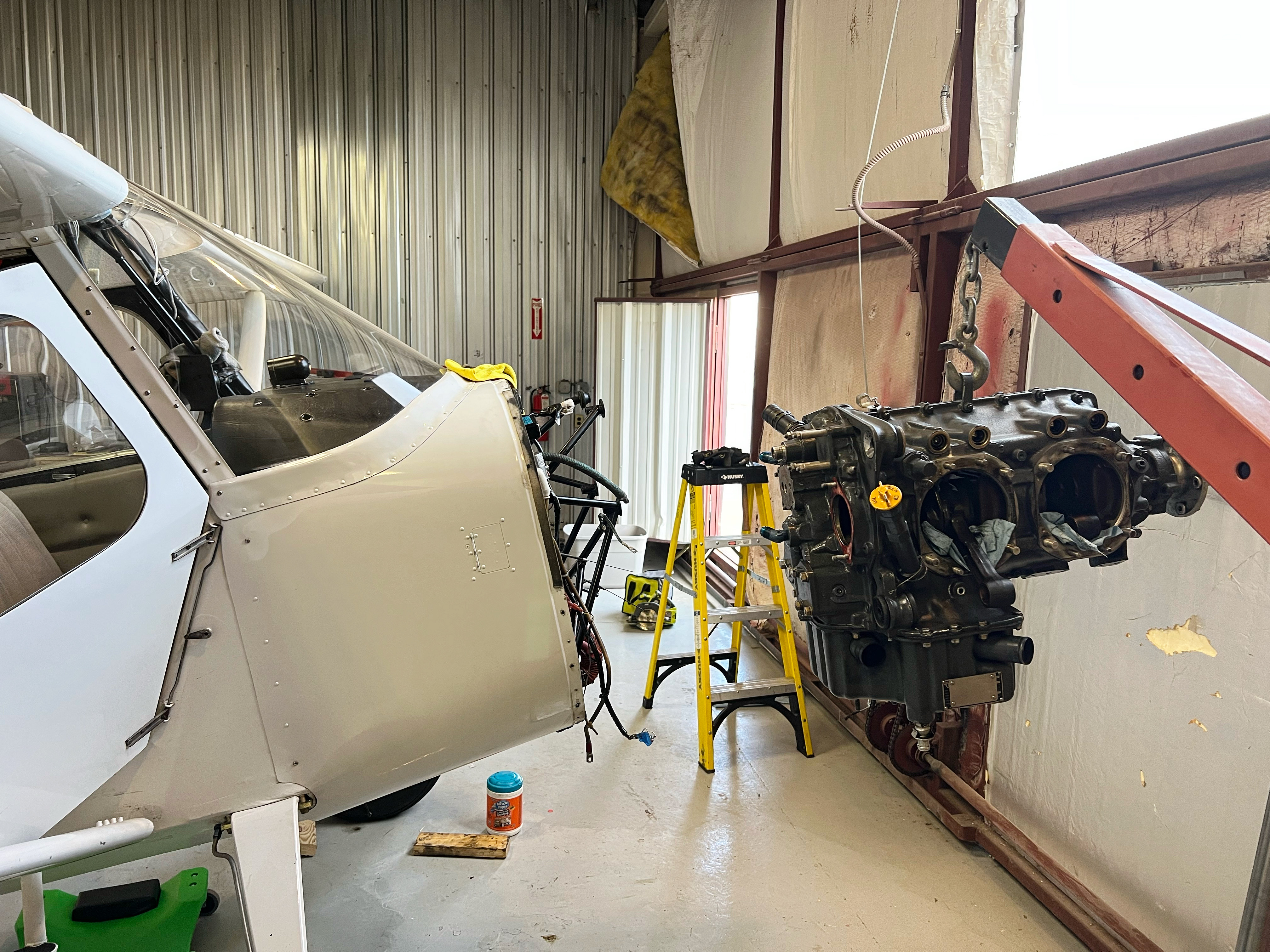

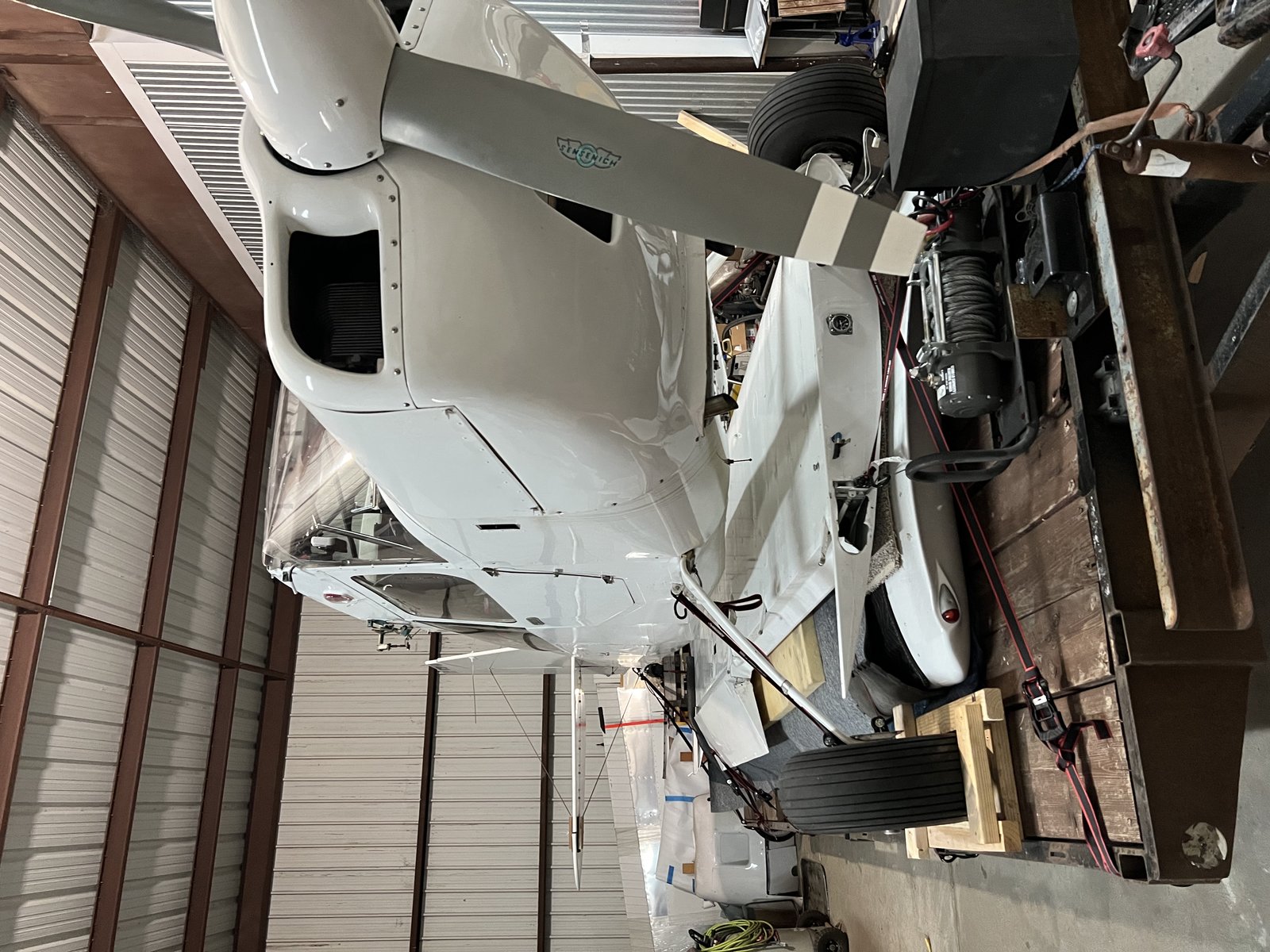

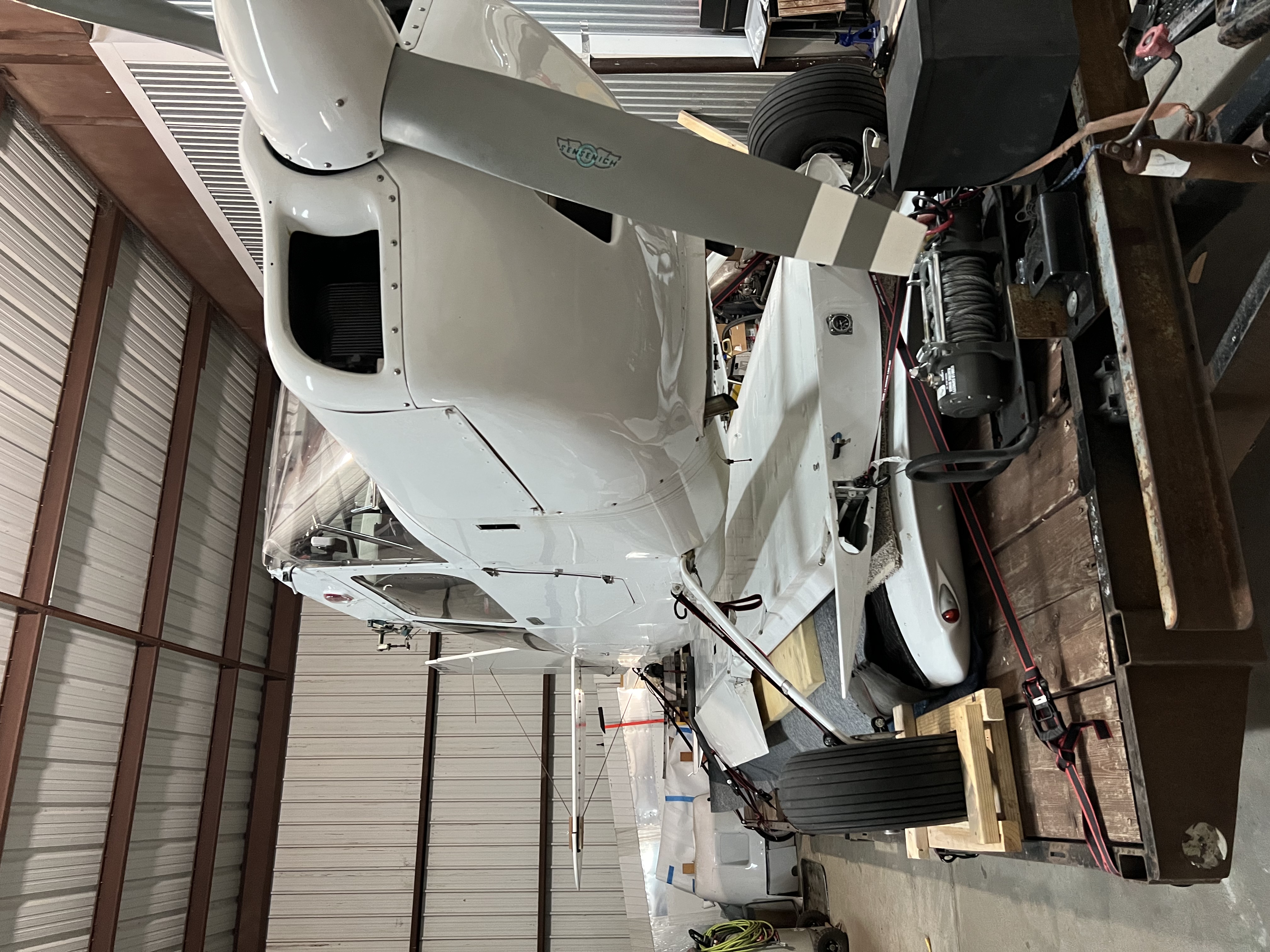

Oh yeah, it’ll be a hit to the flying funds, but already sourced an overhauled O320!
Working on getting her back together…
Trailering home from Kansas
Friends helping reinstall the wings
Pulling the “boat anchor”
That’s kinda the way we were leaning… My one glance at the oil pressure gauge showed all normal but then I was padlocked on flying the bird and honestly never went eyes in until I was on the runway.

On the topic of you saying you were surprised that those bolts weren't drilled for lock wire, keep in mind that many bolts on the engine aren't. The bolts holding the oil pan on, the case half bolts, and many other bolts don't. But they all have proper torque specs and have washers and lock washers on them. The filter adapter has the same washer stack up. I've never seen those bolts loosen up if new lock washers are used when they are removed and if the proper torque is used. Not to say it can't happen, but to have all 4 work there way out, I'd be a bit suspicious. There is a fair bit of thread engagement on those bolts.

Yep, agreed… kind of suspect. I’m digging through past photos to see if I have anything that shows what it looked like prior to the failure.

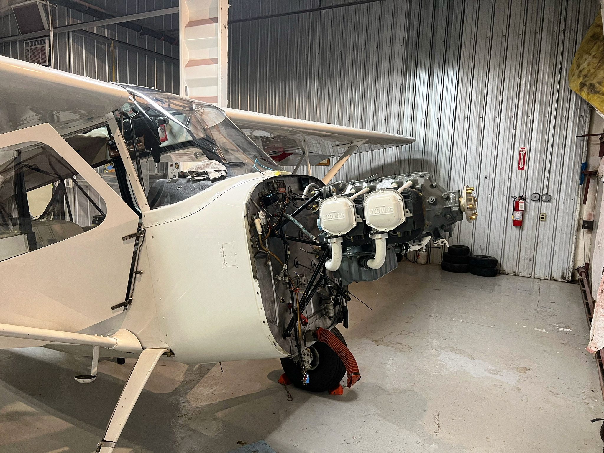

Thanks… I don’t know if we’ll ever figure out why it blew up, but every time I look at it I’m impressed at the forces involved in tearing itself apart.
On the plus side, I’ve now got a zero time O320 hung on the motor mount and we’ll start getting everything reconnected.
