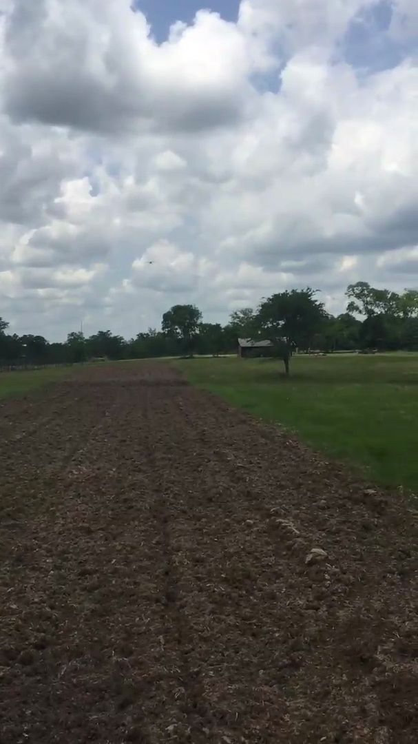

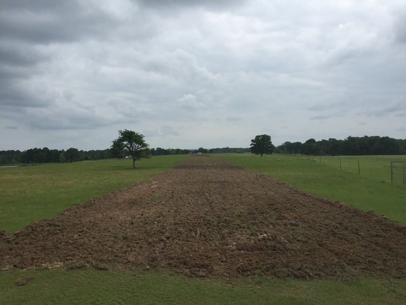

Anyway, point of the story (guess I could have left everything else out!) is that I cut in my runway this weekend. It needs a few weeks for everything to die off and I will go back and disc and grade it. It's about 1100'X50' and I can't wait to get down there for the first time! I will post pictures as it comes along.
Here is where it is now:
North end of 15 looking south(ish)
South end of 33 looking north(ish)

Beautiful spot you got there. Looks like it was pretty smooth before but should be nice now. Will you plant a different kind of grass or what?

It was a lot rougher than it looked - pigs have the place torn all to hell. I'm not down there enough anymore to keep them in check. Has a slight rise in it - hard to tell in the pictures but a small roller about 1/4 down from the north end that I will try to grade down some but nothing major.

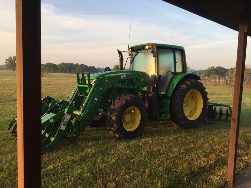

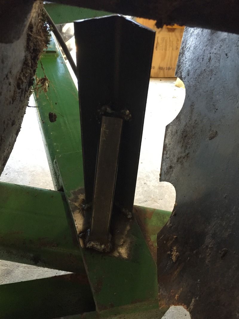

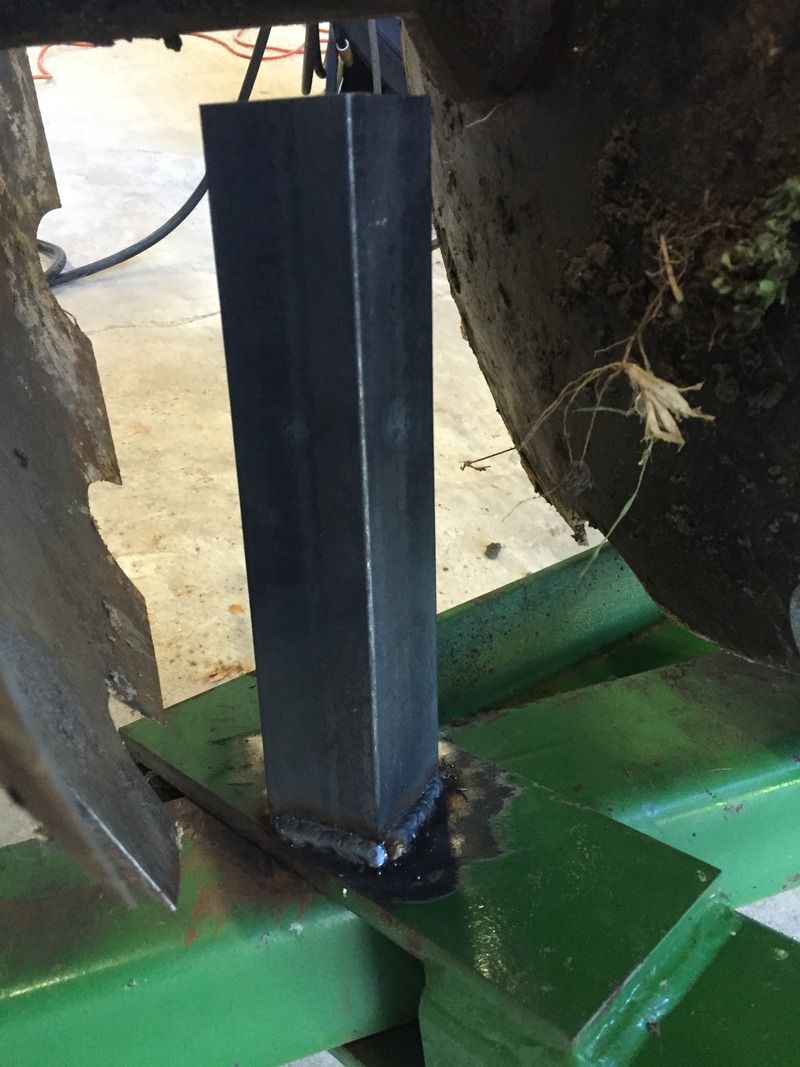

Luckily, we do quite a bit of work out there and I we do many acres of food plots so we have all the needed equipment. We burned a JD6320 to the ground last year when it had an electrical fire and now have a new 6105M. I am using an 8' Frontier disc setup that I have welded some grizzly bars into to keep them from clogging up with the sticky black farmland that covers parts of the property. I'll use a box blade to grade it and put a drag behind that to smooth it off. I don't intend to plant anything, I will just let the native grass grow back over it the keep it mowed.

Excellent, thanks for the quick response. Slick idea on the bars. As far as grading with the box blade, will that handle any of the bigger humps that you might come across? I used to live on a 2200' strip, but it had already been constructed so it was mostly maintenance. Lot of mowing! It was never seeded either, just let the Bermuda fill in. Just keeping it mowed short did most of it, but we did have to control Dallas grass. Amazing how bumpy that bunch grass can be if you don't control it.

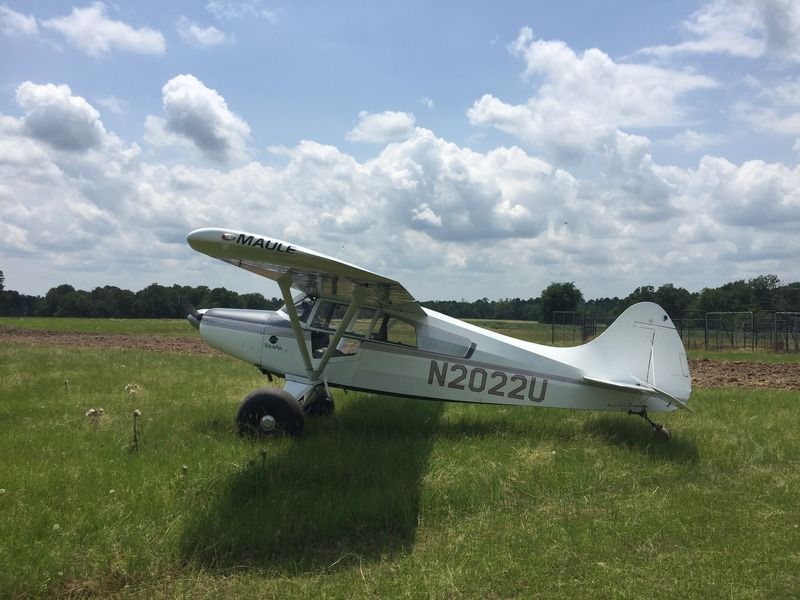

Well, I disced and graded it yesterday... Still too much grass in it to be smoothed out by any means. Hopefully ripping the grass with the box blade will take its toll and I can disc it again in a few weeks and try again. But, got the maiden voyage in 22U to the ranch under my belt on Friday the 13th no less!
