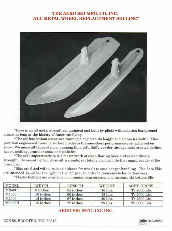

Thanks. I got a fact sheet on the straight skis from Aero this morning. Their approved model sheet seems to say that the R2800 spring retractables aren't approved on the 170 but I'm waiting on clarification from them.
Posts: 1319
As I noted before, you won't go wrong with a set of those skis. That said, in your country, you need FLOATATION, and the biggest set of skis you can bolt on that airplane. In this case, that would be the 3000s.
The 2800 semi retractables can be a decent alternative if you really need a retractable ski, but they are definitely a compromise from a truly retractable ski. They are also a lot more expensive than the 3000 straight skis.
If you order, make sure you specify the plastic installed on the bottoms, and springs, not bungees. You may have to field approve the springs, since the stc calls for bungees, but I don't think Aero even offers bungees as an option any more.
Great skis, in any case.

You already know I've got 3000's, and am very happy with them. I got turned on to them by Hollis, who was pretty pleased with them on the park Husky. I will say that that particular pair of skis was pretty bent and mis-shapen. Hollis attributed it to lots of use, bumpy ice landings, etc... You might find him to be a good source of info, if he's even available to talk to right now.
As for Springs/ Bungees, Ward Of Ward's Aero on MRI did my install, and made a case for Bungees. MTV's advice is clearly the conventional wisdom, but Ward knows a thing or two. For the temps I operate in, bungees have always been fine

Hey DP.. Those are Aero-Skis. Made in Brooten, MN (they don't have a website)
The guys I know here in central Minnesota flying them, really like them. I've used these wheel-skis in powder (not deep mountain powder of course) and with enough power they work well. I think they're a good compromise ski. (wouldn't put them on anything less than 150 hp)
Brad
