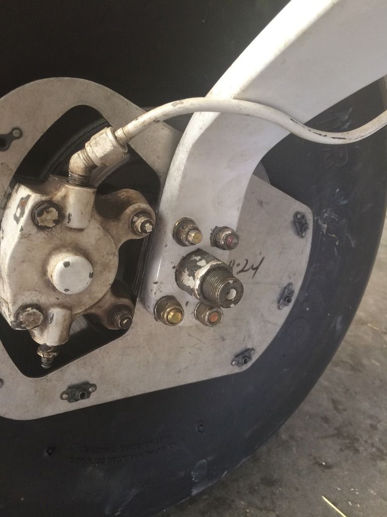

I've got C172G with a Bolen TW conversion, am I've had a pilot friend that told me he felt like there is a gear aliganment issue.
I had a mechanic look at the main gear alignment and he said it does need some adjustment. On the Bolen conversion there is a large stud that goes thru the main gear leg, along with the 4 mounting bolts like most other Cessna axles. The mechanic told me the hole in the main gear for the stud on the axle is too tight of a tolerance to add the alignment shims. He is suggesting we get approval from the FAA and cut off the stud, or replace the axles with Cessna axles. Does anyone know of a reason this would not be ok? The original Cessna design only had the 4 mounting bolts.

Can you get approval to turn down the center a bit to allow for some angle from shims?

It looks like there is a stack of shims in there already? Why can't you just make some shims or buy some Cessna shims and drill a hole in the center.... Don't know if the four bolts are in the same location.

Same set-up as mine, and it's shimmed.
Mine is in the shop next week for gear work and tire changes. PM if you need pics of the parts or assembly.

I believe Cessna specifies a very slight amount of toe-in. Look in the Cessna series 100 service manual, it should give you the procedure for aligning the wheels on a 170. Basically, put the mains on greased plates (so the wheels can move freely), load it up (to gross?), then check. There's other methods, with plumbing down & snapping centerlines, triangulating off the tail, etc, but I believe the Cessna manual spells out the quick and dirty method: you put a straight-edge across the front of both tires, and a square off that to measure against the side of the tires, or the wheel rims.
I've never seen a Cessna gear leg drilled like that, with a stud coming out. Is that for mounting wheel-ski's or what? I don't think I'd like that big hole through the gear leg on my airplane. There has been some incidents of Cessna gear legs breaking in that area, generally through the axle bolt holes, and almost always on airplanes which have been operated on skis. There was an AD proposed to require a special inspection on all Cessna gear legs, but it was never enacted.

The amount of load (stress, strain, shear, flexure, bending, whatever) on the landing gear at that location... and the ultra-high temper (crack sensitivity) of spring steel landing gear legs... makes putting a huge hole in that area a really bad idea IMHO.
If you welded in that big axle shaft on both sides of the gear leg, then shot-peened the shit out of it to relieve all the stresses, then re-annealed it soft, and then re-heat-treated the whole assembly back up to "spring steel", then maybe shot-peen it again... then maybe.
Any of the formally trained "genuine article" engineers on this forum can feel free to disagree if I'm wrong.

Yup...you don't want to mess with the spring steel. But if the center bolt is too tight to allow cants to be installed, perhaps .005" off the diameter of the center bolt could work to allow it to go through skewed.

Are you actually experiencing handling issues or is this a perceived problem?
What some might recognize as an alignment issue from the standpoint of operating could be the lack of effective rudder before the tail is raised. At higher angles of attack (takeoff rollout with the tail wheel planted) the P factor will make you feel like your running out of right rudder until you pick up the tail (at least mine does). This is generally attributed to the swept tail.
I used to wear out tail wheel tires real fast. Then I slacked my wheel steering chains (changed to the compression springs from tension springs). That improved my ground handling manners a lot and stopped wearing out tailwheel tires and steering arm bushings where the chains attach to the rudder arms. Just some food for thought.

Yup. Mine is exactly the same, and that gear is hell bent for stout. And, it's shimmed so you can adjust the angles.
I cracked the fitting on the left side where the gear exits the fuselage, which allowed the gear to rock aft a few degrees. It wanted to go left on landing like there was no tomorrow, which gave me the one and only time in my life when I got a wheel off the runway and a few inches into the gravel before I wrestled her back.
Once diagnosed, and fixed, this airplane is back to being as docile as a kitten, and tracks true.
