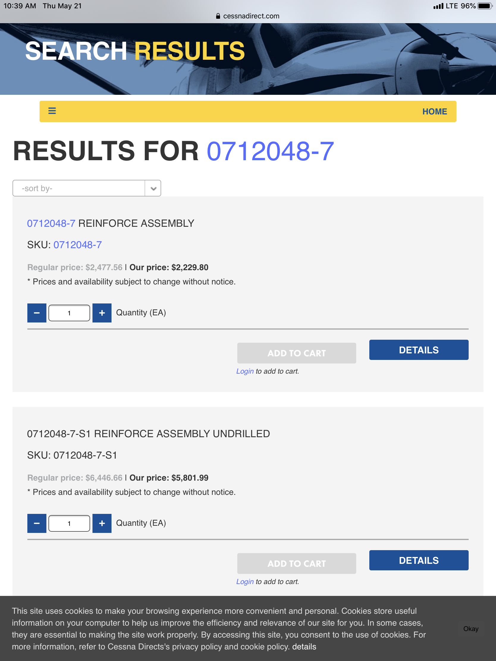

There’s no way the inspection could be done in 2 hours, unless a borescope is used. In fact, the labor/parts breakdown has a separate line item for remove and reinstall stabilizers/rig flight controls. The Feds say 8 hours to do that. I would estimate it would take me 6-8 hours for horiz/vert stabilizer takedown and another 6-8 for reassembly, plus a another couple hours assistance with another pair of hands. Not to mention another 1/2 hour for for logbook entries and updating the AD list.
The most expensive part I replaced, 0712048-7, is now $5802; undrilled. Drilled, $2230. When I replaced mine, I tried a salvage one, but the drill pattern didn’t match well enough. I guess the good news is that part was $7K in 2018, so they’re a little less hideously expensive now.
