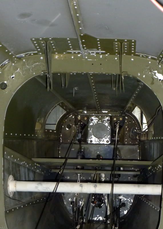

C180K Unknown Internal Fittings....
Any clues as to what the two riveted fittings on the top fuselage are?..
There are smaller fittings behind these as well...

I am not sure what a stock water rudder control system consists of on 180's but this might be someones home built pulley brackets for water rudders if the ship was on floats in a previous life.

Rudder centering system for the seaplane kit.

Thanks guys...thought it might be something to do with that.
Has a factory installed floatkit but these look like add ons as suggested by wagonwrench...
