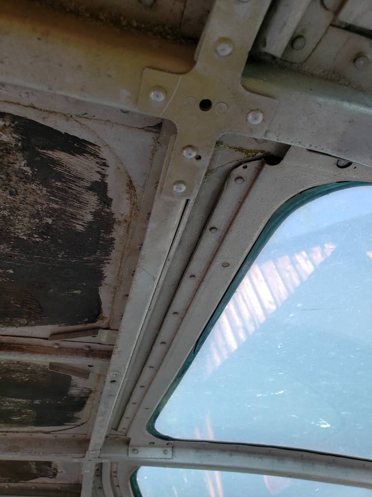

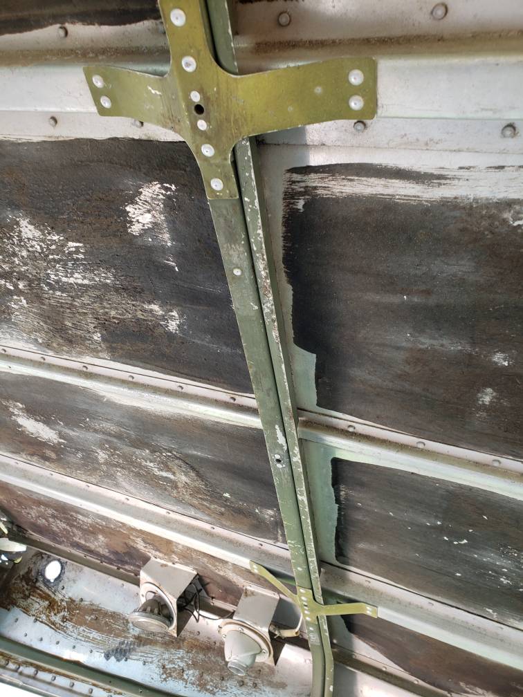

Cory or A1Skinner-
Can you show where the nutplates are that you are attaching to?
I really do not want to take the whole headliner out of our 206 to add shoulder belt attachments.

behindpropellers wrote:Cory or A1Skinner-
Thanks,
Here is a couple pictures of my 206 with the headliner out Tim. If you want another angle let me know and I can snap a couple more.
David
