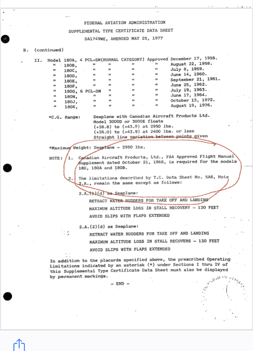

Re: CAP 3000 STC??
To anyone whose stuck

Re: CAP 3000 STC??
Good on you for reporting back and paying it forward. Thank you.
Where’d you finally find it?
