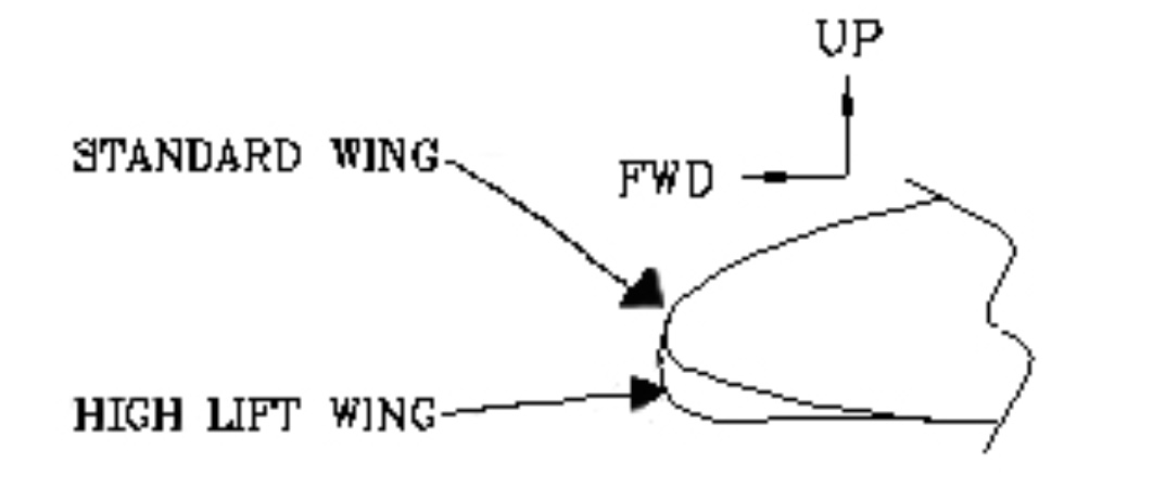

Battson wrote:Did the first 180 (not the 180A, the 180) use a different one to the rest?
C180 uses a NACA 2412 airfoil.
I think I read somewhere that all the (post-WW2) strutted single-engine Cessnas except the Caravan use this airfoil.
Re: Cessna 180/182/185 Wing Performance
The Cessna airfoil was changed to a “camber lift” airfoil with the C180J SN 52285+ in 1973, so thereafter the airfoil would no longer strictly be a NACA 2412.

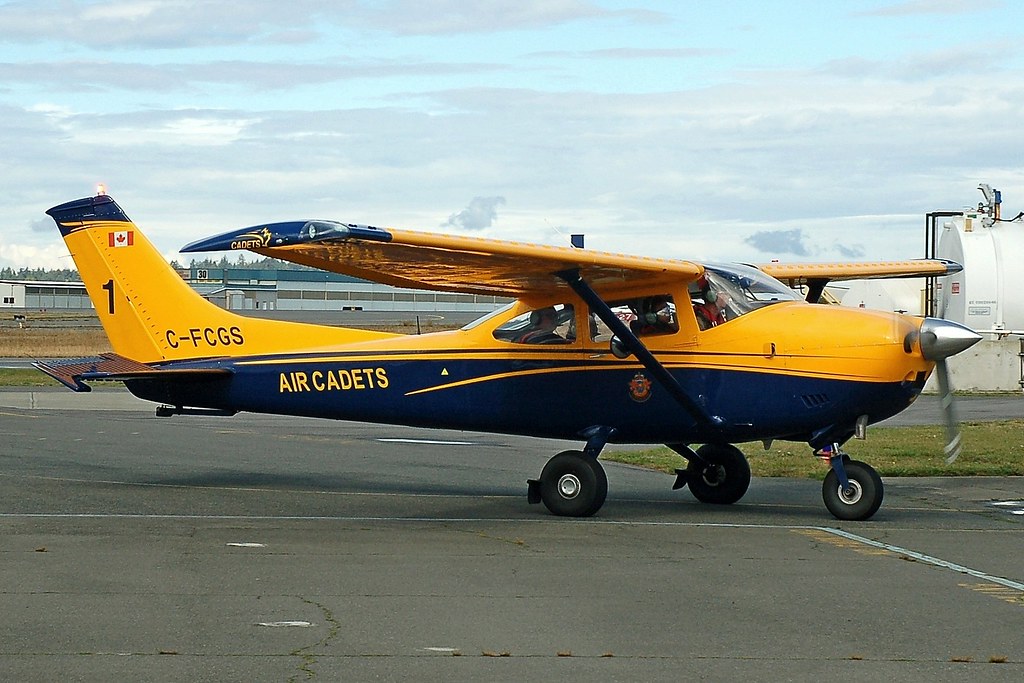

Our local air cadets have transitioned from L-19's and Scouts to Cessna 182 for a glider tug. Had a look at one and a brief talk with one of the pilots the other day. A few mods: more horsepower, Sportsman cuffs, VG's, extended wings. Tires are 8:50 mains, 8:00 nose on an Airglas fork. They tried 8:50's on the nose but the fork didn't like it (cracks?). Rock deflectors for the mains, and rubberized protection for the horizontal stab that still looks like it takes a beating. No interior, just the seats, and the metal painted grey.

I don't know how they are holding up, but they were really sweet when they came out of Victoria Air Maintenance. I saw a couple in the build and they took them back to bare metal.
