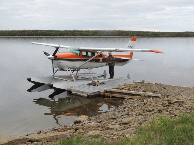

What kind of plane is this one, 205 or 206? It has an Adams Apple and a baggage door like a 205. But also its on floats. This is an old pic of Bush Pilot John Ski, in Northern Quebec. He didn't own this plane however.
We celebrated his 90th birthday yesterday. Question came up as to which model this is. Any thoughts?

Probably a P206.
