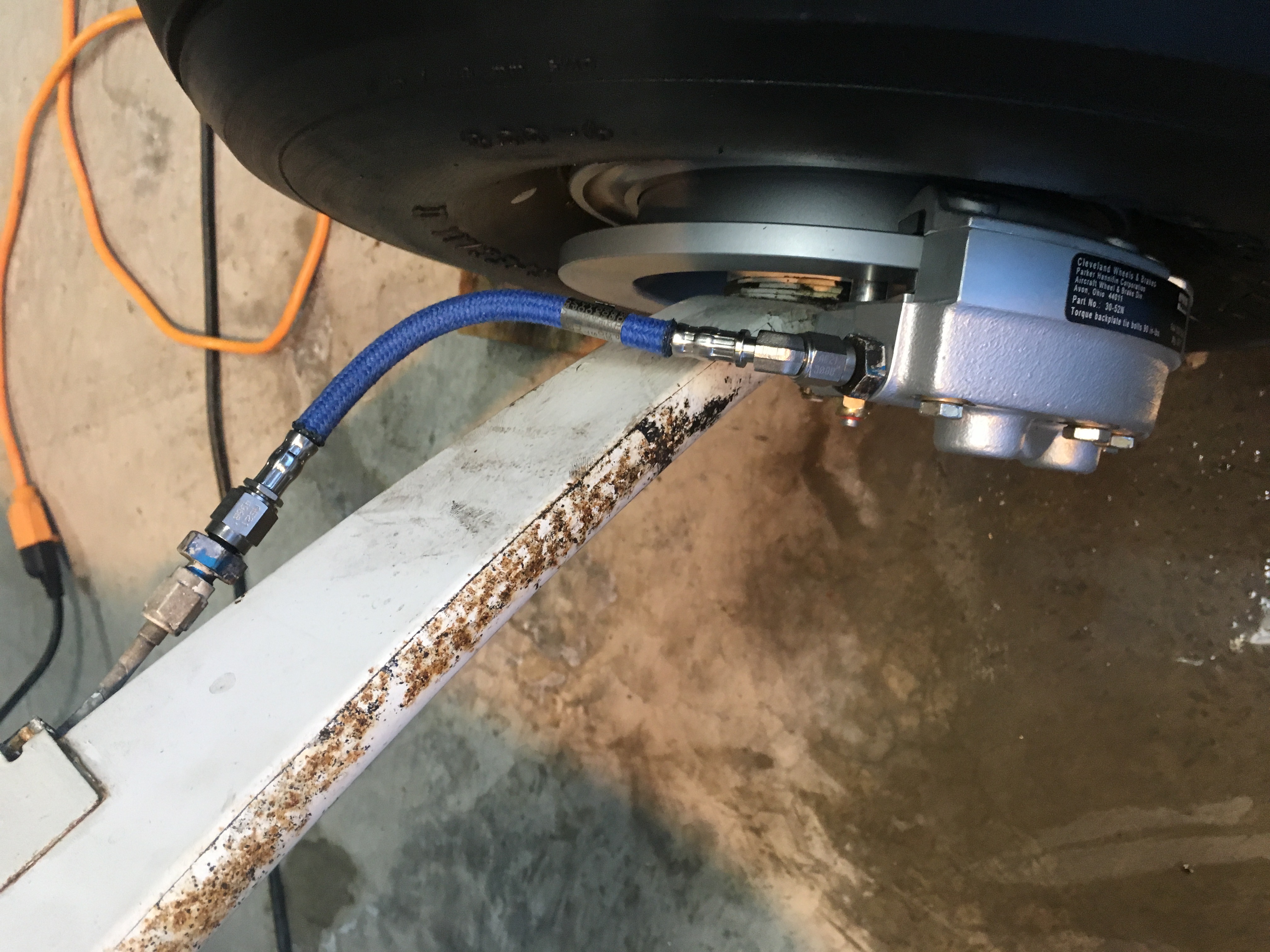

I just put these new Alaska wheels and brakes on replacing the McCauley's. The Mac's were over the top into a straight fitting. It looked like that would hit the 29 Bushwheels when I put them on so I elected to do this. My 54 180 that I've owned since 1988 came with this routing too.

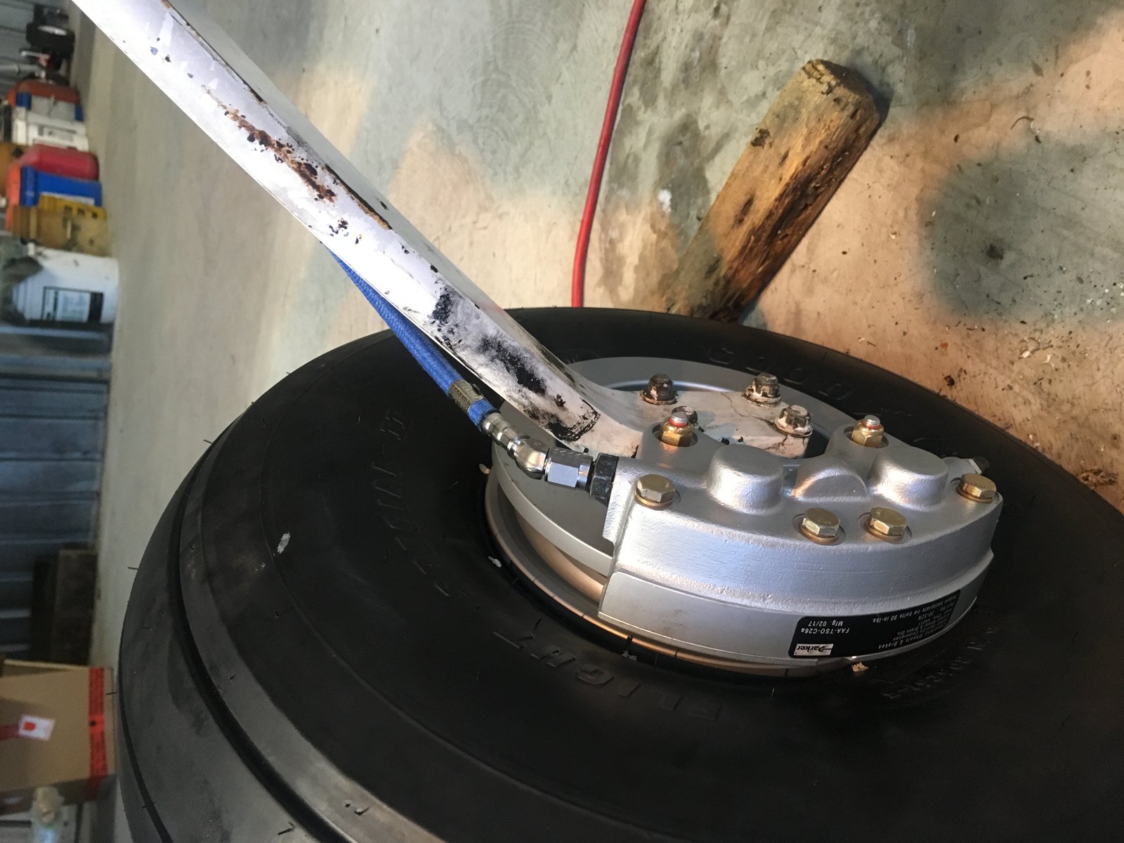

Re: Cleveland / Cessna 180/185 brake line routing
This is how I routed mine when I did Cleveland wheel/brake swap. Ditched the McCauley stuff due to cracked wheel and cracked/leaking caliper. Is it wrong according to the drawing…? I dunno. But it definitely seems like a good route.
B
