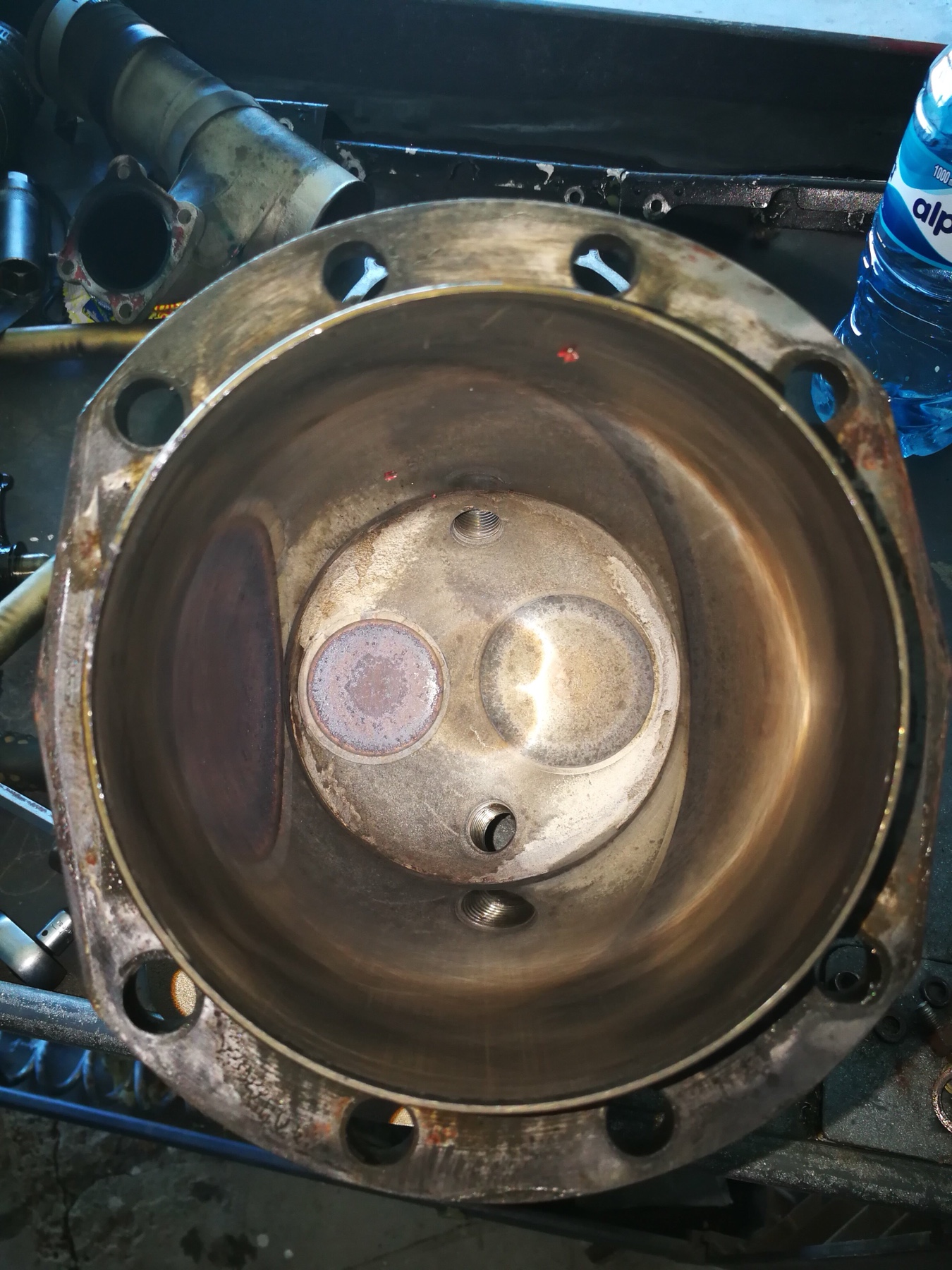

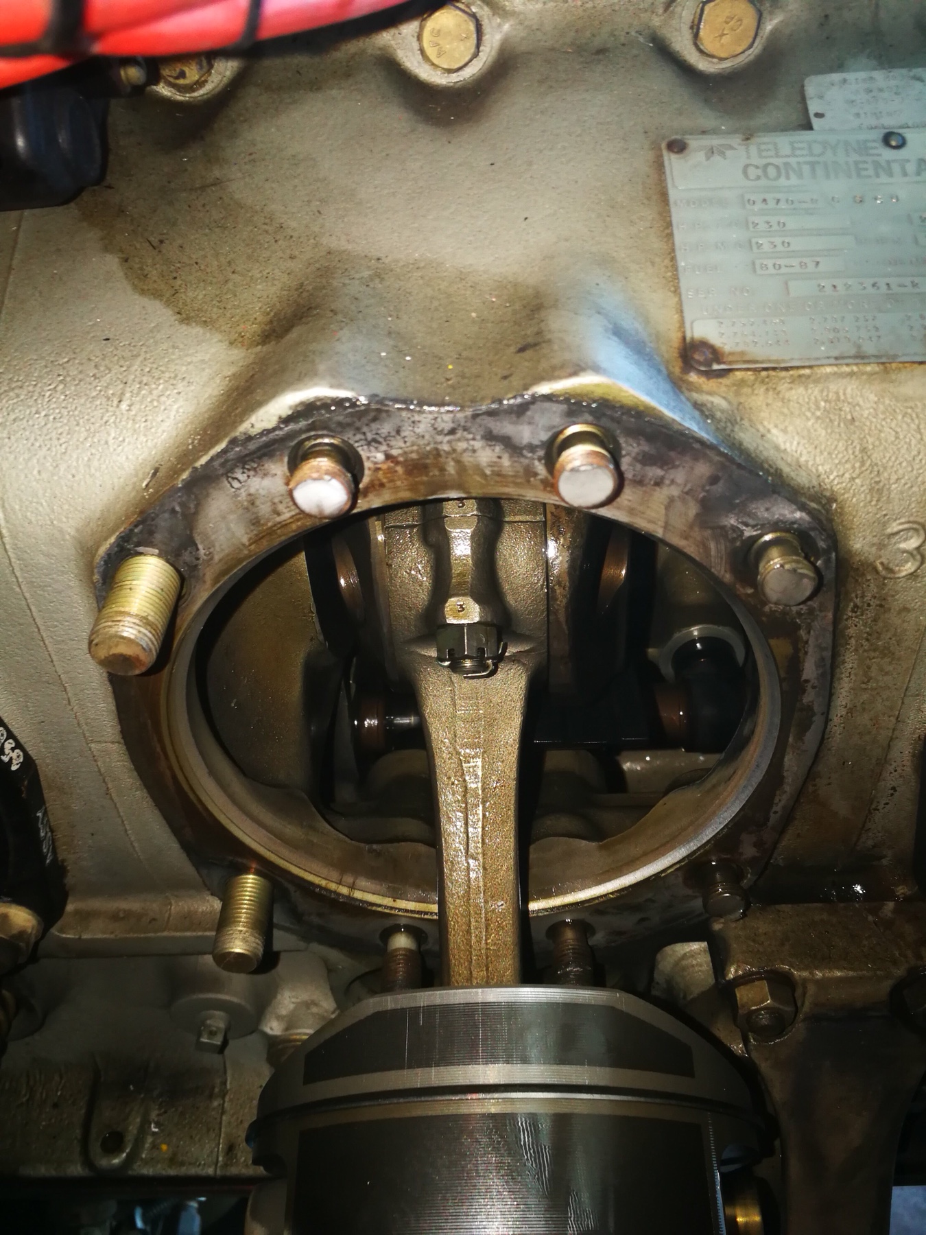

Is that black permatex between barrel and case? I think they should be installed dry with only the o-ring in there. The permatex messes with the torque over time and bolts “loosen” up and then break. Looks like it can be saved though, to me the cylinder and valves look good.
