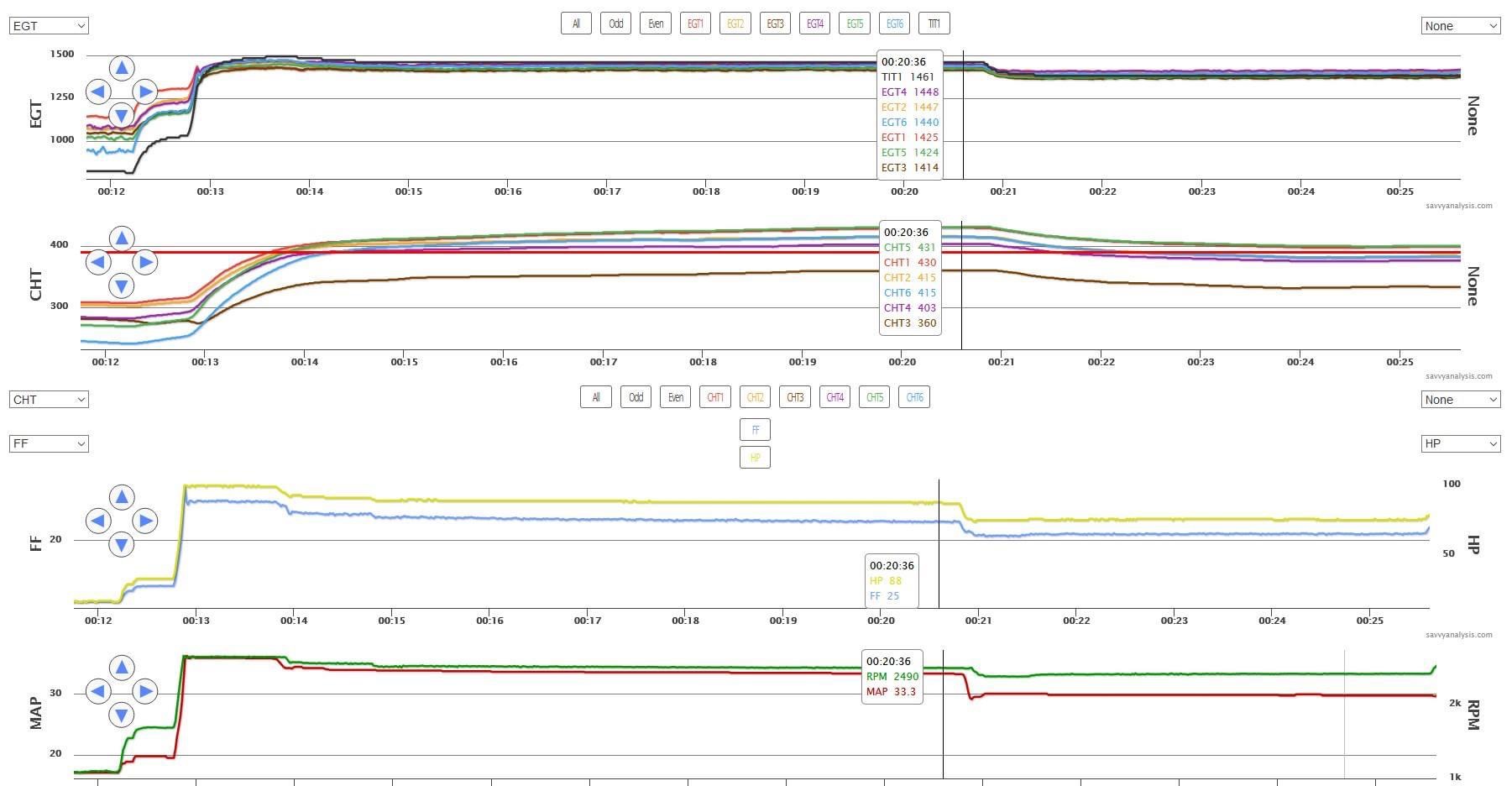

How have you solved high temperature issues? With my tsio520m on floats I just can't keep the cht's below 400 after takeoff and during climb. Today cyl#5 peaked at 437 with an oat of 85F, 32"/2500rpm, 25ff full rich, cowl flaps always fully opened, enlarged ones, 90kts climb.
Will try to climb at 100kts, tune for 0.5gph more (I'm getting 30.5 on takeoff not 31), fine tune the fuel system as per sid97-3 (now part of M-Zero I was told), check baffling again, check oil cooler and thermostat (peaked almost at redline with 237F), mag timming (21 btdc iirc).
Trying to figure how lonely I'm on these high numbers

I’d go for higher fuel flow at takeoff power. Book number is too low in my experience.
What are your ambient temps?
Posts: 10585
Re: Controlling CHT's
I was concerned I reached 437F with an oat of 85F: it will not be unusual to fly with 92F ambient, that's what summer and floats are for, aren't they?
Can you recall how much FF you got dialed for takeoff power? I'm thinking about asking my AP for 32gph
Data of flight, primarily takeoff and climb phase.

Canalguna wrote:I was concerned I reached 437F with an oat of 85F: it will not be unusual to fly with 92F ambient, that's what summer and floats are for, aren't they?
That's warm for floats, no doubt. I've worked floats in 185s and 206 at over 100 F, which takes restricted climbs, and paying careful attention to CHT and oil temps.
I liked to see at least 30 gph flow and more like 34-36 at max power on the 520, and on the 550, I wanted that needle all the way off the scale, over into the neighboring gauge.

If you don’t have cowl louvres add them. They help a lot.

mtv wrote:That's warm for floats, no doubt. I've worked floats in 185s and 206 at over 100 F, which takes restricted climbs, and paying careful attention to CHT and oil temps.
I'll gather courage to encourage my A/P to crank the flow to something around that. Anything to control those darn temps.

Close your cowl flaps a little, they may be too far open creating turbulence around the opening instead of a suction.
Make sure baffle material is not folded backwards, this happens when reinstalling cowling that many pilots and mechanics over look.
Make a note of what your full throttle fuel flow is on take off and initial climb, compare with what MTV suggests.

I just realized that you're running a TU-206. Those babies run hot, and double that on floats.
And, yes, all at least late model 206s have the louvers stock, I believe. I'm not sure adding an extra set would help much, but maybe.

Thanks for the info Barnstormer, they do look great and glad they helped you reduce those Chts. In my case I don't know if I can add more. Just saw a P210 with a huge naca scoop on it's upper right cowling, interesting.
Kurt, your idea sounds logical, will try it, though last time I closed a notch the temps skyrocketed iirc. You're right about the rubber baffles, will check them again. I'm suspecting of wrinkles in them, like a saw on a video today. My fuel flow is 30.5 gph at takeoff now, I'm hoping that throwing buckets of fuel may control those temps, we'll see.
MTV I think you flew Tu206s on floats; am I alone in these hot issues? In your experience what would be a normal/tolerable temp in my circumstances?

That NACA scoop was associated with an intercooler. That might be a solution.....an expensive one.
And, no, I’ve never flown a TU 206 on floats. Only one I’ve been around was in Kodiak, and they fought that thing till tbo and converted it to a U 206. The issue there though was very short legs (air taxi) between villages, and short cutting cool downs. Kodiak never gets “hot”, and rarely gets warm, so I don’t think that was ever an issue.

Make sure all your SCAT tubes are in good condition. You can loose a lot of cooling air through worn or poorly clamped tubes, like the one which attaches to the fiberglass heat muff on the firewall, which is often partially collapsed.

Yup it seems the intercooler might help, though I don't know if it'd be worth it. I was excited about the remote oil cooler, which left the intake free for hot cyl 5, but my serial number is not contemplated in the STC. Might get a local approval for a major alteration though, things get complicated.
I can control the CHTs in cruise, it is the runaway during climb that worries me. I want to take care of the engine, and having periods of +420ºF is what I want to tackle. Hopefully extra fuel will help. Throwing 34gph instead of 31 at takeoff won't substract me considerable HP?

I already have them. It is quite frustrating that in spite of having the louvers and big cowl flaps, Chts do rise as much as they want to.

I don't have any experience with a TU206 on floats but experience with them doing lots of climbing in warm temps. First they will run hot which is one of the reasons why they have shorter tbo then the non turbo. With that said it should be controllable. There is 3 things that cool that engine, air, fuel and oil. As for air make sure the baffles are in good shape and doing what they are supposed to be doing. Also climb at a high airspeed, at least a 100. If it's really hot at 110 or more. Your climb rate will be slower but that's what it takes. 90kts airspeed will heat up quick. As for fuel make sure the fuel system is adjusted correctly. You can't use your gauge in the panel for that. You need a calibrated gauge hooked in to your fuel system to do that. The TSIO 520M should be at 16.9-19.9 psi metered fuel pressure at 36.5 mp and 2700 rpm and as stated before it's best to set it a bit higher. As for oil there is the possibility of issues with the cooler or the vernatherm but before you start swapping parts make sure that your oil temp gauge and sending unit is giving you a somewhat what legitimate reading. I would guess that it's mostly your climb speed and then perhaps your high end fuel pressures are set too low.
