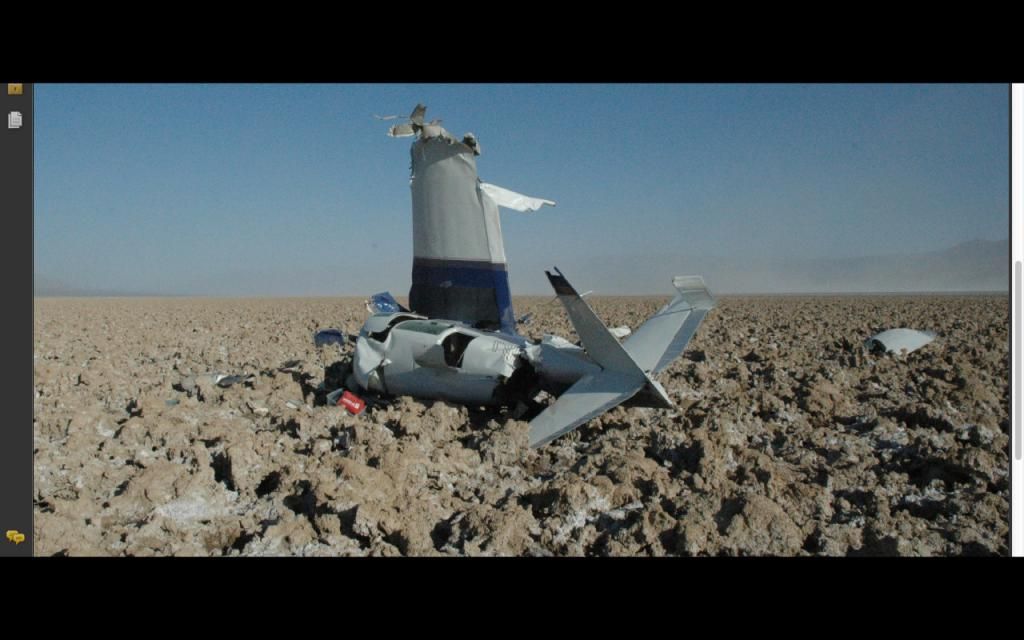

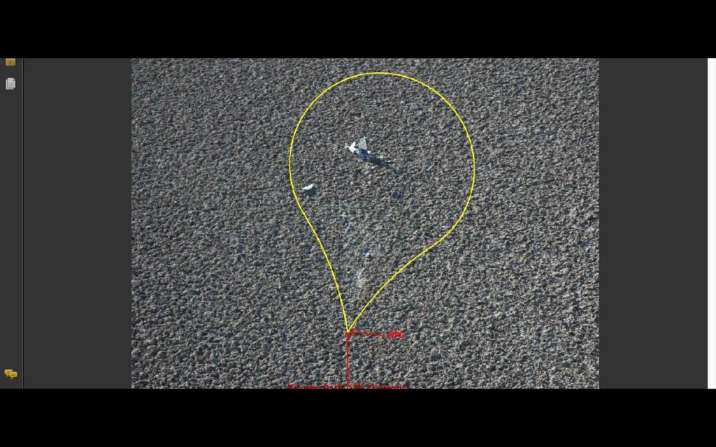

The report was just released of an unfortunate accident that happened last February. A Mooney 201 takes off from Furnace Creek Inn Airport in Death Valley and crashes 6 miles from the airport. The plane just came out of annual and the investigation finds the magneto is loose in its clamp, rotating freely. It appears the pilot tried to perform a wheels up landing on the benign desert floor and the aircraft is destroyed and the pilot perished. Sad story.
The curious thing to me is the rugged desert floor looks like no plane, even bush-wheeled could land here without a major event. And curious because friends of mine (and many of you) have flown over this area and have remarked that landing possibilities appear endless. This must look benign until your on the deck, though the Mooney didn't have a choice. What say you Death Valley visitors? Is it all this treacherous? Just curious, don't want to find out the hard way.

Damn he hit hard. Report states, "nose down, left wing low" initial impact. I'm betting he stalled it.
Re: Death Valley: Curious About Crash Site
I've walked on that desert floor and it is anything but benign. That is salt and mud and is hard as rock and sharp as razor blades. :shock:

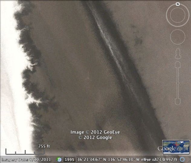

I'd echo what Glidergeek and low rider said, when the lakes dry up in the valley center, the ground can be as harsh as lava.
The wreckage was removed during the investigation. There is just a trace of a scar visible on Google Earth, the light colored upside down Y in the center:

Yeah I guess from this other photo it looks like you'd be landing on a lava field that used to be a lake. Scary stuff.
