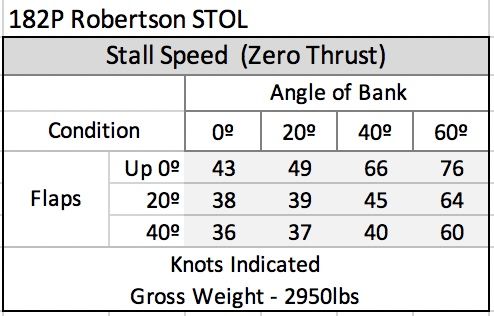

Robertson STOL Stall speed data:
The factory POH 40º flap Stall speed is 50 kts. verses the Robertson 36 kts. pretty amazing.
Question: Considering Vso * 1.3 for ideal descent speed, means Robertson 46 kts verses POH 65 kts. Is this line of thinking correct?

norticdave,
Going back to the headsup AOA and outside site/sound/feel experience, these can get you down slowly and softly on the numbers. Apparent rate of closure speed up prevention (slow down on short final) is much more important than approach airspeed way out on final. The 46 is probably a good number on short final, but that can get slower coming into ground effect.
The beauty of the headsup AOA, and I like Batson's and motoadve's audio, is that we will have some help getting slow where we need slow: at the numbers. And, as motoadve pointed out, help with zoom reserve on takeoff and with energy management turns. OK, level turns as well.
I hate the chart you put up, not because it warns of load factor, but because it makes no mention of allowing the nose to go down as the airplane was designed to do in turns (energy management turns.)
You are looking at good stuff to help you with backcountry type flying. Just remember it is more about pilot techniques than about the airplane. If it were all about the airplane, we could just get a helicopter.
