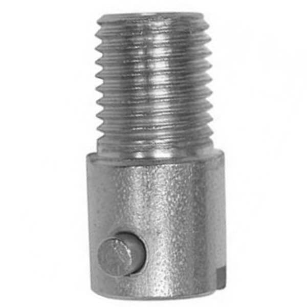

You may want to consider a different probe type. We manufacture a quick release (spring loaded) version of our CHT probes (P-101). If you'd like to try one out, I'm happy to send the adapter (see pic) to you in the mail at no charge. This is the piece that threads into the cylinder well. If it works in the suspect cylinder, the P-101 probes could be a simple alternative.
