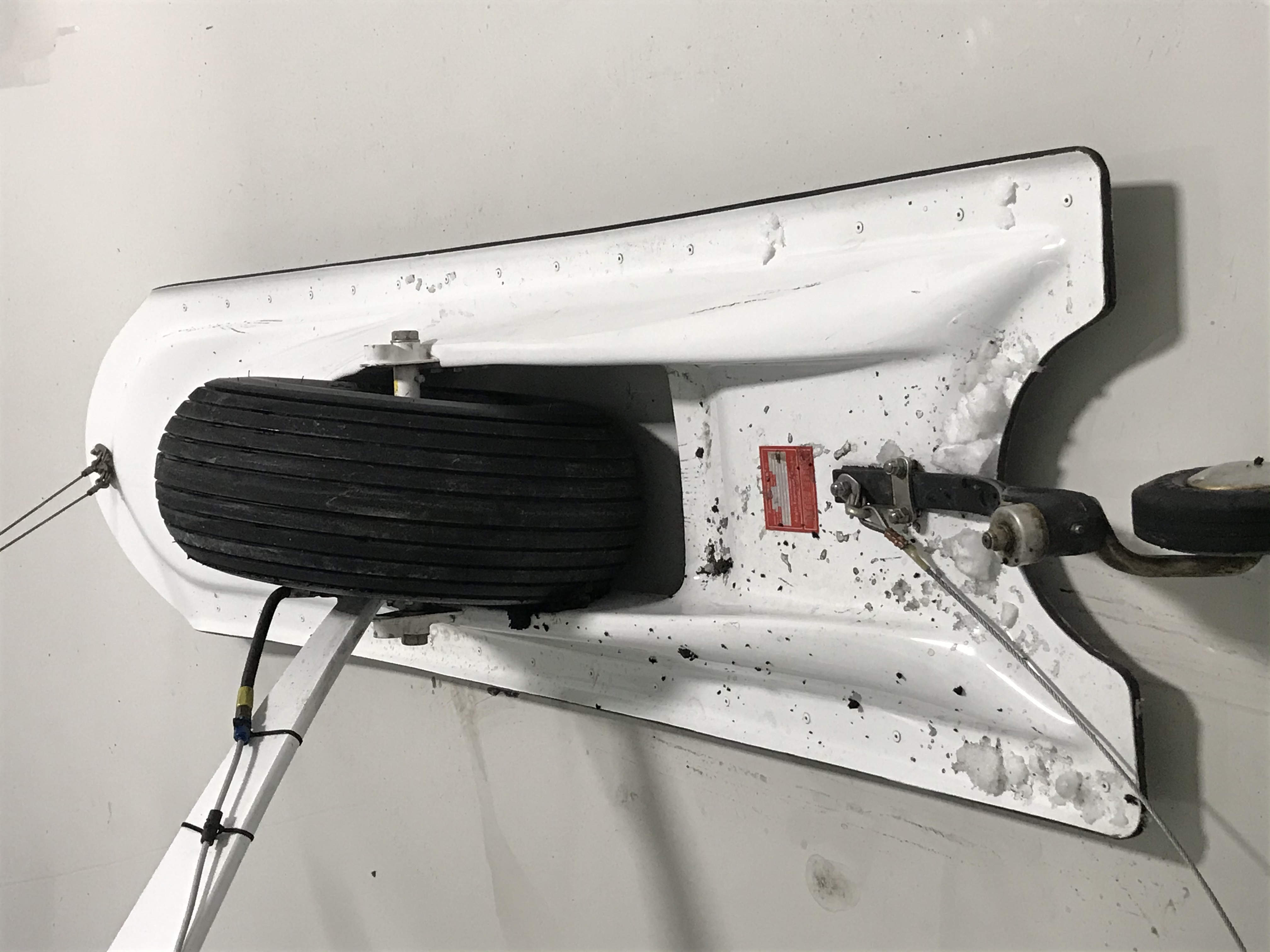

Hi guys,
I haven’t had the chance to lift and take the ski&wheel off to see the real damage. It looks like an axle failure. Skis are airglas 3600 installed recently as per airglas instructions.
I am now reading on the topic and I think the old steel axle might have been the problem. I know I was under a layer of slush last time I flew and had to add lots of power to come up again.
It actually collapsed or moved when I was taxiing out of the hangar on the next flight. It really happened suddenly I was having no brake on the right side with the airplane also going on the right side. So came back to the hangar to notice de damage.
Maybe the axle was already tired or even broken but not visually apparent. Everything seemed fine and in place during preflight check. Thankfully nothing bad happened on my previous landing.
Any thoughts on what you see? I feel titanium axles are going to be the next purchase.. maybe a new tyre too (only 30hours on the other one).
Cheers

You got lucky.

Did you do any sharp turns on the ground? Tight turns snap gear and axles.
Luckily you didn’t lose the aircraft.

Nothing unusual! I think it is linked with the new skis and probably the overflow on the roll that required power to come over.

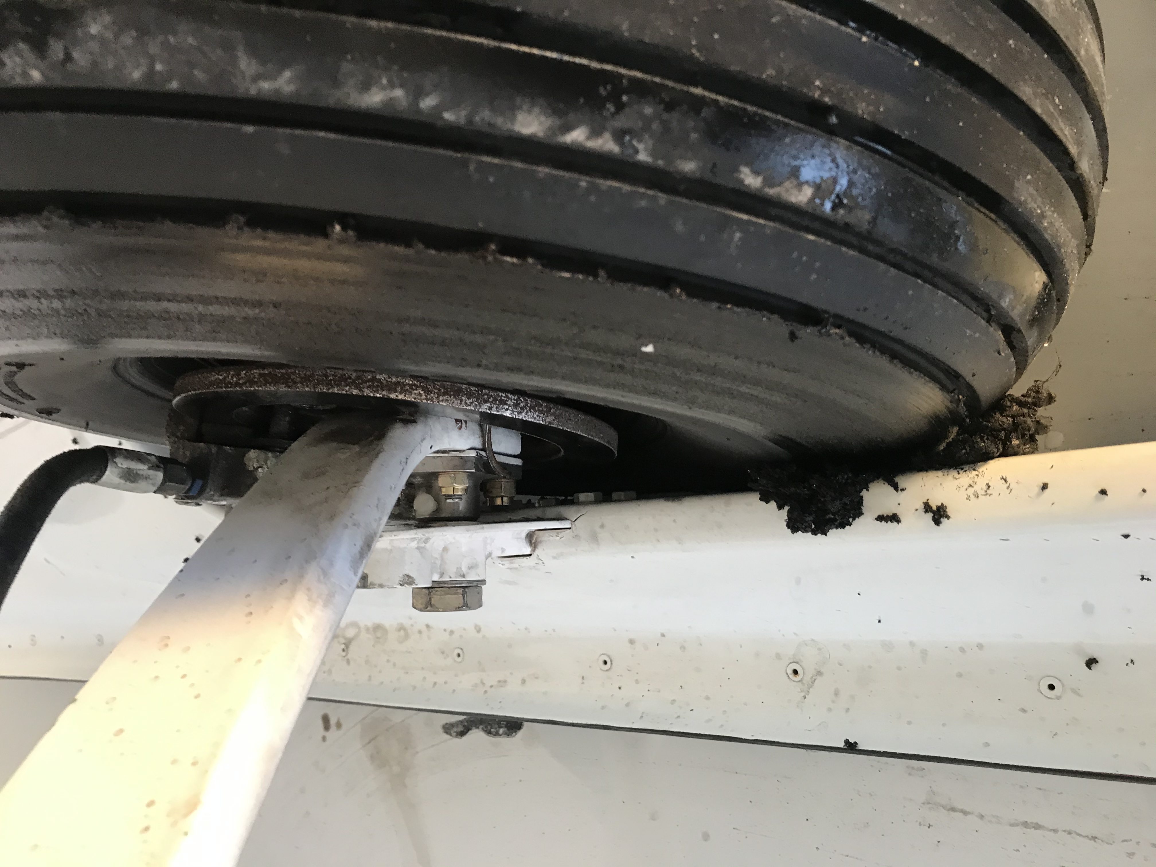

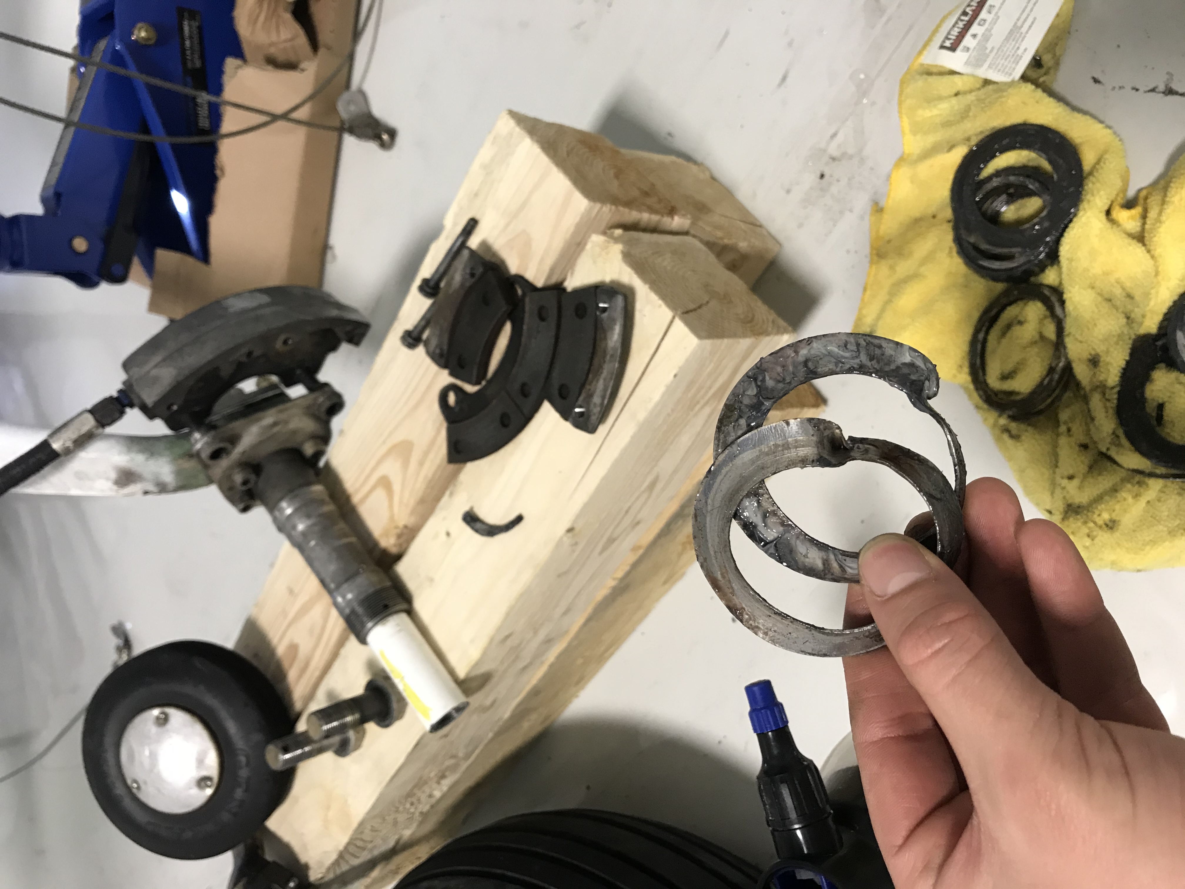

Axel or bearing? The pic almost looks line a collapsed bearing and race.

Looks like the retaining clip is not set in place too. Bearings failure?

I’d bet on the bearing diagnosis. The axle and the ski axle both look straight to me.

That's what I was going to say too....bearings....but it almost looks like the inner wheel half has failed. I had that happen on a 206 once.

Steel axles are pretty tough, not perfect, and have failed, but.... Take things apart and report back. I’d bet bearing or wheel failure as opposed to axle.
Re: Failure
You guys were right.
Steel axle is fine and I think they are going to stay. I’m in the market for two new wheels. Cleveland are the best? 3 or 6 bolts? What’s the difference?
I need a new tyre as well, Skis are fine, brake pads need to be changed on the damaged side.

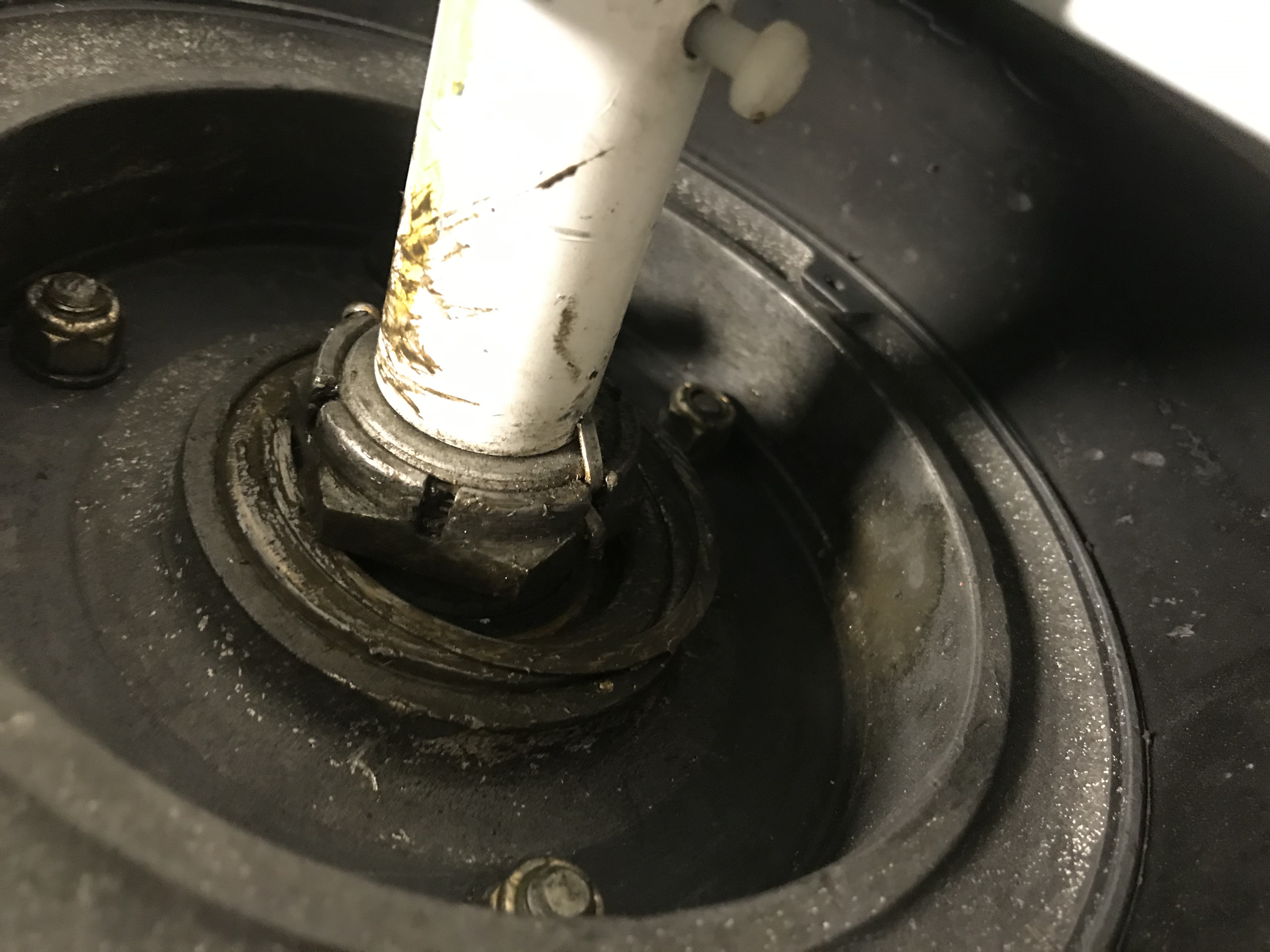

Your number one failure point is the four bolts that hold the axle to the gear leg.
-Replace before further flight.
-Replace every year or every other year depending on service.
There are about ten little details a good A&P can show you about assembling wheels for long term performance, like how to torque wheel through bolts properly or preemptive corrosion proofing.
I’ve seen this failure twice and both times it was improper assembly/installation.
Note the wheel bolt where there is not proper thread engagement in the nut in one foto.

Definitely replace those four axle bolts while you've got things apart. That's the typical failure point, not steel axles, though anything's possible.

The 4 bolts were replaced less than a month ago when we did the install.
Thanks for the advice I’ll be changing them frequently in the future!
