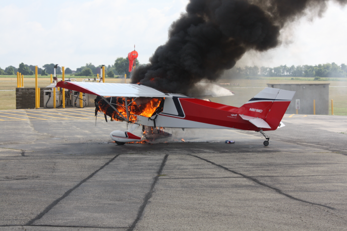

After topping off the tanks, I pushed the plane away from the tanks so that my buddy could fill his Kitfox with fuel.

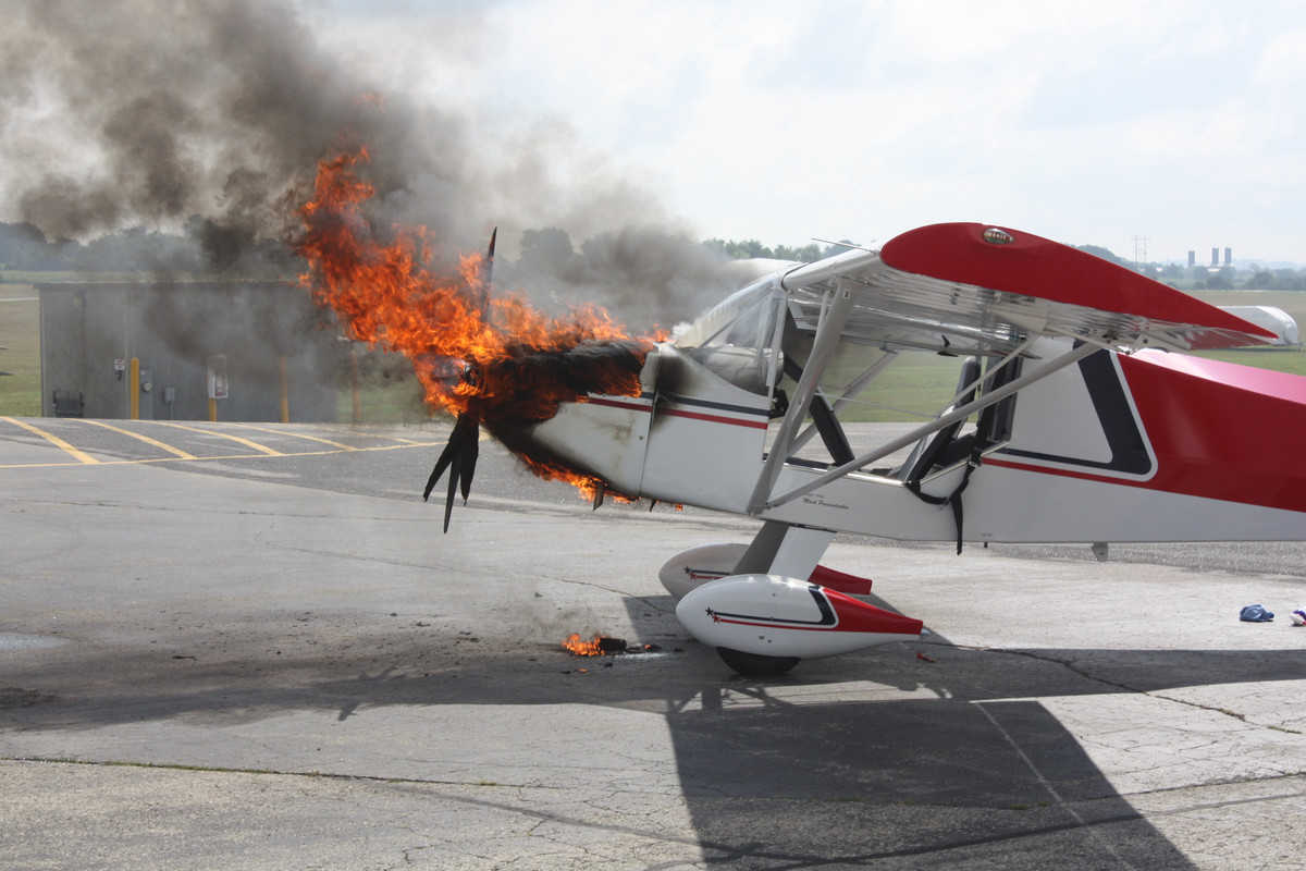

As soon as I turned the key to start the engine, I noticed "steam" coming from the louvers on the top of the cowl. My first thought was that it was odd that the engine would be overheating as the temps had been fine. But it looked just like steam (like when your car overheats).
So I turned the key off, and was in no hurry but took my seat belt off to get out and take a look. As I walked around the left wing and approached the front of the plane, just then the paint started to sizzle on the cowling! I looked into the air intakes and the entire engine compartment was engulfed in flames. I told my dad, "it's on fire-get out!".
The "steam" was actually smoke, but it was so thin that it looked like steam.
Obviously I ran back to the fuel pumps to get the fire extinguisher that all airports are required to have. There were none there!
There was nothing I could do at that point, so me and my dad spent a few minutes getting as much of out baggage out as we could.

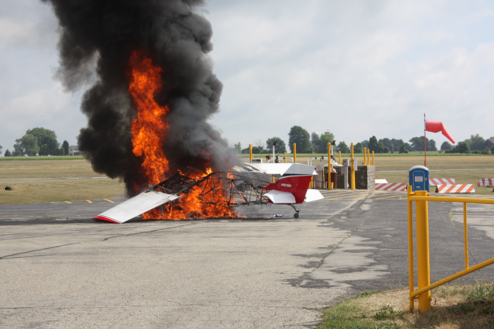

Now the fire was roaring...
The fire progressed right past the firewall and into the cabin.
At this point we thought it would explode when the fire reached the tanks so we got back about 100 feet and stood behind a dumpster!
When the fire did reach the tanks, it didn't explode, but it was a pretty fantastic fireball! Then we just stood back and watching the wings collapse and the fire spread aft.

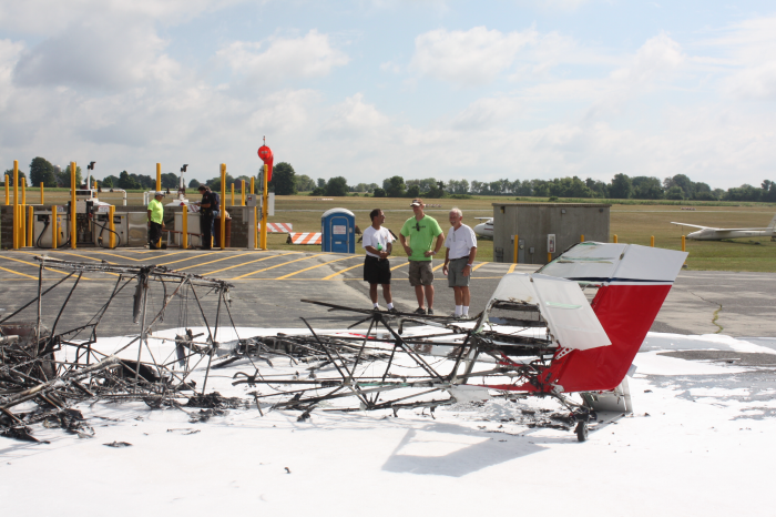

At this point the fire department was already called, but since they had to come from town, it took them a while to get there. By the time they arrived, there was nothing left.
So what happened?
No one knows because there was nothing left to inspect. But it had to be something with the starter as the smoke started as soon as I turned the key. I believe it shorted out and the current then melted the battery cables.
