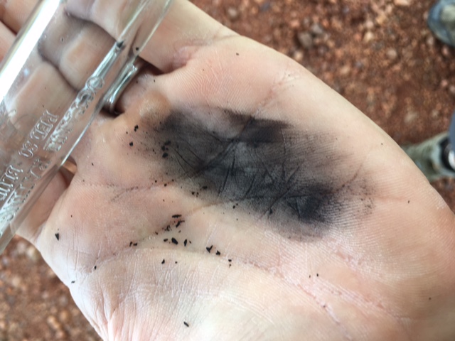

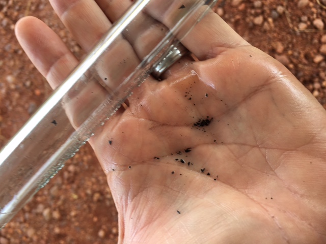

Hi everyone!
Am having small black plastic-looking flakes coming out of my 1957 Cessna 180 tank. I tried flushing the tank out when it was de-fueled during a recent wt/balance check, but am still getting debris coming out. I think this is the tank deteriorating and parts are coming off. Does that sound about right? Pics included below.
We bought replacement tanks and installed them in 2014. But, I think that a previous pilot left the airplane without fuel in hot/dry conditions for several months and think that may be the issue.
Can anyone please recommend a good supplier for new fuel bladders? Thanks in advance!

My bladders were not that color that looks more like rubber, fuel line or gasket type rubber.
