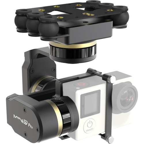

Backcountry Pilot • Gimbal Me This
Gimbal Me This
5 postsPage 1 of 1
Gimbal Me This
Has anyone tried adding a 3-d brushless dc motor gimbal to their aircraft to stabilize video? This one is made with rubber mounting for R/C aircraft - looks like it could be retrofitted to an inspection panel fairly easily. There is also a remote control - so you can control the pan/tilt angle from inside the plane with the gopro streaming to your smartphone inside the plane.
http://www.feiyu-tech.com/products/2/
http://www.bhphotovideo.com/bnh/controller/home?O=&sku=1200060&gclid=Cj0KEQjwwMi7BRDGptbvwOCDj8oBEiQAIALyDNKpaS3i5FARSNMOW_x69J1m01ufY3P9hyf0ZnNOOvwaAjtt8P8HAQ&is=REG&ap=y&m=Y&c3api=1876%2C92051678762%2C&A=details&Q=
Last edited by soyAnarchisto on Wed Jun 29, 2016 9:32 am, edited 1 time in total.
Posts: 1975
Re: Gimbal Me This
I haven't used one of those, but based on other gimbals I've seen/used for gopro type cameras (not on airplanes), that seems like a hell of a deal if it actually works. I like the multiple modes as well.
Posts: 1532
Re: Gimbal Me This
delete - meant to edit my original post to point out the remote control
Last edited by soyAnarchisto on Wed Jun 29, 2016 9:33 am, edited 1 time in total.
Posts: 1975
Re: Gimbal Me This
I like my Feiyu G4. Never had it mounted on the a/c exterior but it does very well hanging out of a car at ~60mph. It would probably do fine at higher speeds but mounting is a little more difficult than a standard GoPro case.
kevbot offline
Posts: 215
Location: Tehachapi
Re: Gimbal Me This
coloradokevbot wrote:I like my Feiyu G4. Never had it mounted on the a/c exterior but it does very well hanging out of a car at ~60mph. It would probably do fine at higher speeds but mounting is a little more difficult than a standard GoPro case.
I have the same one. I'm shocked that you got it up to 60 before it flaked out. My experience is more like 30-40. Anyway, I can say from experience that those motors don't stand a chance in hell at 80 or above!
They are the greatest devices ever at less than 30 though...
rw2 offline
Posts: 1799
Aircraft: Experimental Maule
5 postsPage 1 of 1
