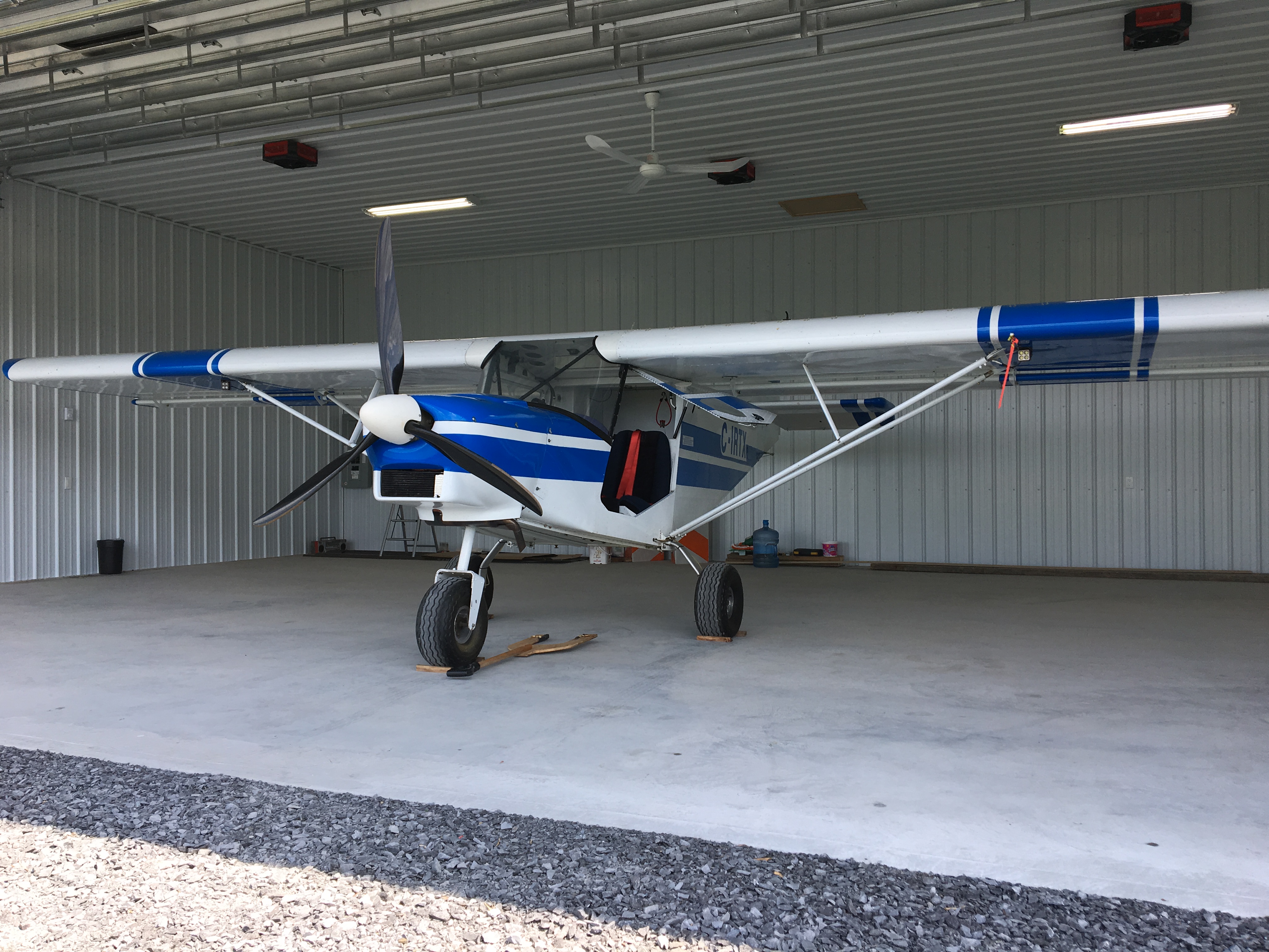

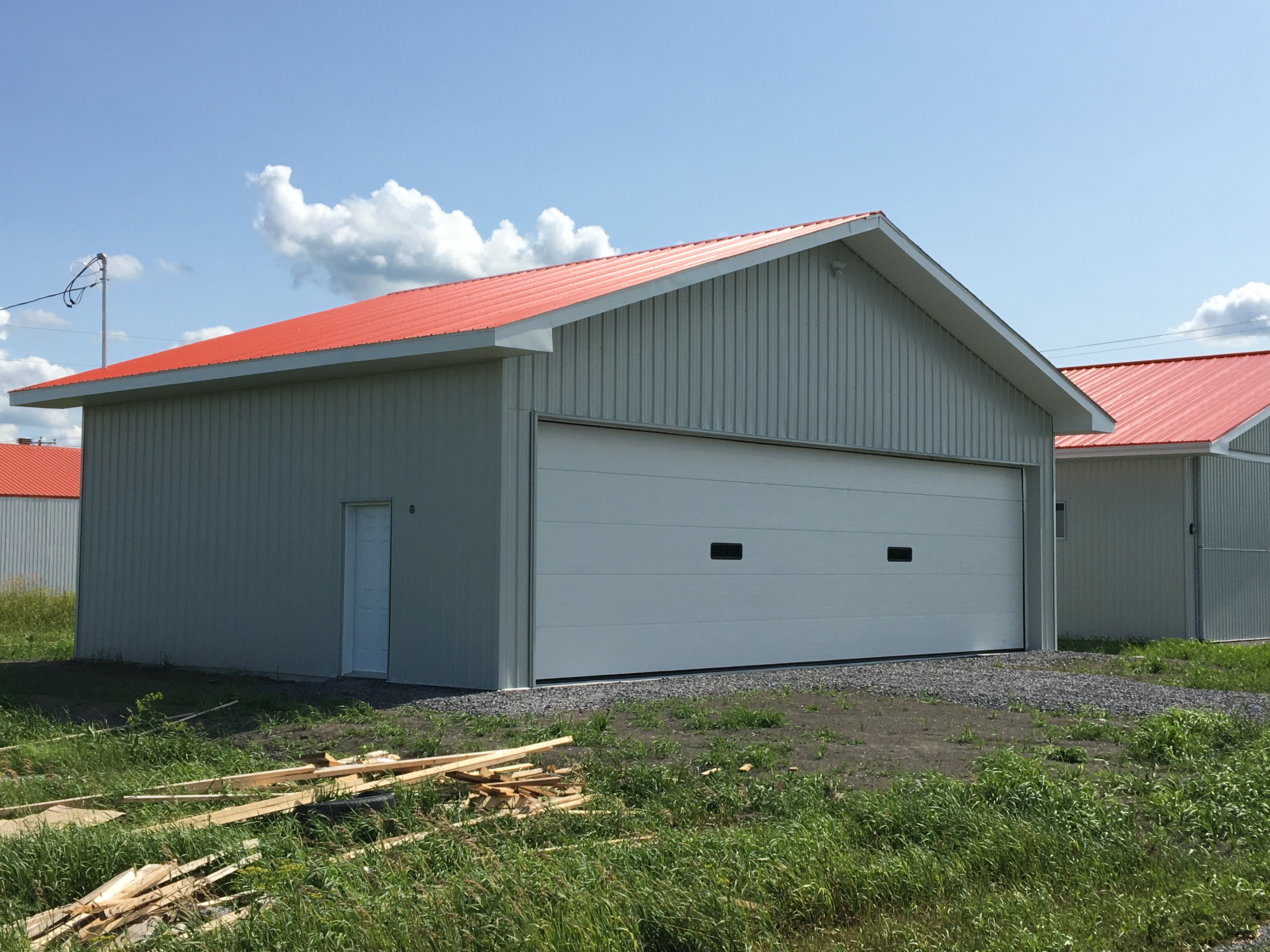

Hi , Just finish my hangar construction 2 days ago (Quebec, canada) . My hangar door is a wayne dalton ts 200 ,38x10. 6300$ usd all include. Very happy.

I think max width is 40’ for the ts 200.

The price (6300 usd) was for door+installation+manual opener.
8300$ canadian dollar = 6300 usd $.
Many of this door have been tested in hard winter conditions, i will give you an up date after the winter !
Opening the door with the manual opener is very easy, may be 20 seconds.
I checked all option before to choose the door, hydraulic door was well over 12000$usd and bifold 11000$usd.
Francois
