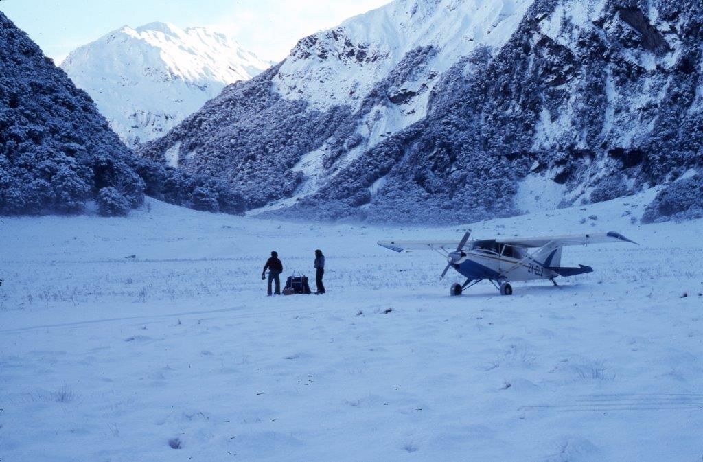

To be clear, I am only thinking about a little snow (hard to see but there was a steady 1" on the airstrip):
Not a lot of snow (in my books, lookes like 3" on the tires), but it doesn't seem to bother some people I know:
Hopefully that helps?
