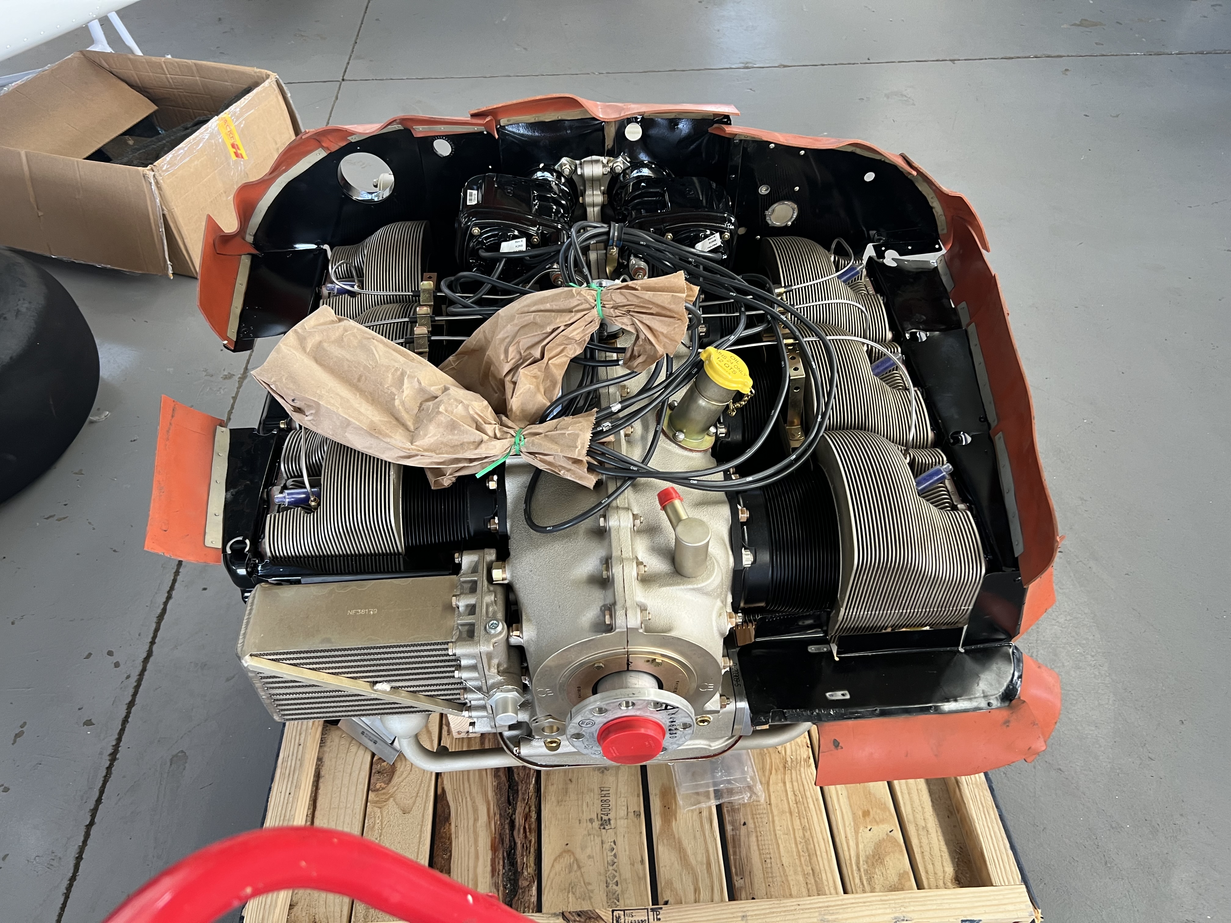

After a lot of back and forth, I chose the Airplains IO-550.
Current status:
• Engine has arrived

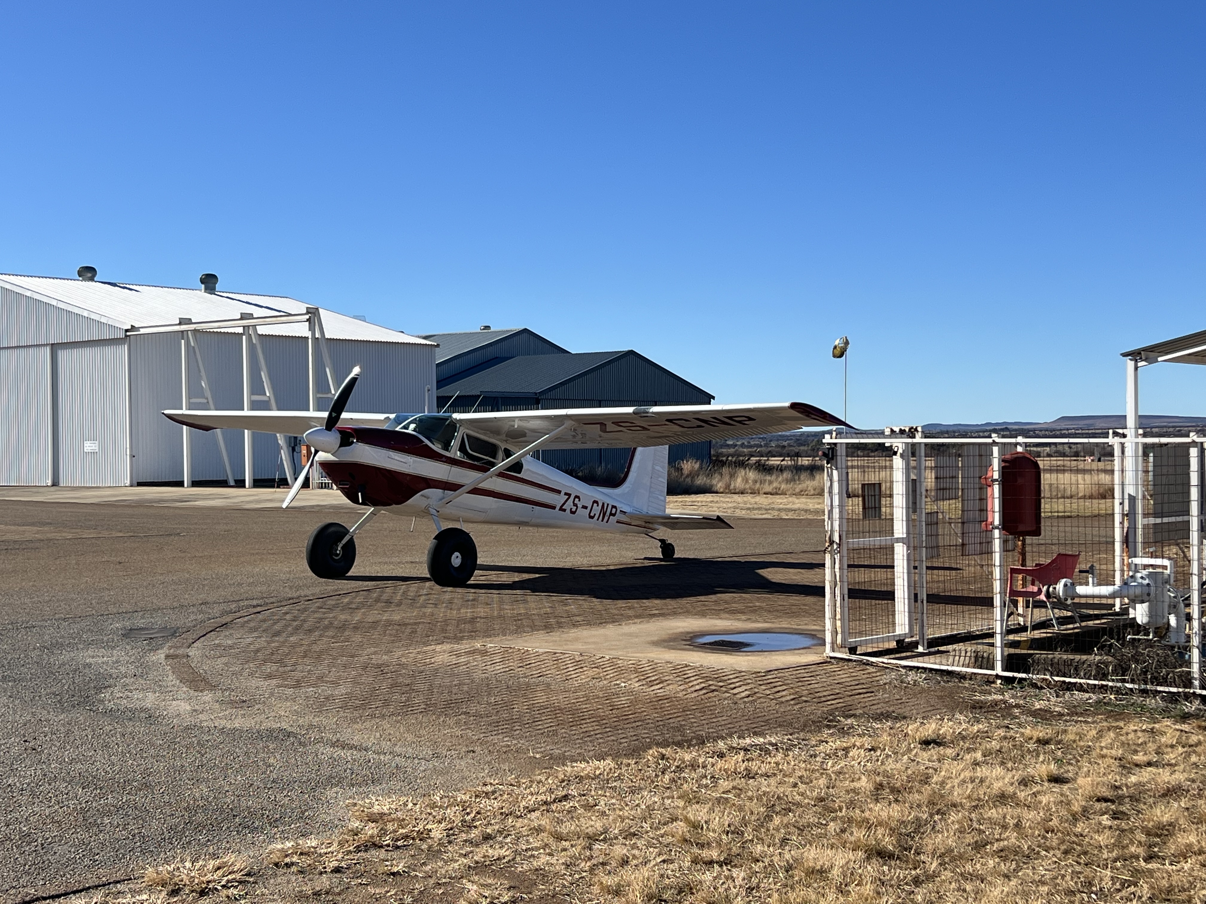

Aircraft details (before conversion):
• 1956 Cessna 180
• O-470K
• Sportsman STOL + Wing-X
• 2-blade MT
Typical cruise :
• 128–130 mph IAS @ 6,000 ft (running 850s)
• 125 mph IAS @ 6,000 ft (running 31s)
• 20inches @ 2300
• 11–12 GPH
Anyone else running a IO-550 on a early 180? Let me know!

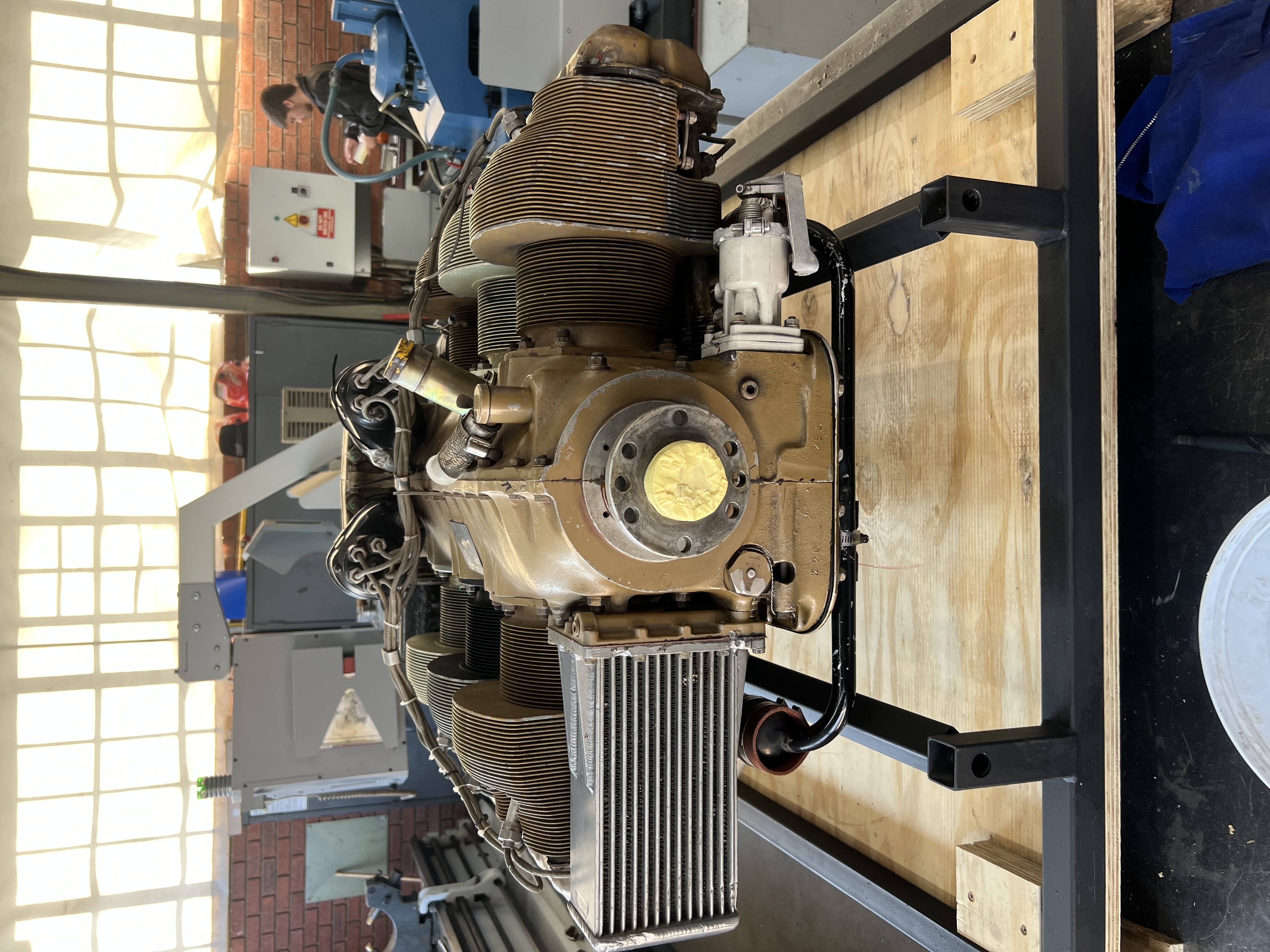

Old engine going back to USA

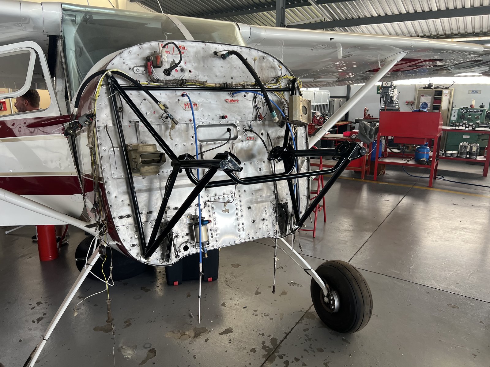

The machine
New Mount
New engine :)

Thanks for showing the firewall with numerous mods from original. Nice looking plane. I have the 265 Pponk and 2B MT and happy enough with that.

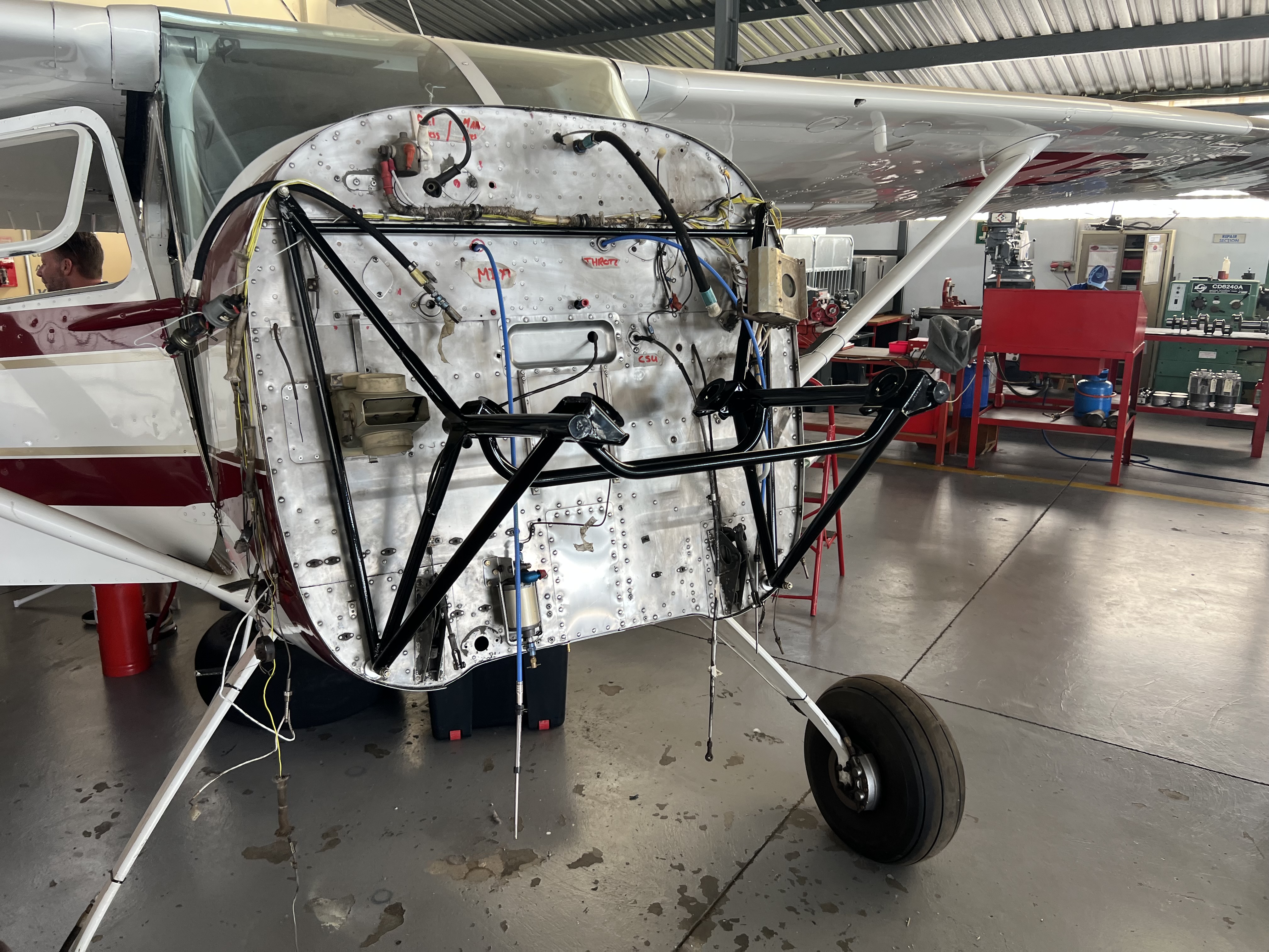

Interesting swap. I see some firewall modifications, were those for the 550 or something earlier? Specifically the gascolator location and the dish recess top center.
Do you have an exchange weight for the engines, or did you weigh the plane? I'm really curious where the CG ended up.

Those mods you see are new. All have to do with the kit.
O-470k equivalent on Continentals website comes in at 425lbs (including accessories) and 550 is coming at 462lbs (including all accessories). My 470-k had a generator, where as the new 550 has a alternator, Not sure what the weight savings here will be. Also saved a small bit with the MT-2 blade.
So i am looking at around 35-40lbs more on the engine only. Then the kit will also be adding some.
She is slightly on the heavy side as 180s go, coming in at +-1750lbs before i started will all this. But she can go to 2950lbs with the wing-x at least.
