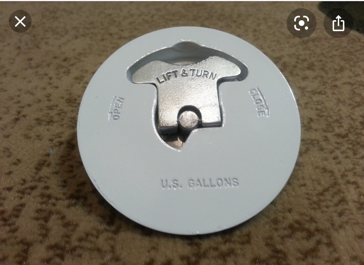

They look like this one.

The cap in that photo looks like a metal cap and it is NOT a killer cap. That cap has two o-rings that are easy to replace. There is a whole thread on BT about improving the o-ring material, as a matter of fact, as Beech guys use the same cap.

The thing is that the one in the pic I posted don't have the backup vent feature.
Maybe they should be called killer killer cap then :o
So, can it be converted to just killer cap ?

Well, thanks for the picture slow18. I see I have the red plastic "killer caps" on my recently acquired 180K wet wing. The o-ring on the perimeter must be good since I really have to dig to get them off so must be the o-ring where the flip twist deal goes through the center. Have been thinking if I leave it outside, I will either tape plastic over the area or get a toilet bowl plunger and rig a strap to hold it in place to seal water out.
