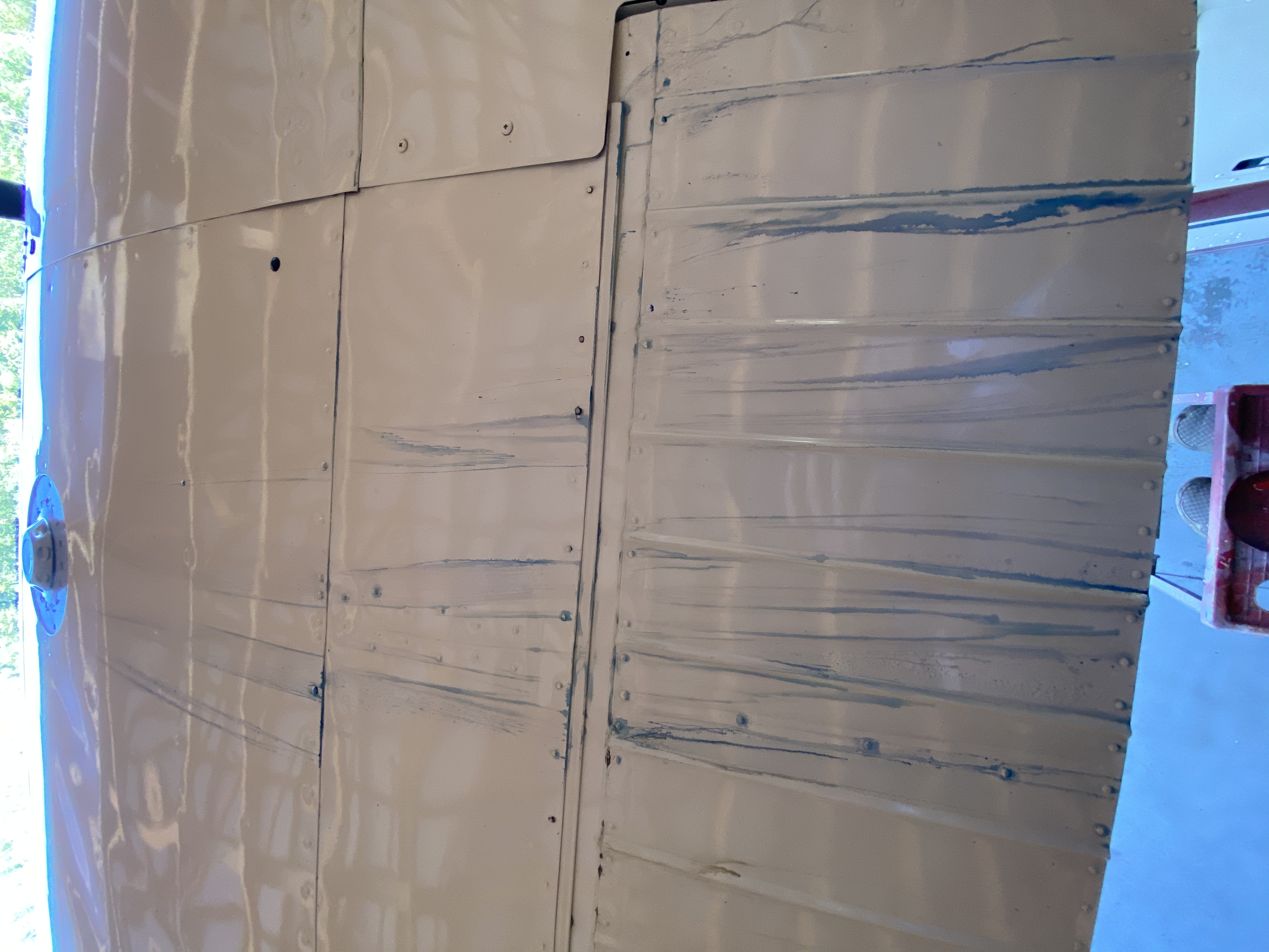

Funny thing, My rh cap started leaking the last fuel flights, blue streak down the wing. My caps were installed in 2008 - No issues until now. There was definite contact evidence on the chain retainer punch tab from the cap. I got rid of the chain and flattened the retainer, also installed new U-shaped cap seals. No more issues. Monarch recommends changing the seals every 5 years. My opinion, once the U-shaped o-ring gets older and looses its full size, the cap starts contacting the retainer preventing full o-ring compression. I bet the new seals would have been enough, but the chains were a pain anyway. Once the retainer is flattened, I bet you could use a standard o-ring as long as the umbrella didn't bottom out first.

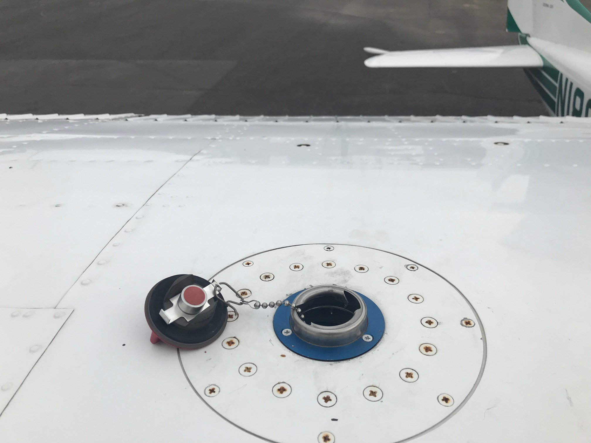

I installed Atlee Dodge's cap adapters in my 205, and have been very happy with them. They fit into the existing cap mounting hole with a greased O-ring rather than replace the plate, and use Cessna fuel caps. It took about 15 minutes to install everything and do the paperwork. No fuel leaks, and trace water (two teaspoons) combined across all tanks after two days of downpour. About $600 plus caps.

jcadwell wrote:I installed Atlee Dodge's cap adapters in my 205, and have been very happy with them. They fit into the existing cap mounting hole with a greased O-ring rather than replace the plate, and use Cessna fuel caps. It took about 15 minutes to install everything and do the paperwork. No fuel leaks, and trace water (two teaspoons) combined across all tanks after two days of downpour. About $600 plus caps.
Thanks for that picture. I've been thinking about putting these in my 206 but wasn't sure how they worked. I put new Gallager Orings on my stock caps so I'll see how they keep the water out. Next step will be these adapters.
