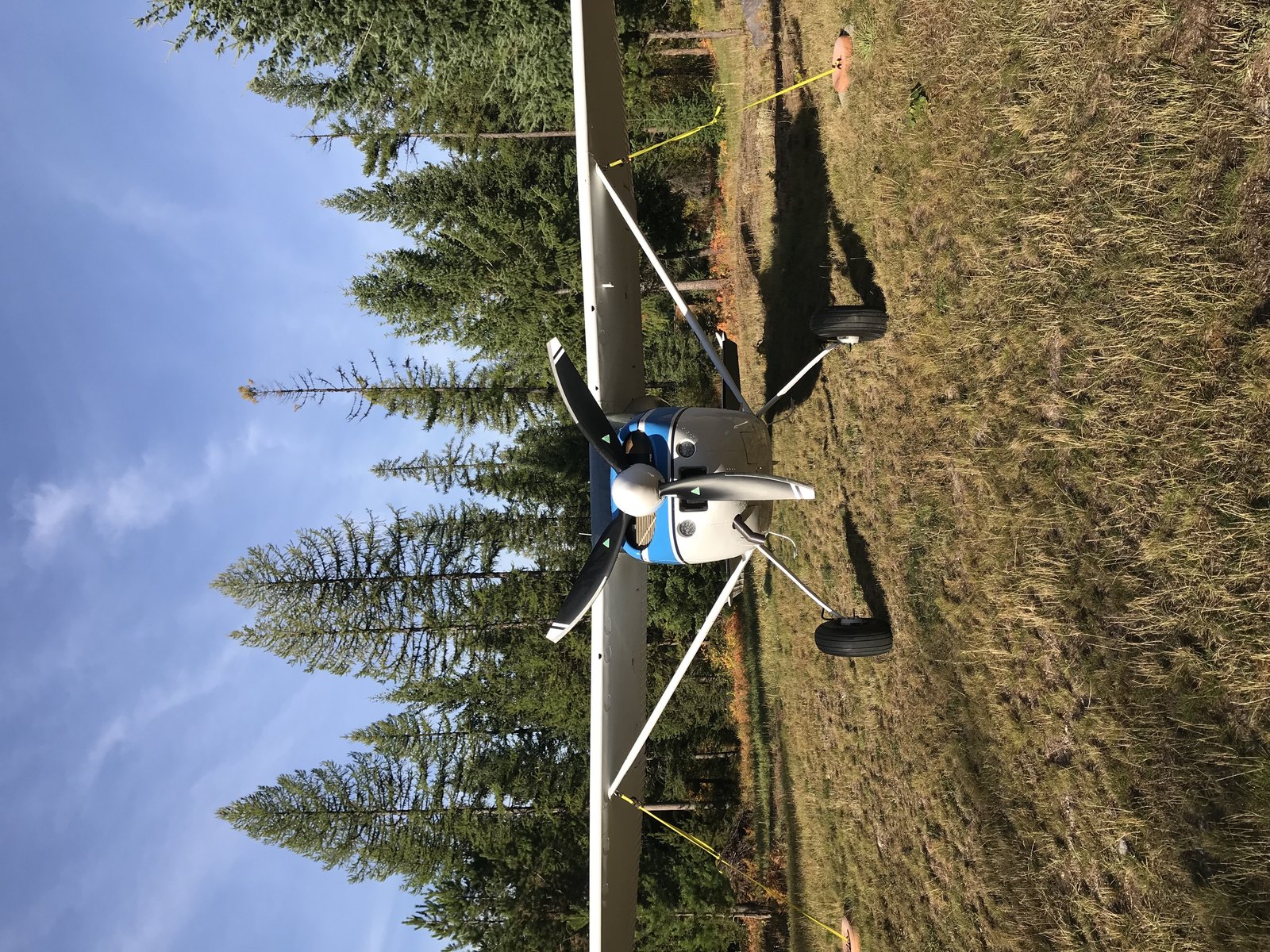

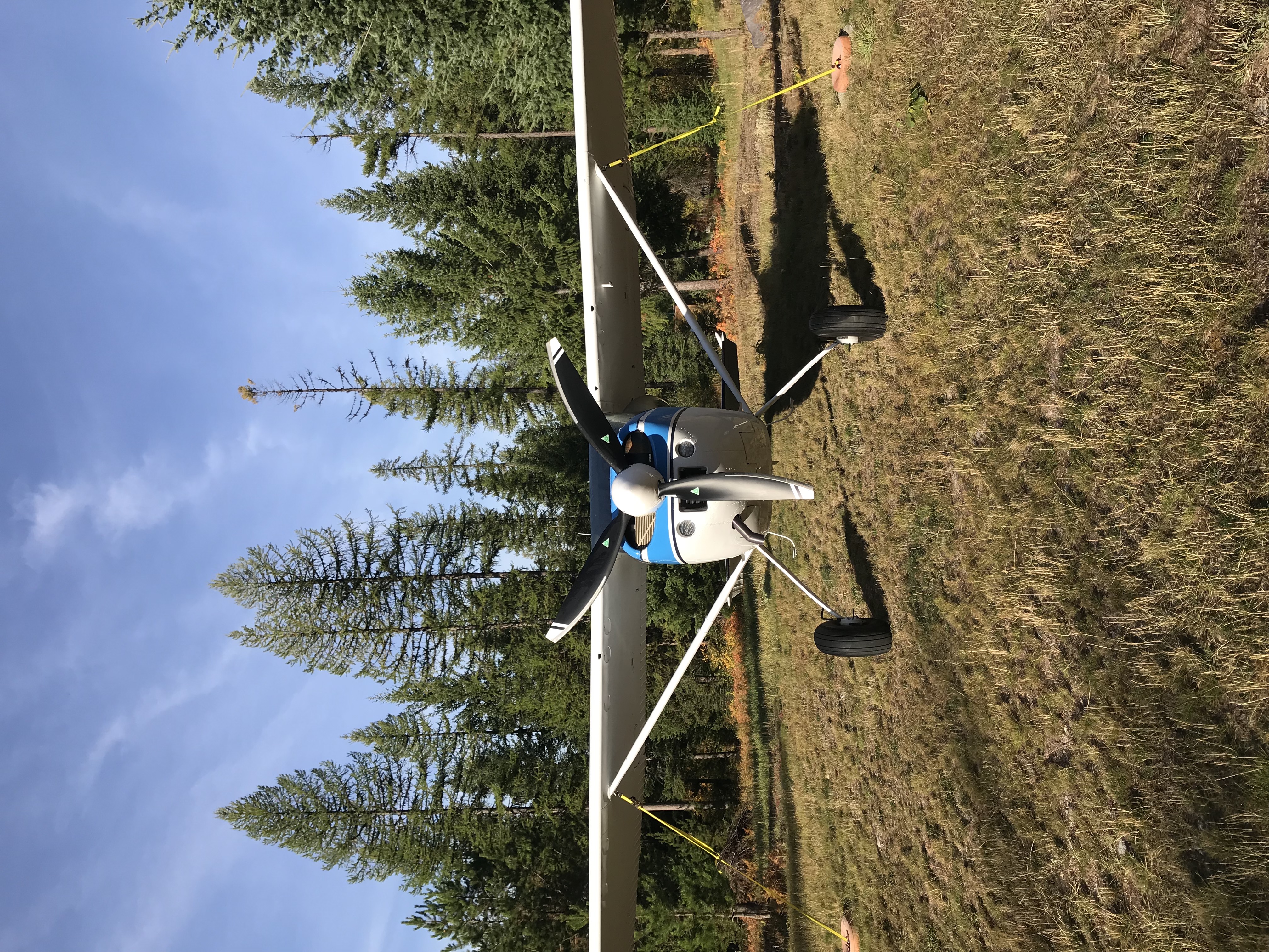

Finally got it back. 10 weeks and $9,000 later, it looks great with the shiny new nickel leading edges. Finishing annual, so it'll be another day or so before I get to try it out.

Pierre thanks for posting - great paint scheme!
