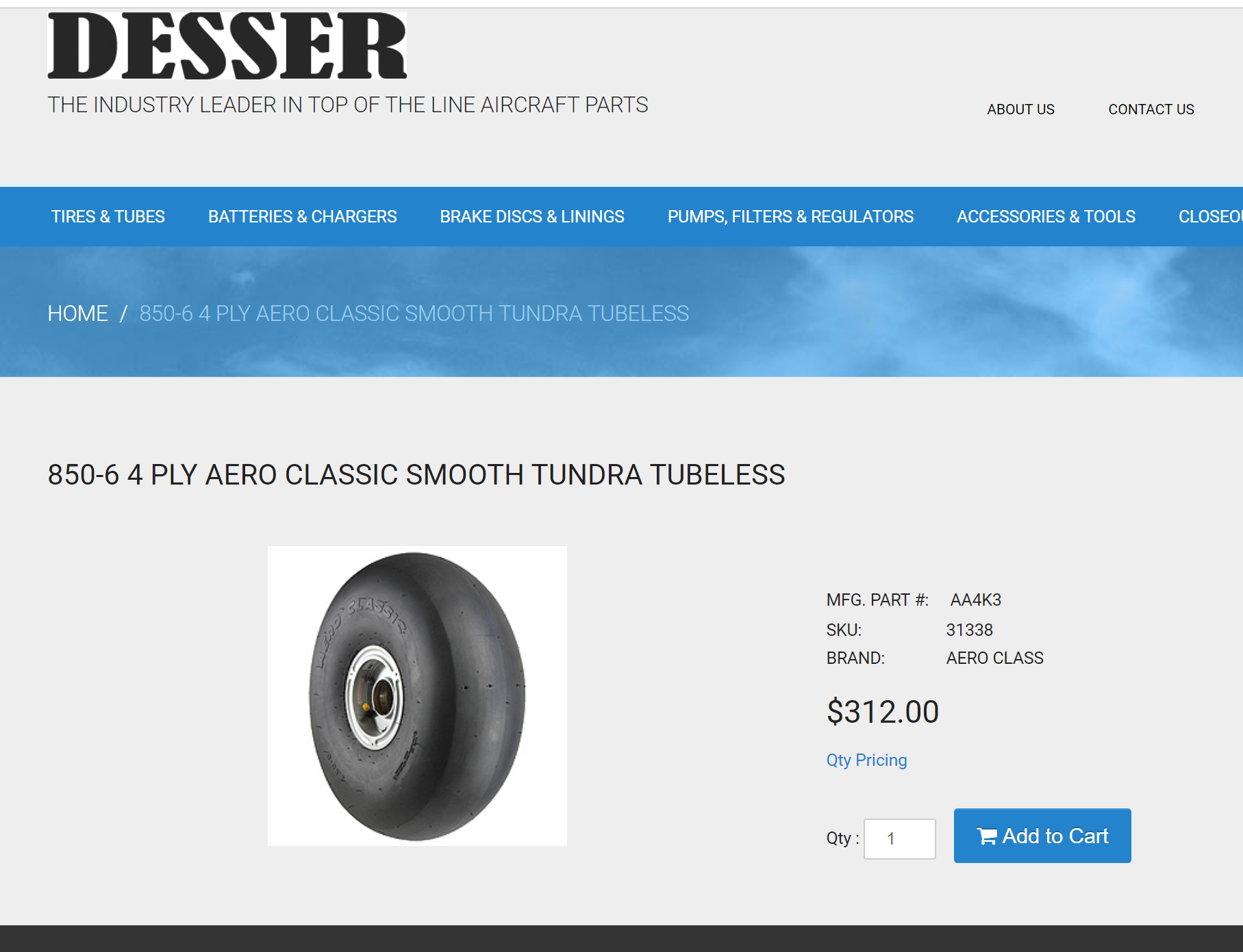

850-6 4 PLY AERO CLASSIC SMOOTH TUNDRA TUBELESS appears to be SKU 31338.
Recommend using Desser.com's search function using keyword "tundra".
Good luck finding an appropriate 6-inch tubeless Cleveland wheel...

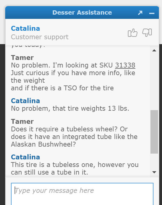

I think this is literally the same tire just approved for tubeless use? The "Tech Support" wasn't much help.
