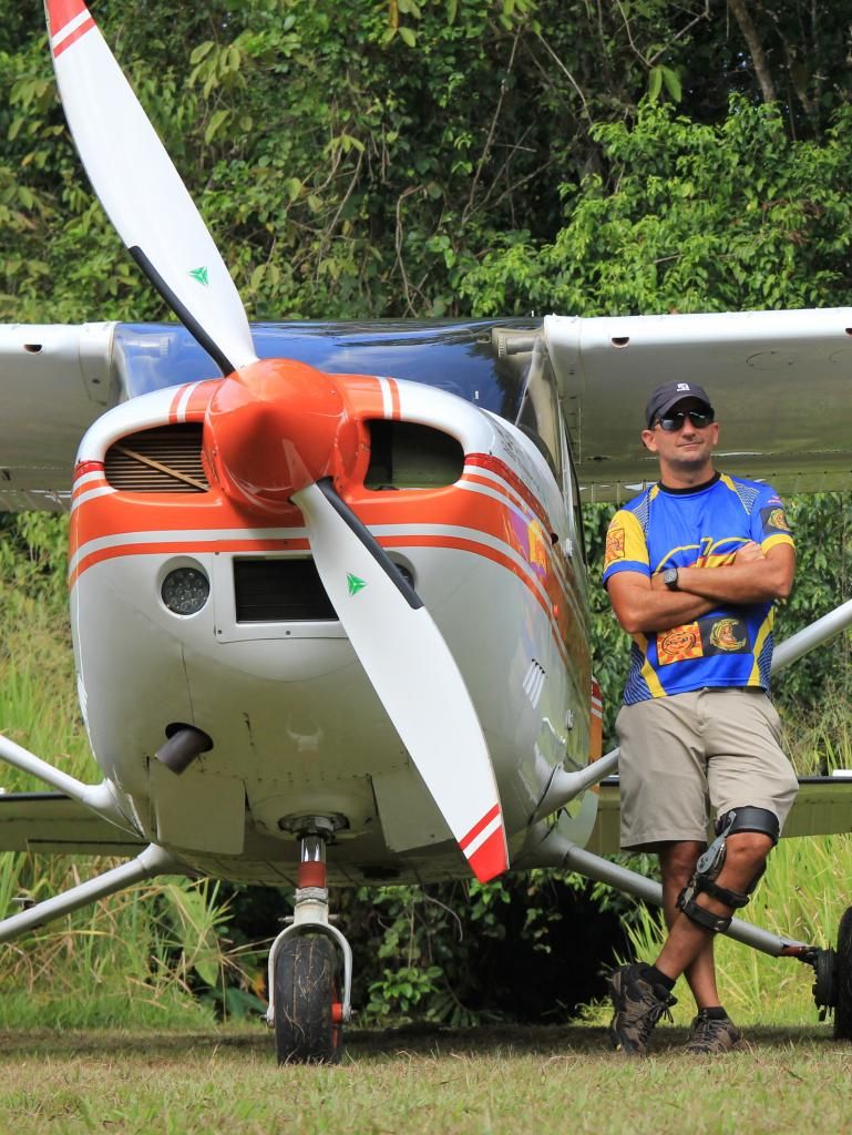

Radiator hose, my mechanic put it on when he serviced the strut, so no need for clamps.
Wont fly without it :)
