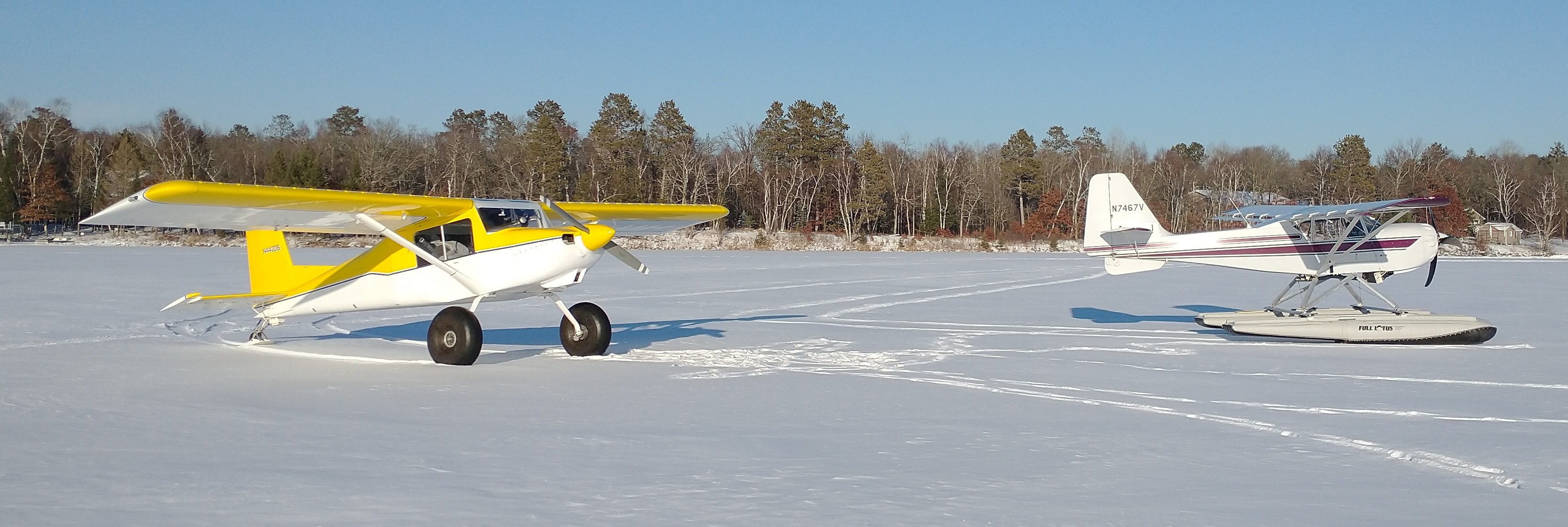

Enjoying the thread on the engine choices. The good old O-320/360 types are hard to improve on. I agree that the Rotax has gained quite a following and is the way of future powerplants are heading. The downside for me is the complexity of these newer engine systems. Living in the woods and no Rotax authorized places anywhere within a couple hundred miles, I will stick with the Lyc/clones for the time being. They're basic engines that most anyone can work on.
My Rebel has an O-320 and the Kitfox belongs to a friend. It has the Yamaha RX-1 motor. It performs nicely and sure seems smooth running. This is a picture from a couple of days ago when we met up on a local lake.
I have been plowing my strip so I can fly on Bushwheels. Time for me to go on skis.
Snow depths south of me are under 6" while at my place it's much more like a foot+.
