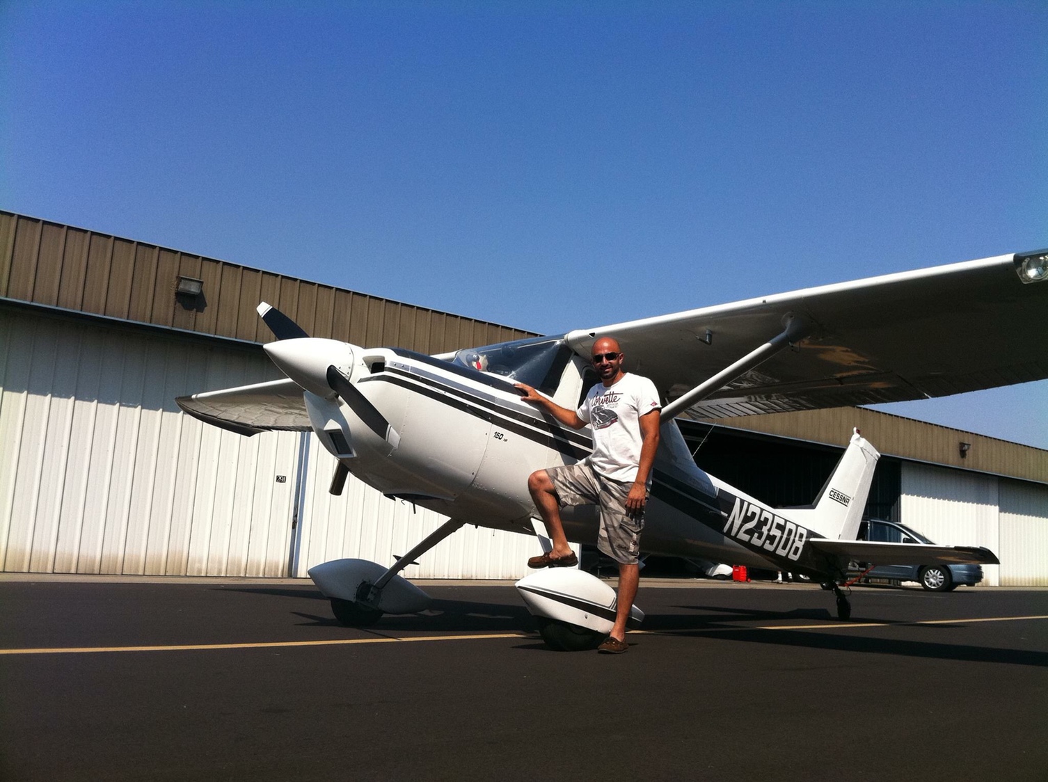

Should look like this...
Mine has the Del Air STC, handling is not great but a challenge is fun, I could probably spend some time on wheel alignment. Makes a 180/85 or 195 feel 'soft' and forgiving on the seal
If you get a swept tail at the right $$, why not, you'll have a heap of fun. 150's are great regardless of the configuration, they always put a smile on my face :D
