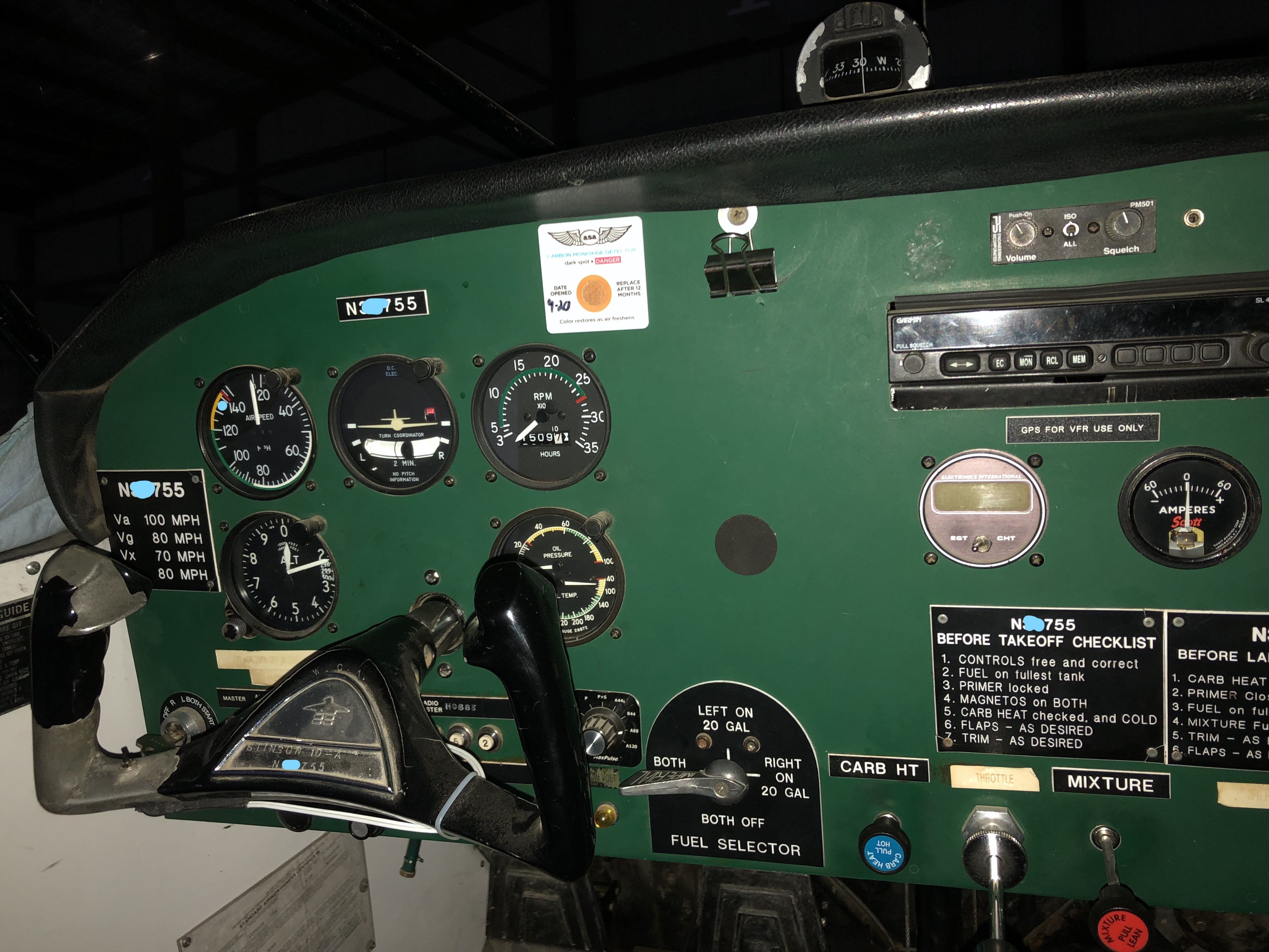

A Stinson 10A I fly for work has a very simple panel. It's strictly a day VFR bushwheels kinda plane. It has a binder clip screwed to the panel. Surprisingly good for holding a paper with notes or more recently I discovered it's perfect for an iphone with foreflight or spotify. It's actually great. The placard "GPS for VFR use only" is either a joke or a remnant of a past life because there is no GPS..
