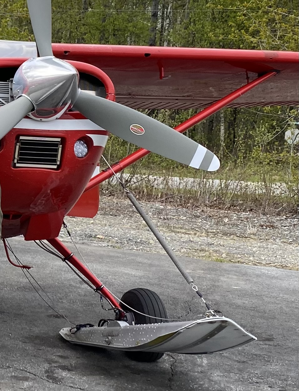

I’m currently going down the rabbit hole of springs on a Cessna.
I was just in Talkeetna last weekend and noticed this 185 being flown part 135 with springs.

Re: The Out-Of-Control Surface: A Loose Ski Mishap
Speculating by the paint, is that a Rust's/K2 bird? If so, Collin at Rust's is the one to talk to ref that configuration. Regardless, obtaining the approval data for the pictured installation would be very helpful.
It is a K2 185. I didn’t get the tail number. K2 is a Rusts company. In any case, it can be done, just need to find the right avenue.
