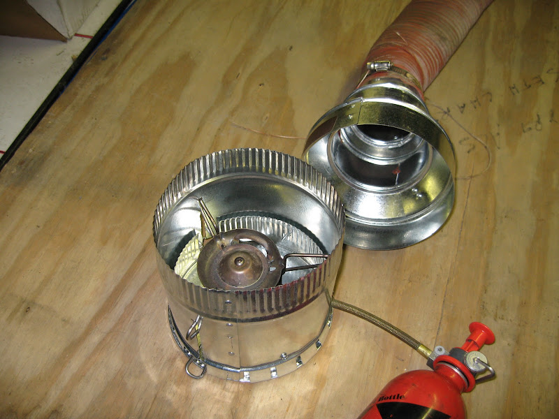

So the MSR Dragonfly is the only stove I've found that will run reliably on 100ll. It's also about as loud as a jet engine, which is a good thing when you're pre-heating, because you know instantly if it has gone out. They do occasionally go out, and it's important to vent the gasses out of the ducting before relighting the stove, lest you get a fireball you didn't plan for.
Once you have the stove, just take it to any hardware store and find a piece of ducting that the stove will fit in, and that a dryer or scat hose will connect to. You'll probably have to modify the ducting a little...air intake holes and maybe a cutaway for the stove controls. It's also good to have something for the stove to sit on other than dry grass, like a thrift store pie tin.
If you're really clever you'll attach something up under your cowling for the duct to attach to so you can position the hot air exactly where you want it. I just jam my dryer hose up there under the oil pan, but I know there's a more elegant way of doing it. In windy conditions, having the ducting anchored inside the cowling will be more than just convenient.
A word to the wise...play with your stove for a bit BEFORE using it to preheat. Stoves are temperamental things with unique personalities, and it's best to get to know your stove while boiling water, not while ducting its' heat into the cowling of your airplane. Some people recommend a spark arrester somewhere in the ducting, and while that's probably not a bad idea, I've never seen the need for one. A properly functioning stove doesn't throw any sparks.
Here's a sort of crude version with rigid ducting, and while it worked fine, flexible ducting seems to work better:
This is what I use now...just a random piece of metal furnace ducting that I slightly modified and attach a dryer hose to.
Or you can spend $900 on a Northern Companion Heater and have a much sexier, but probably no more efficient source of heat... :roll:
