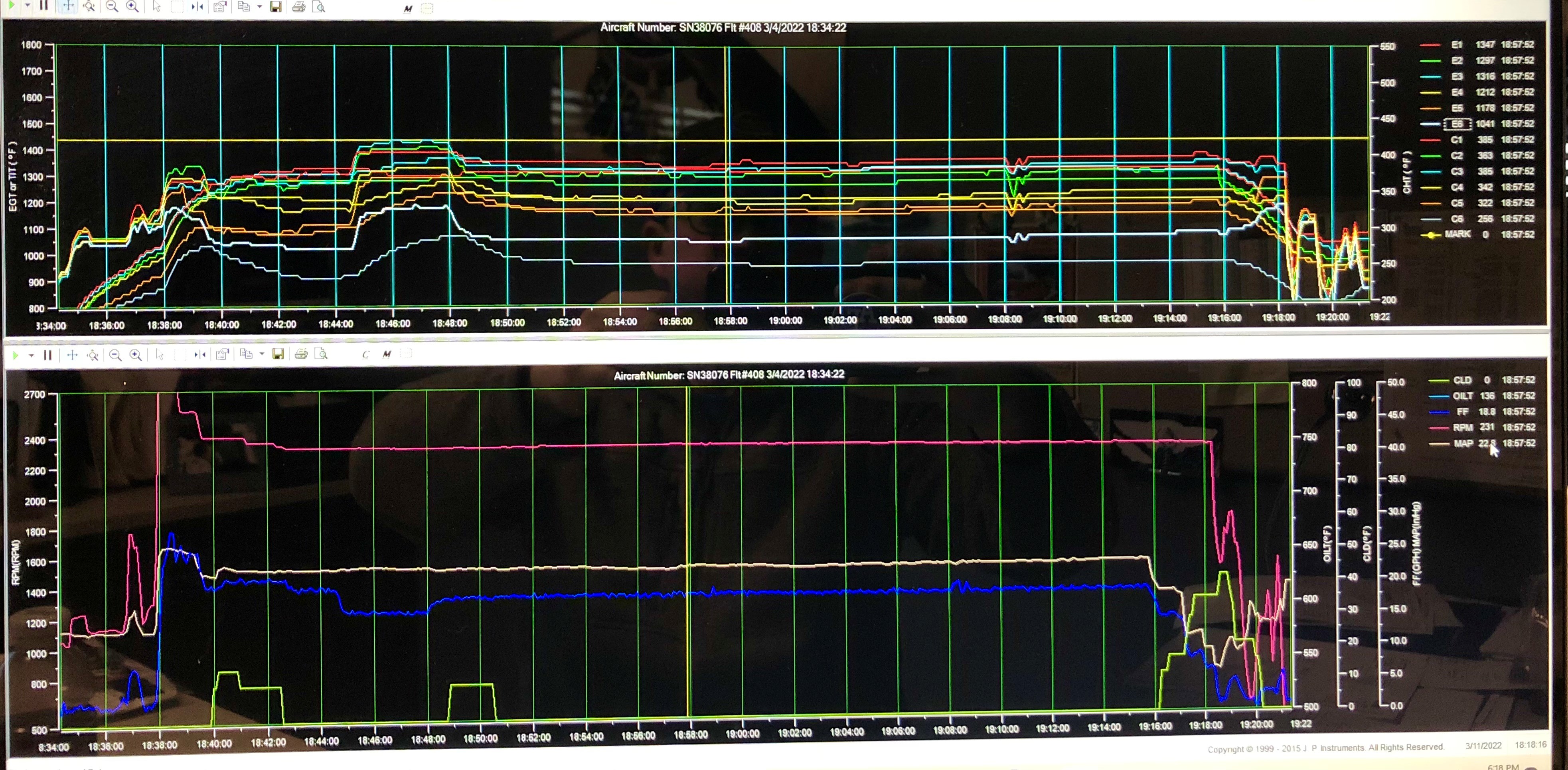

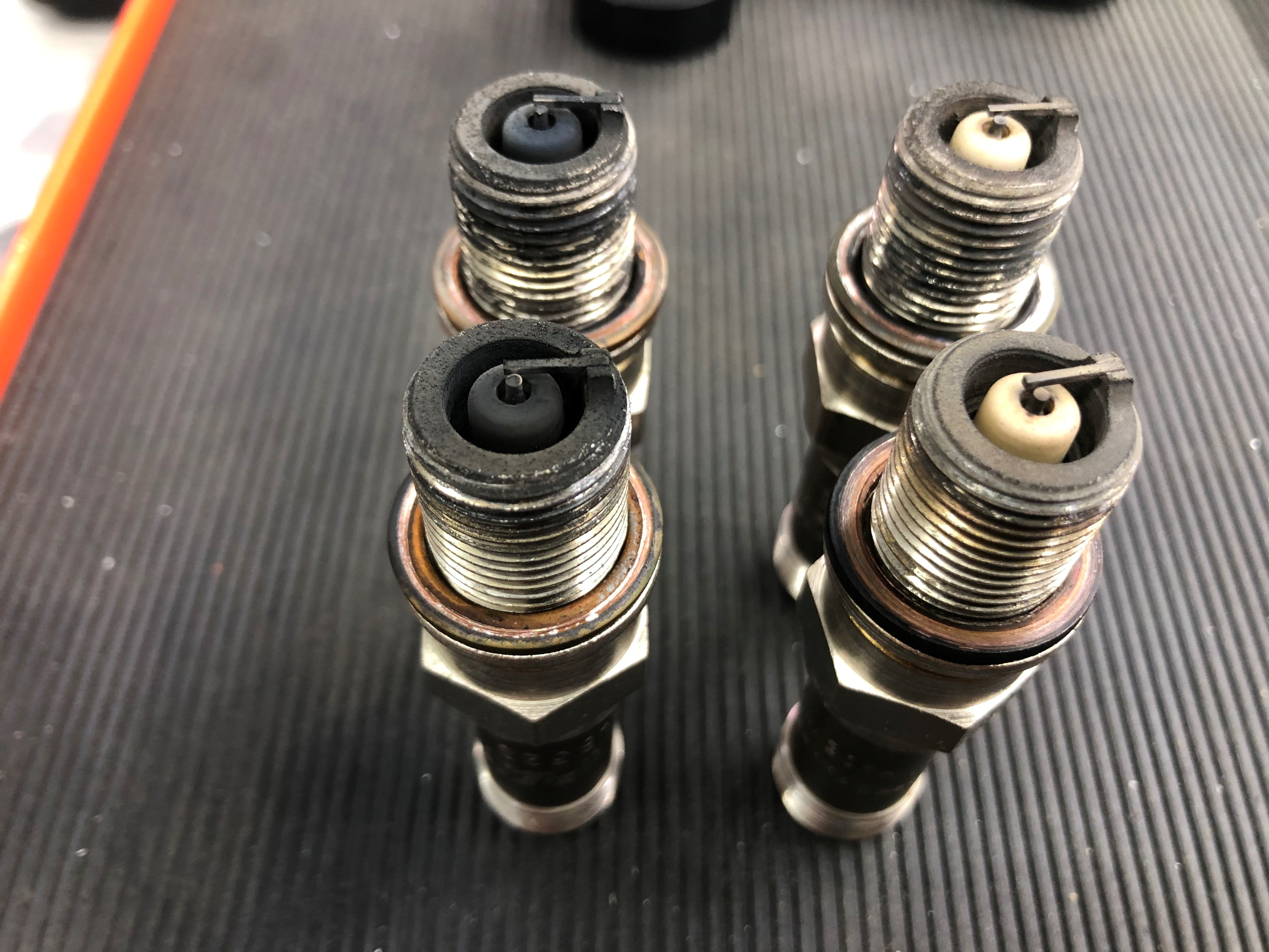

Any ideas on if a small crack in the balance tube on a 470-50 could caused the #6 cylinder to have both plugs to run rich? The CHT on this cylinder averages 150+ degrees low and the EGT's average 300-400 degrees lower than the rest. Both plugs on the #6 cylinder are black and
sooty and the rest of the cylinders look great. The engine is still in break in with only about 15 hours on it. Compression on this cylinder is currently at 76 psi.
Everything had been going great with the break in, only used half a quart until its first oil change at 5 hours, changed it again at 10 hours with no oil burned. Today I had to turn back to the airport slightly after trimming out into a cruise due to the engine started running very rough, seemed to smooth out when adding power but became rough again when power was reduced to 23 sq. Carb heat had no affect, switching mags made no difference. The only issue I found so far is a small crack in the weld on the balance tube that is leaking.
