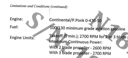

From the STC:

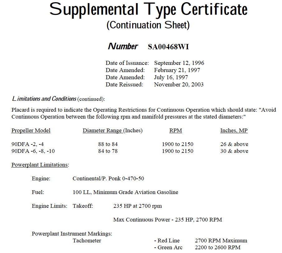

I looked up the RPM limits specifically in my STC and learned that it does not quite match my placard. However, this is specific to my Mac 401 prop.
Ross
P-Ponk Prop RPM Limits.png (129.55 KiB) Viewed 972 times
