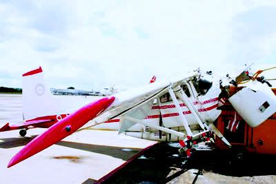

It can happen - two died in this C185 in Zambia a week or so ago...

You know who owns that 185? I wouldn't mind buying that Sorensen belly tank, boom assembly and whatever is left of the crunched pump. I know there are a few of those over in Africa, not so many here in the states. Lemme know.
I would think it better to jam them both on and flip her over before crunching in like that. Should've been in an Ag Truck, hopper woulda taken the hit not the soft bodies. I wonder if the engine is physically IN the front seats, looks like it could be.

lowflyin'G3 wrote...You know who owns that 185? I wouldn't mind buying that Sorensen belly tank, boom assembly and whatever is left of the crunched pump
yeah...human nature being what it is I think many 180/185 drivers were eying it up for spares...those tail feathers look in good shape too...
Don't have any contacts down there but know 'a friend of a friend' - will make discrete enquiries about the tank for you...
